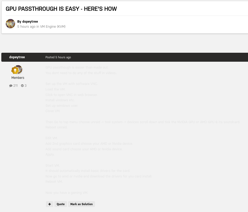

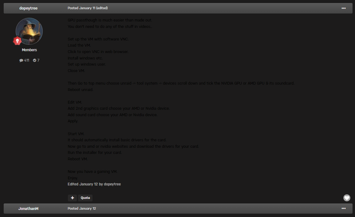

GPU Passthrough is EASY - Here's how

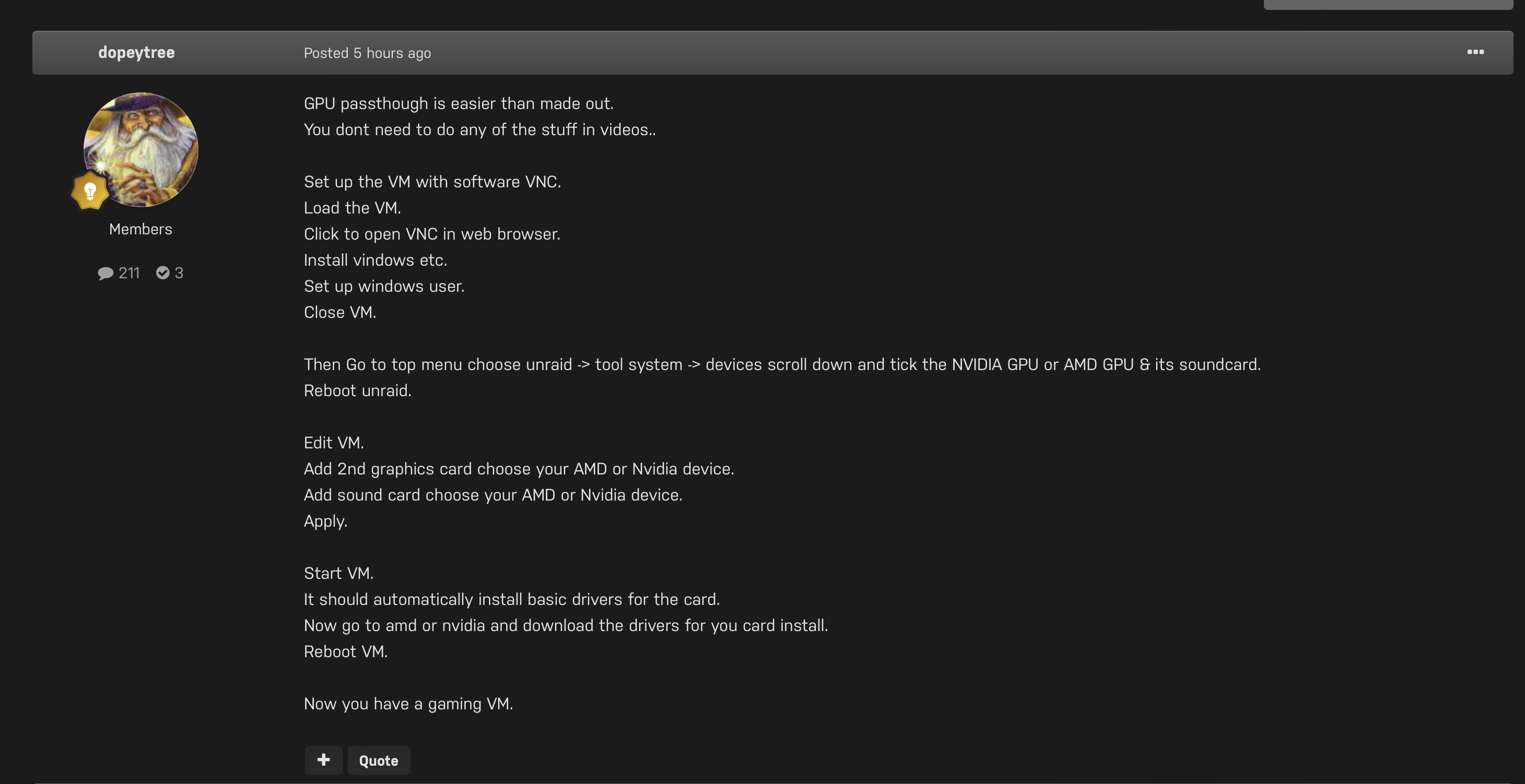

GPU passthough is much easier than made out.
You don't need to do any of the stuff in videos..
Set up the VM with software VNC.
Load the VM.
Click to open VNC in web browser.
Install windows etc.
Set up windows user.
Close VM.
Then Go to top menu choose unraid -> tool system -> devices scroll down and tick the NVIDIA GPU or AMD GPU & its soundcard.
Reboot unraid.

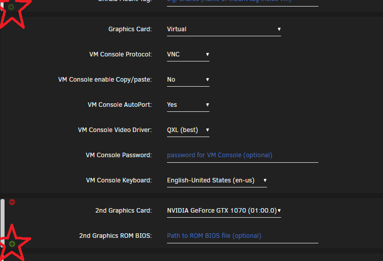

Edit VM.
Add 2nd graphics card choose your AMD or Nvidia device.
Add sound card choose your AMD or Nvidia device.
Apply.
Start VM.
It should automatically install basic drivers for the card.
Now go to amd or nvidia websites and download the drivers for your card.
Run the installer for your card.
Reboot VM.
Now you have a gaming VM.
Enjoy.
12 hours ago, RaidUnnewb said:

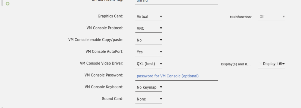

Jesus, this took me a couple hours to troubleshoot....
I couldn't figure out what you were talking about by adding a second video card.
Theres a tiny easily missed plus button to add more cards in the VM settings:
Edited by dopeytree
Added screenshot

Care to share for the rest of the class? Your font choice is not readable on the light theme.
Apologies for that.
I didn't know one could select a font or colour.
I'm writing in the dark theme
This should be auto changing with the users theme selection - I don't have access to that code.

Hello. This is my first time setting up GPU passthrough. You said "Add 2nd graphics card". Does that mean that it is necessary to have 2 GPUs in the server?
No the 1st is a software VNC graphics card.
The 2nd is your real graphics card.

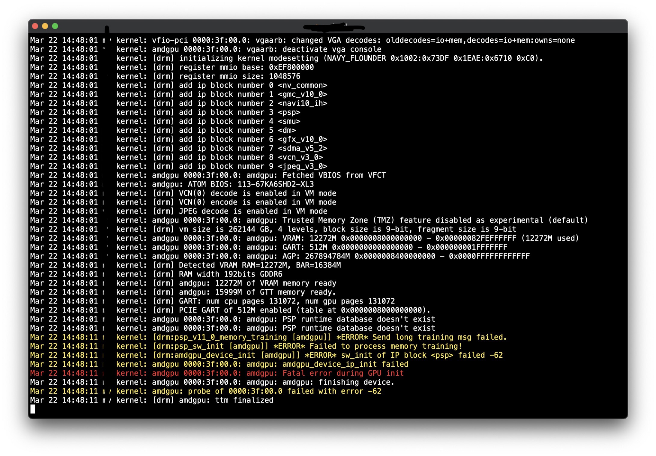

Did someone help this guy out? I've run a 1080 in a gaming VM with zero issues for years, but am having issues with my new 6700XT.  Mine doesn't crash. It just doesn't let the VM power off, and whines about not being able to change power state of it when booting up. Is there some issue with 6700/6750XT?

I'm having the same issue.  Mine crashes hard.  I've tried:
Error / Issue:  Driver NOT loading correctly in Win11 VM & low resolution
- Using ROM BIOS
- Resizable BAR enabled
Error / Issue:  Driver loading correctly in Win11 VM and resolution correct BUT Unraid crashes (locks up)
- No ROM BIOS (also tried with ROM BIOS)
- Resizable BAR disabled
Any ideas?

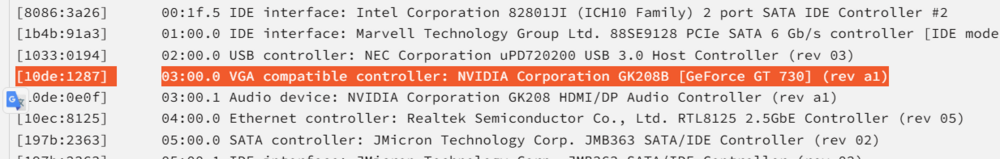

Can I do same for primary card ?
I have currently two cards in my server GT710 and 2080Ti.
The 2080ti I'm able to passthrough using
 append vfio-pci.ids=1022:148c,10de:1ad6,10de:1ad7 video=efifb:off isolcpus=2-11,26-35
pic-ids are devicesID for 2080
but I am not able to passthrough GT710 ?
Should I also list it within VFIO ?
You should be able to passthru that card also, You can bind to vfio, but you dont have to bind to vfio to passthru to a vm.
