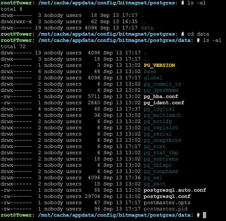

Araso Posted Friday at 03:41 PM Share Posted Friday at 03:41 PM What happens if you don't set up postgres? I haven't and after stopping and starting the container, the amount of items that were found before I stopped it are still there. In appdata there is no sqlite database or anything much, really. This leads me to believe that the data is being stored in docker.img - is that correct? Where is the data being stored if not using a postgres database? Quote Link to comment
binhex Posted Friday at 03:46 PM Author Share Posted Friday at 03:46 PM 4 minutes ago, Araso said: What happens if you don't set up postgres? you don't need to, its included in the image. 4 minutes ago, Araso said: This leads me to believe that the data is being stored in docker.img - is that correct? nope 🙂 its in the postgres database, see /config/postgres/data/ Quote Link to comment
Araso Posted Friday at 03:53 PM Share Posted Friday at 03:53 PM 2 minutes ago, binhex said: see /config/postgres/data/ I have a postgres directory in 'appdata/binhex-bitmagnet/postgres' but it's empty, which is what led me to believe what I said about docker.img. That directory is empty even after a stop/start of the container which I did just to see if it would flush something to disk. It still retains all the crawled data after a restart. Quote Link to comment
binhex Posted Friday at 04:20 PM Author Share Posted Friday at 04:20 PM 24 minutes ago, Araso said: I have a postgres directory in 'appdata/binhex-bitmagnet/postgres' but it's empty, which is what led me to believe what I said about docker.img. That directory is empty even after a stop/start of the container which I did just to see if it would flush something to disk. It still retains all the crawled data after a restart. So do you not have a 'data' folder under 'appdata/binhex-bitmagnet/postgres' ? if not then please paste your log from /config/supervisord.log. I have confirmed the image is working correctly by renaming my data folder in /config/postgres/ and then restarting the container, i could then see a new data folder created and populated so its got to be misconfiguration or permissions related would be my guess. Quote Link to comment
JonathanM Posted Friday at 04:22 PM Share Posted Friday at 04:22 PM 27 minutes ago, Araso said: I have a postgres directory in 'appdata/binhex-bitmagnet/postgres' but it's empty How are you looking there? If you are connected via SMB, the data folder is hidden. Use mc at the Unraid console, the data folder is there and populated with all the normal postgres database folders. Quote Link to comment
Araso Posted Friday at 04:29 PM Share Posted Friday at 04:29 PM 3 minutes ago, JonathanM said: Use mc at the Unraid console, the data folder is there and populated with all the normal postgres database folders. Hmm... I use Linux from where I mount my cache disk with SMB4K and from there I look in my appdata. I've always done this. At no point have I not been able to see the data in there, even if I've had to show hidden files. Using mc I can, indeed, see the postgres/data directory. Strange... So it seems my install is working correctly but for some reason the data is 'super hidden'? I've never encountered this before. Quote Link to comment
JonathanM Posted Friday at 04:30 PM Share Posted Friday at 04:30 PM Just now, Araso said: for some reason the data is 'super hidden'? No permissions granted. Quote Link to comment
Araso Posted Friday at 04:33 PM Share Posted Friday at 04:33 PM 1 minute ago, JonathanM said: No permissions granted. Apparently so... As I say - I've never (or don't ever remember having) seen this before. Right-click and Properties shows 0 bytes used, which also now makes sense. Well, I best leave it well alone. Thanks for the pointers! Quote Link to comment
binhex Posted Friday at 04:41 PM Author Share Posted Friday at 04:41 PM 1 minute ago, Araso said: Apparently so... As I say - I've never (or don't ever remember having) seen this before. Right-click and Properties shows 0 bytes used, which also now makes sense. Well, I best leave it well alone. Thanks for the pointers! I can see that permissions are not granted for the group and for everyone, perhaps this causes an issue for you?, the permissions are set by postgres as it initialises the directory so i would be loathed to overwrite this. Quote Link to comment
Araso Posted Friday at 04:44 PM Share Posted Friday at 04:44 PM Just now, binhex said: perhaps this causes an issue for you? My only concern was to not fill up docker.img. Now that I know, this is working perfectly fine as it is. So no changes necessary. If it's not broken... Thanks for the container, it's working great. 1 Quote Link to comment
