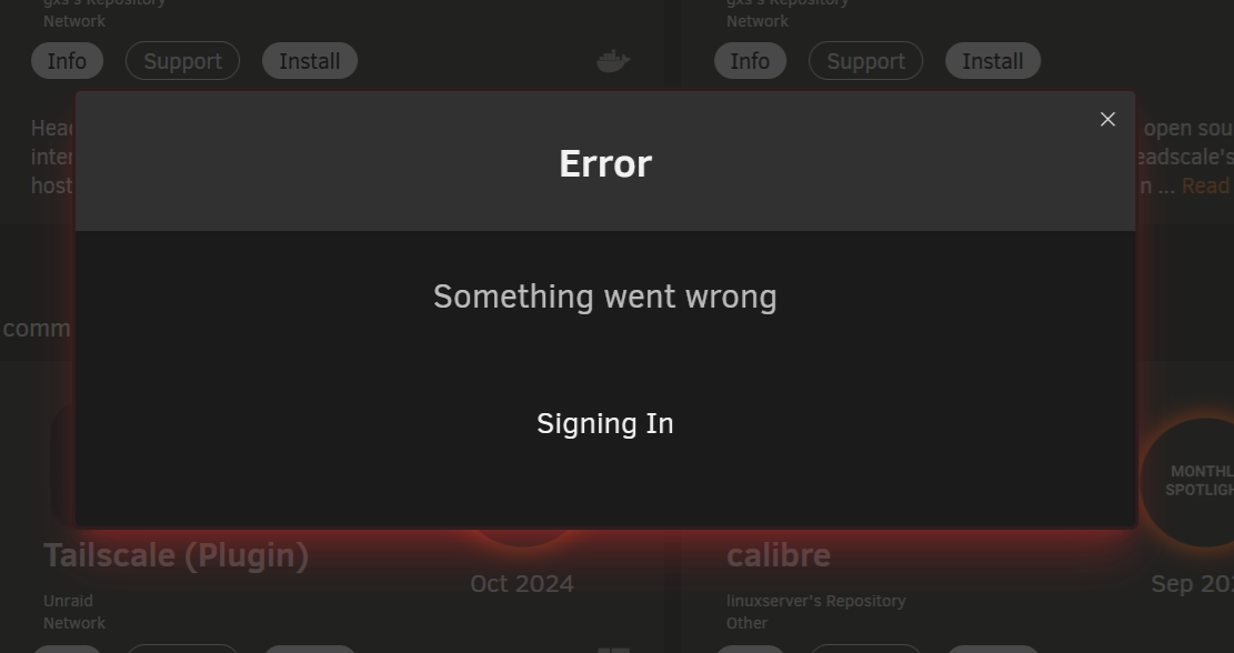

September 18, 20242 yr Everytime i try to login, it goes through the process and then fails. ray-diagnostics-20240917-2150.zip Edited September 18, 20242 yr by Kykoibrahim
October 29, 20242 yr I have the same issue. Can not "Register your server for Unraid Connect". Can anyone help me with my problem?
November 13, 20242 yr I tried to delete the connect plugin and reinstalled it, rebooted the nas. But still not able to sign in. Can anyone help me with this problem? Edited November 13, 20242 yr by dvbenthem
November 25, 20242 yr I'm seeing the same issue. Tried uninstalling/re-installing Connect, and tried rebooting Tower. Neither action made any difference.
