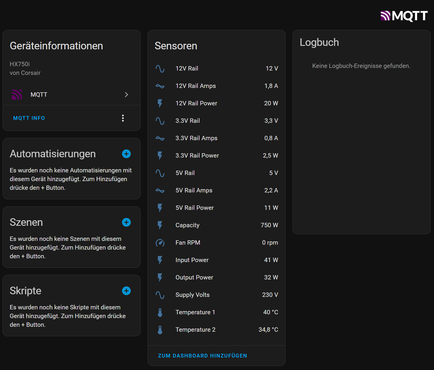

October 23, 20242 yr Hi! I wanted to publish some data from my unraid server to mosquitto so I can see and track it in Home Assistant. This plugin is the result and gives you the ability to publish custom data to your own mqtt data broker. You can also subscribe to a topic when you have an usecase for that, or just simply for debugging. For more information take a look at the github repository. Here is a quick example. I used the data provided from my corsair power supply: Edited October 23, 20242 yr by giganode
