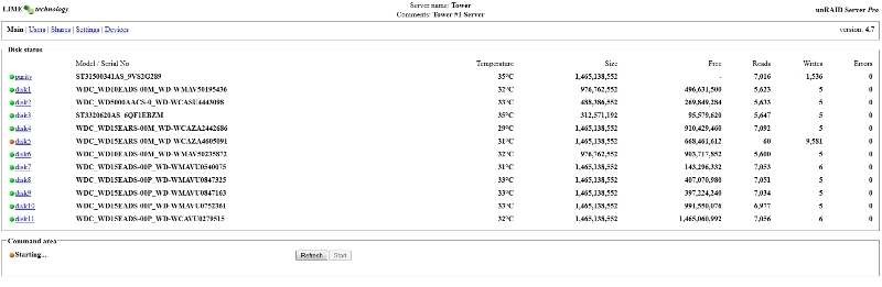

I just replaced the drive and now it says Upgrade disk. I started the array and the drive has an orange dot and it says it is starting. It has been starting for 15 minutes or so.
Is this normal?
This normal? Been running like this for a while
Hard to read the picture - resolution is too low.
However, did you preclear the drive before trying to add it to the array?  If not, then unRaid will take a while (hours) to initialise the drive before it adds it into the array.  So this *could* be normal, depending on what you did.
ah yes... I did not preclear it so that explains it.
Oh well. I will wait
Refresh the browser to get progress updates.
The web page does not seem to be loading for me so I cannot tell if the upgrade of the disk is done or not

This is what I see

I thought upgrading an existing disk just rebuilt the data from parity + rest of drives, expanded the partition if there was extra space, and zeroed the newly allocated portion. So it zeros the entire space first? I've always upgraded drives with precleared spares, so I don't know from experience.

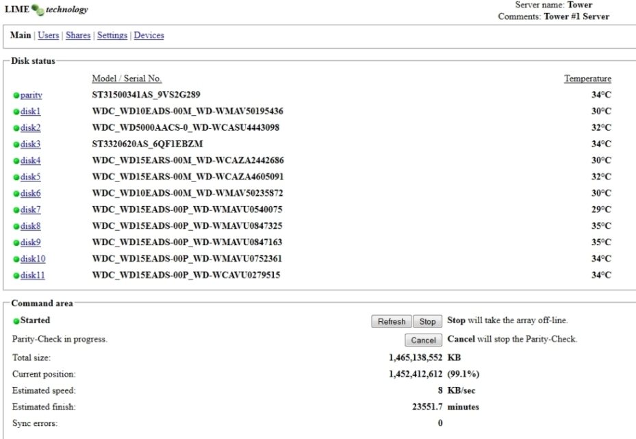

Joe,
The parity seems to build find up until near the last few %, then it really slows down to a crawl
Here is a screenshot
