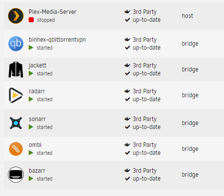

Docker container now shows 3rd party
Hi friends....I installed a Qbittorrent container about 3 years ago from the app store. I recently went in to change some paths and find the container listed as a 3rd party container and I do not have the option to click the name and edit its settings. Not sure why it is 3rd party now. I have only installed containers from the app store and never used docker compose. I am wondering why it is now a 3rd party app and how can I change the setting variables for the container.

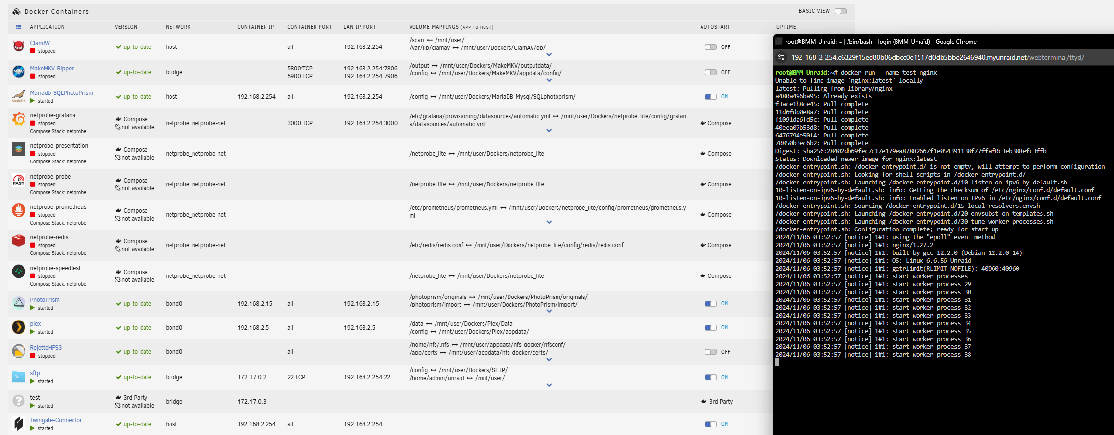

netprobe is a docker compose example and what it would show... all others are unraid template. Note the docker test... see the terminal windows....
This is why it says 3rd party... you may have pulled the docker run at one time removed the image and ran it in terminal...

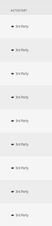

Same problem here for ALL my containers :(
LE: Even the delay for autostart can't be changed

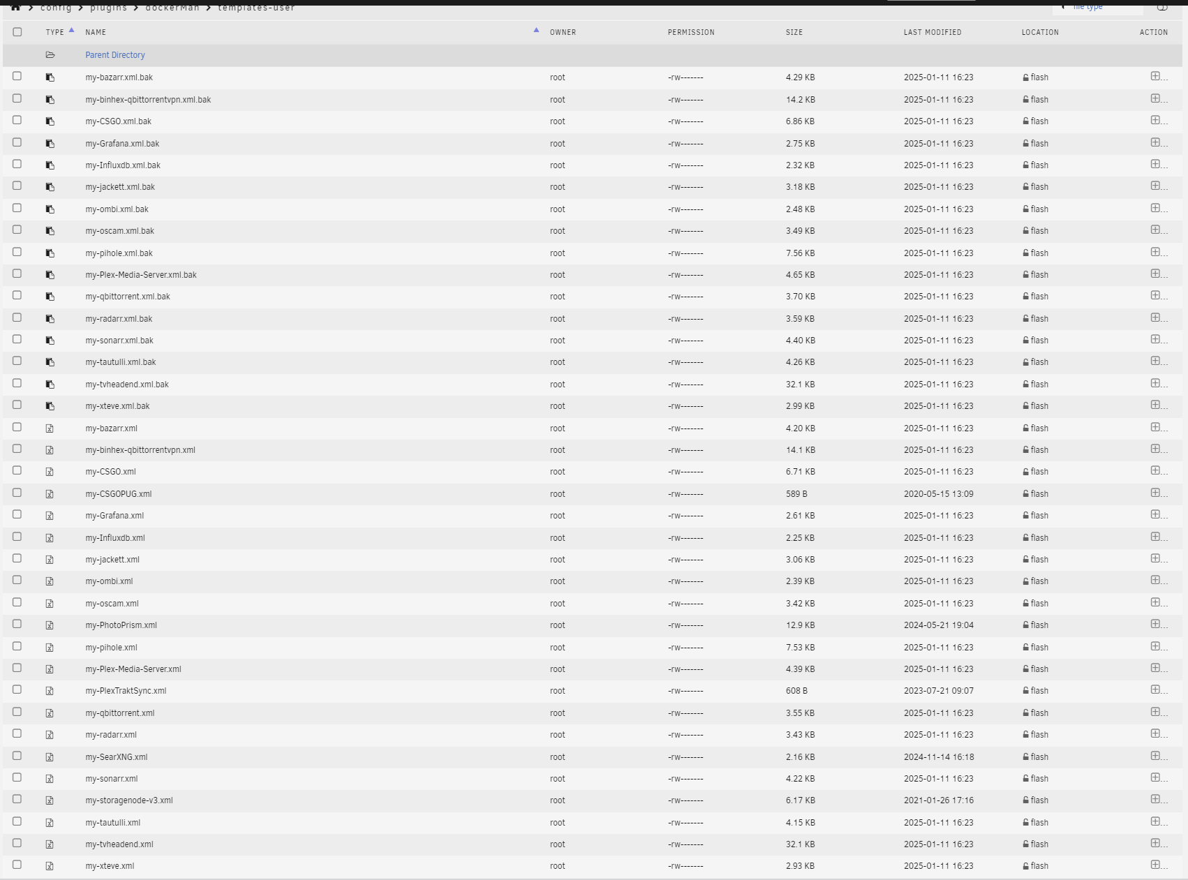

That suggests the templates are missing from your flash drive. If you have them in a backup you should be able to put them back.

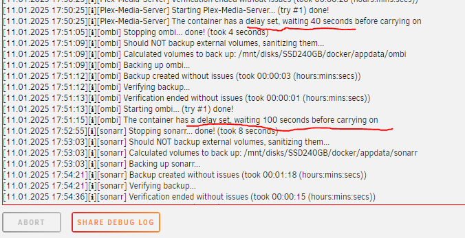

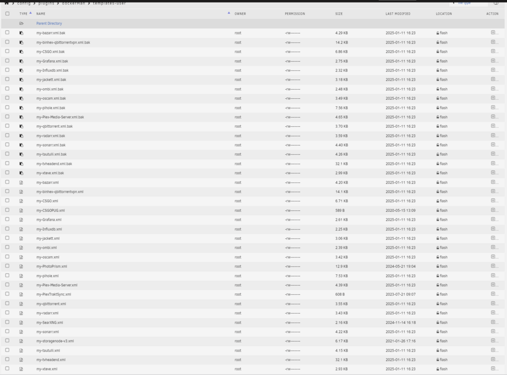

I do have a backup of them but they are not missing in my opinion, since Backup/Restore Appdata can see the delay I set in 6.9.2.
Or is the folder structure wrong ? I alsoo see dockerMan/templates, maybe I need to move them to there under a new folder structure, can I have some examples from you ? Thanks!
theyarethere.thumb.PNG.5e98d7439f7e44a241aa0d0483158e01.PNGdelays.PNG.1ea0b6cad6a9cd69659a2314081b3c86.PNG

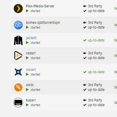

I had some containers that needed an update and they now appear ok, I don't see any way of editing the 3rd party from GUI.

I also just upgraded from 6.9.x to 7.0 (I know big jump) and am having the same issue. My template files are fine so that's not the issue.
As @primeval_god says I've found that I can either delete and recreate the container, or I can update the container (for those that have an update available) and that resolves the issue.
