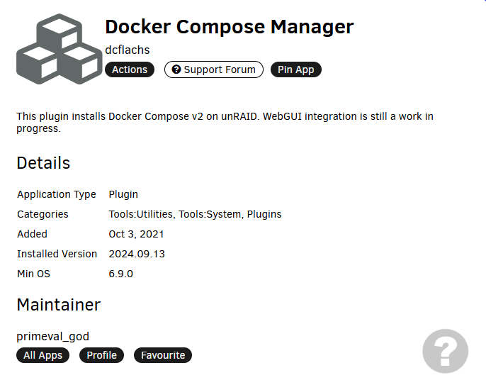

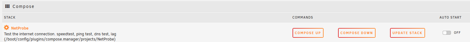

there's a docker compose plugin (I use this)
I was exploring that for other network related things for your answer, but it appeared you wanted to use unraid template system.
as example netprobe:
run multiple docker in its own bridge network.

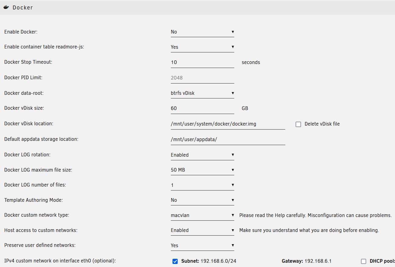

since zfs and docker image, are you using the xfs verison?
what storage driver? as 7 did become rc1 and i have yet to find a issue/bug with it.
https://docs.unraid.net/unraid-os/release-notes/7.0.0/#add-support-for-overlay2-storage-driver
Add support for overlay2 storage driver
If you are using Docker data-root=directory on a ZFS volume, we recommend that you navigate to Settings → Docker and switch the Docker storage driver to overlay2, then delete the directory contents and let Docker re-download the image layers.
If retaining the ability to downgrade to earlier releases is important, then switch to Docker data-root=xfs vDisk instead.

In terms of docker storage I just used all the defaults:

turn off docker.
I would suggest deleting the docker.img via checkmark delete the vdisk file
And then change docker data-root and use xfs vDisk  img
(this may fix some things) including later if/when upgrading to version 7 when fully release.
This will remove all docker images in the docker tab. (data is not lost...)
in docker tab at bottom
add container > template drop down > click apply to bring them back.
No data loss is done as data is stored in the appdata folder/ on disks and no in the docker image.
The docker pull image name data is whats is lost which is why the docker tab will go empty...
If you suspect its docker related, it may be due to the docker data-root option. I don't recall having full trace but I do recall a update to 6.x.x I forget which one where this fixed a bunch of docker issues for me.

OK....update. The parity completed last night while I was asleep. No errors, no crashes.
Docker disk has been deleted and re-created. Now have a xfs imag running on a ZFS pool:

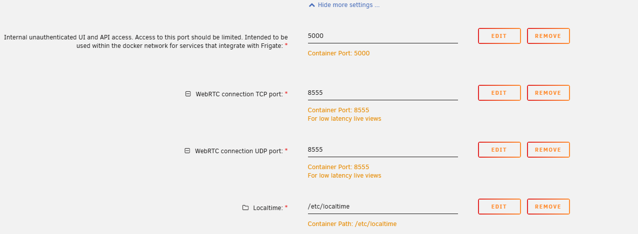

I am running two copies of the default repository:
And I'm pointing to ghcr.io/blakeblackshear/frigate:stable.  I'm running coral.ai via USB so I have the containers as privileged - everything works just fine, but during a parity sync if Frigate is running it will crash.
I had a hard crash last night (Unraid dropped off the network) and so on restart it started a parity check....which crashed in the usual way at 6.5% progress.
I have gradually been re-instating my old settings (second NIC with vLANs) but the crashes are still doing my head in....everything is fine and then bang - unraid kernel bug and we're dead in the water.
There's an outside chance that the cause is running a pair of Frigate instances....but I can't see why that would cause parity-check problems when then frigate data paths are nowhere near the array itself.

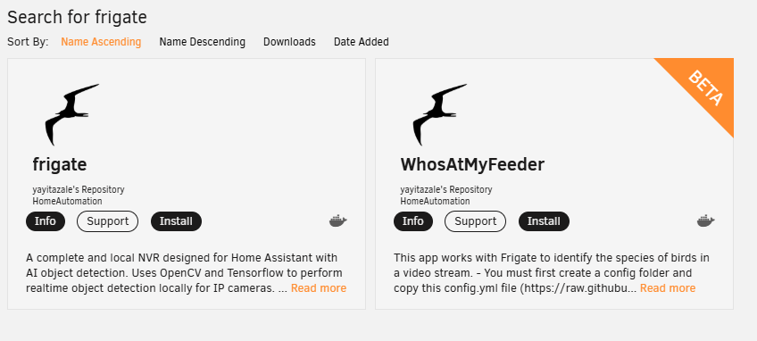

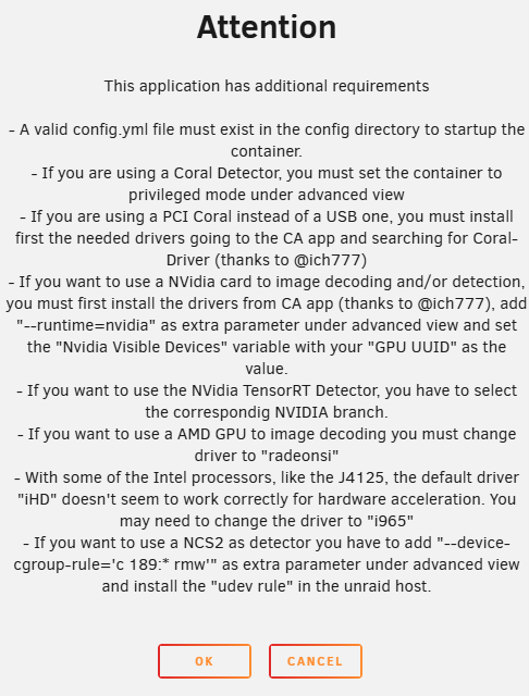

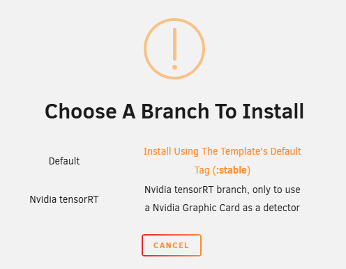

Per recent docker support on that one they recommend a fresh template download.
On 10/21/2020 at 2:31 AM, yayitazale said:
IMPORTANT PLEASE
UPDATE V0.14.0 IS A BREAKING CHANGE:
It is recommended to uninstall the current app and reinstall it to meet the needs of the new template.
PLEASE READ THE CHANGELOG TO UPDATE YOUR CONFIG FILE
Support for Frigate docker container. Uses OpenCV and Tensorflow to perform realtime object detection locally for IP cameras. Designed for integration with HomeAssistant or others via MQTT.
Application Name: Frigate
Application Site: https://github.com/blakeblackshear/frigate
Docker Hub: https://hub.docker.com/r/blakeblackshear/frigate/
Github: https://github.com/blakeblackshear/frigate
Documentation: https://docs.frigate.video/
This container is only for AMD64 architecture CPUs (Intel/AMD) and its intended use is with a Coral Edge TPU accelerator to reduce the CPU usage.
Make sure to look at the complete documentation available on Github! Any question about the usage of the app and runtime errors please use the github issue page.

Here is my two TPU instances:
On the templates I'm using the default /dev/bus/usb notation for both.
I can update this /dev/bus/usb/002/004 and 005 respectively in the docker configuration and it will start fine. In theory I suppose this hard codes the TPU (based on USB location) to the Frigate instance (so also no more changing ports when unplugging / replugging the devices).
I cannot set this in the application configuration as the system fails to start successfully. The default in any case is also just USB...the usb:0 and usb:1 I believe are to keep them separate (somehow).
I have the latest template (I think) as only really started building this in August when this was only just released - certainly I can't see any obvious differences so probably OK.

I've pondered using the docker compose manager approach....but interesting when the machine rebooted after this afternoon's crash the USB addresses have actually moved even though the USB devices have *not* been moved to different ports. Compare this to the previous screenshot:

The prevailed option is required when using other devices, as this grants root access to the host for these devices.
Usually when I have set up frigate in the past it was with a NVIDIA GPU

based on what you have provided, the single device pass would be this extra parm command:
--device /dev/bus/usb/002/005
But you need to review your docker template and make sure frigate only get that device.
as this is why i would want udev rules.. in Beta 7 rc1 you could make a udev rule...
cd /boot/udev/99-usb-coral.rules
ACTION=="add", ATTRS{idVendor}=="18d1", ATTRS{idProduct}=="9302", SYMLINK+="coral_ai"
ls -l /dev/coral_ai
--device /dev/coral_ai
