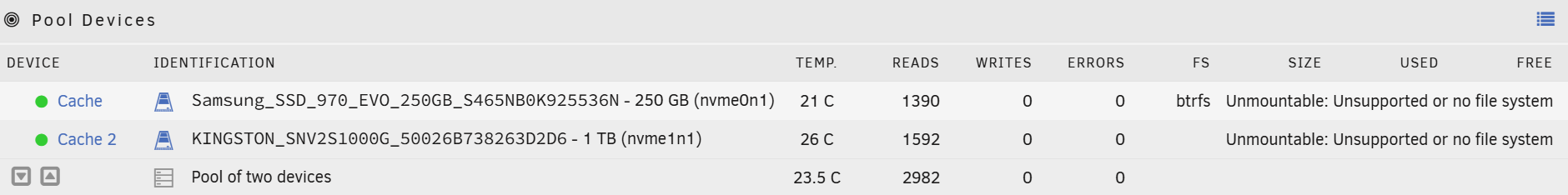

Unmountable cache disks
Solved by JorgeB
So a bunch of docker containers installed, but it seems I can't start them...
A bunch of errors in the syslog attached. I have no idea how to interpret it.

So actually both my pool disks are now unmountable, I have no idea what happened there.

And on reboot, the cache disks are unmountable again.

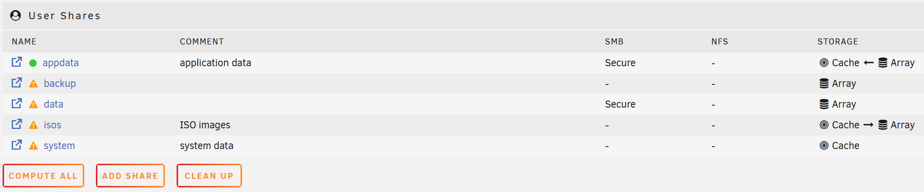

So it seems things are starting to work again now. Installed the new 500gb harddrive in pool, and the first thing I noticed is that is is 30 degrees cooler than the last one.
A final checkup (I hope):
1. Is these shares ok or would you suggest other?
2. Logfile included, does it look good? No more red flags in the syslog by the way.
tower-diagnostics-20241217-1418.zip
Syslog looks OK for now, as for the shares, default shares could probably be all set to cache=only, but first you need to confirm if they have data on the array, and if yes, move it first.
