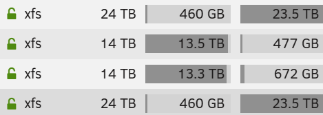

This is a very interesting topic. I was about to run defrag on my drives to figure this out...
For me, I'm seeing ~2% usage on an empty 24TB drive, which seems like a lot, since the 14TB drives these are replacing used 96GB or so.
As I understand it then, w/ reflinks and crc enabled, this 2% usage of an empty drive is operating as intended?
