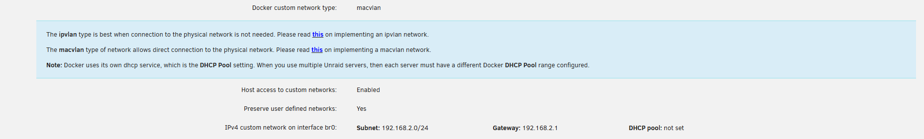

Per your picture that setting seems to be enabled. per other data, you have interface with vlans corectly.
the defualt custom eth in the picture is vlan1

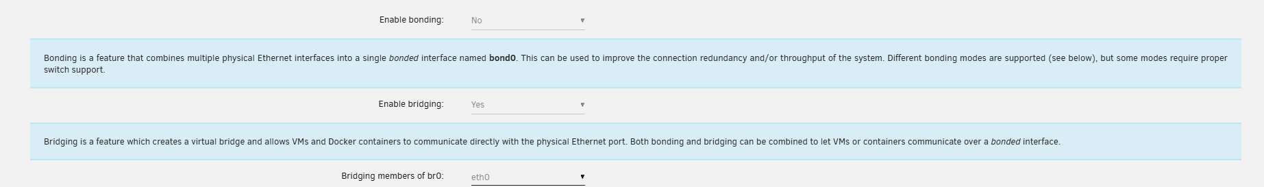

to make a docker network and use the subnet on a vlan you need to make a docker network.
since your network settings are bridging off and bonding off (same as me). you need to make a docker interface with the parent and tell dockers to use that network.
as per picture:
don't have a docker netwokr only eth0 gets a defuaut docker network...
to fix this make docker network:
