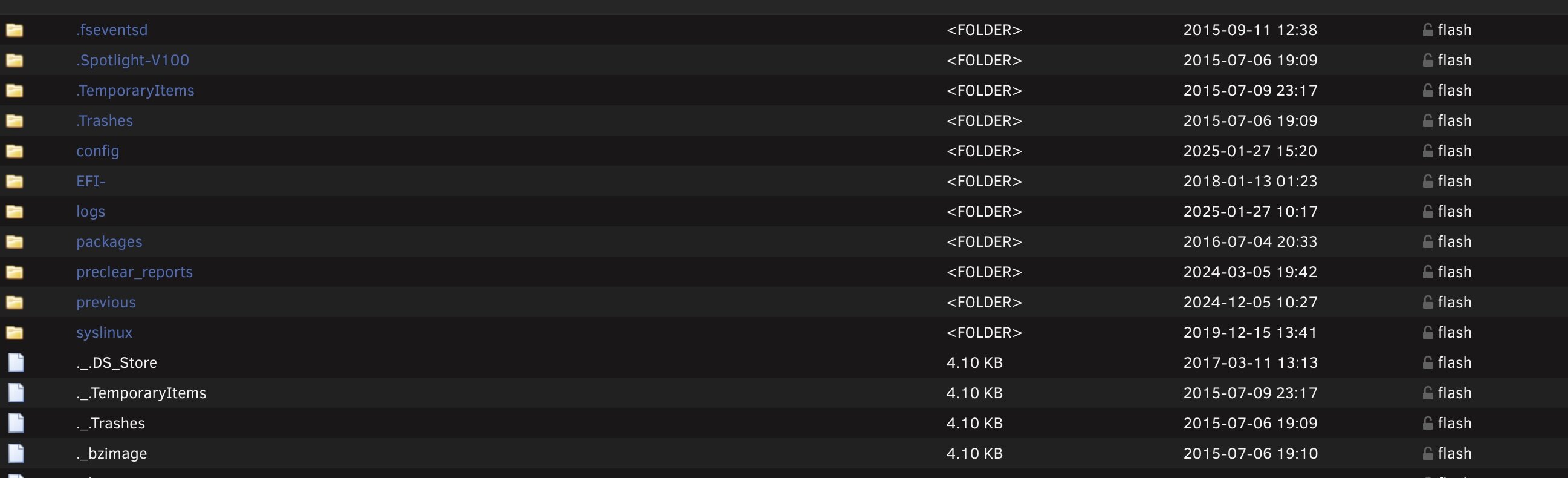

Or could I delete everything in the LOG and PREVIOUS Folders to clean up some space?
You can, but that should be unrelated to the boot issue
