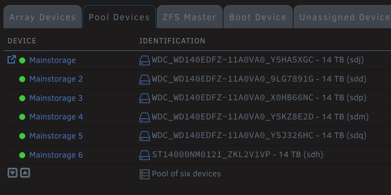

Hardly. I can easily get upwards of 200MB/s sustained all day every day over SMB on 2.5gbit LAN from my Macbook Air - reading and writing to spinning disks no less. ZFS ZRAID2 volume with 6 disks.
You need to make sure that your share has EXCLUSIVE ACCESS enabled - and that of course PERMIT EXCLUSIVE SHARES is enabled in the general share settings.

From a Mac it's of course abysmal and the Finder can lock up just opening a directory with 1000 files in it. Here it doesn't matter what networking gear is being used, IME. But since switching exclusively to ZFS for the shares I connect over SMB, it's been phenomenal. And directory listings are near-instant at all times, with large files sustaining speeds over 200MB/s on 2.5GbE USB-C adapter.

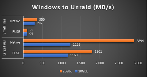

A stripped pool will always be faster than the array, but with recent disks, it is easy to get 200MB/s plus writing to the array, and 1GB/s+ to a pool, both through fuse.

It's good to hear. Since 7.0 beta and rolling out all new hardware over here, I've moved all primary stores to ZFS. One system is using spinners and all new drives going into it are the same size. Other systems are using exclusively NVME and don't require nearly as much storage, so I've felt pretty comfortable giving up Unraid's namesake feature, the array. The spinning rust system has a lot of available bays, so I'll keep one array volume for the largest of left-over drives, since they can spin up/down one at a time and I won't need to use them for primary access and therefore unlikely to access them directly from my Macs - but I'm super curious to validate passthrough when it's implemented.

Hopefully yes, but looks like it will benefit mostly large file transfers, and the main Unraid issue with FUSE is with small files, with large files you should easily get 1GB/s over FUSE.
