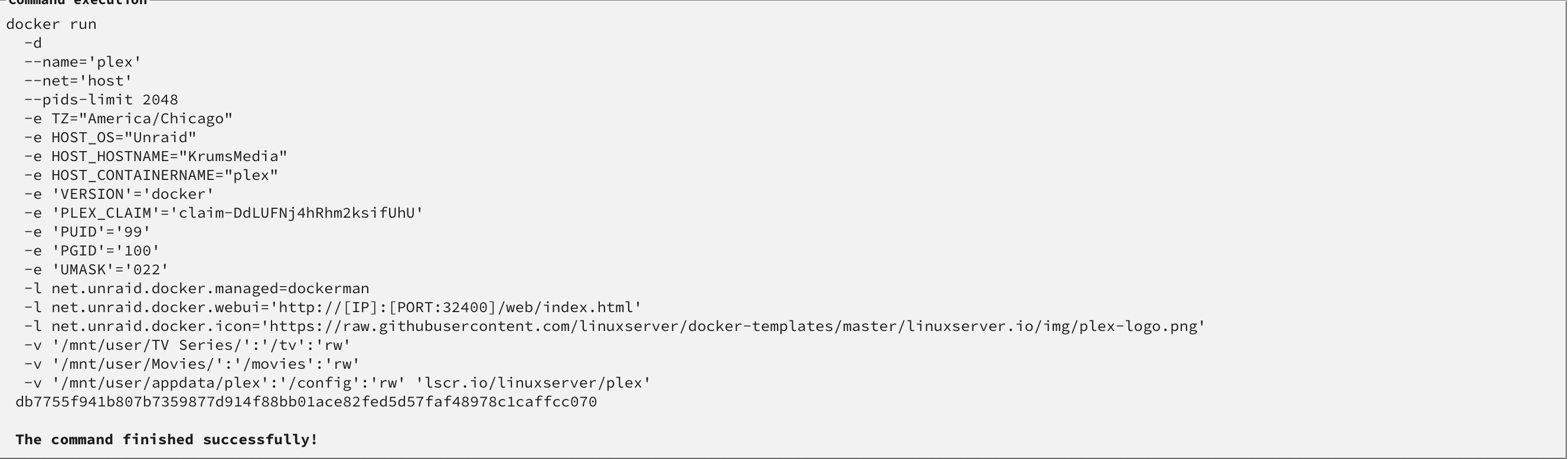

3) Deleting Plex and re-installing with new Plex_Claim code

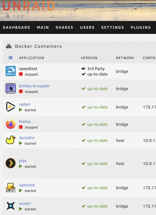

Can you access the Plex webUI?
Does the Plex icon in your Unraid webUI indicate it is started?

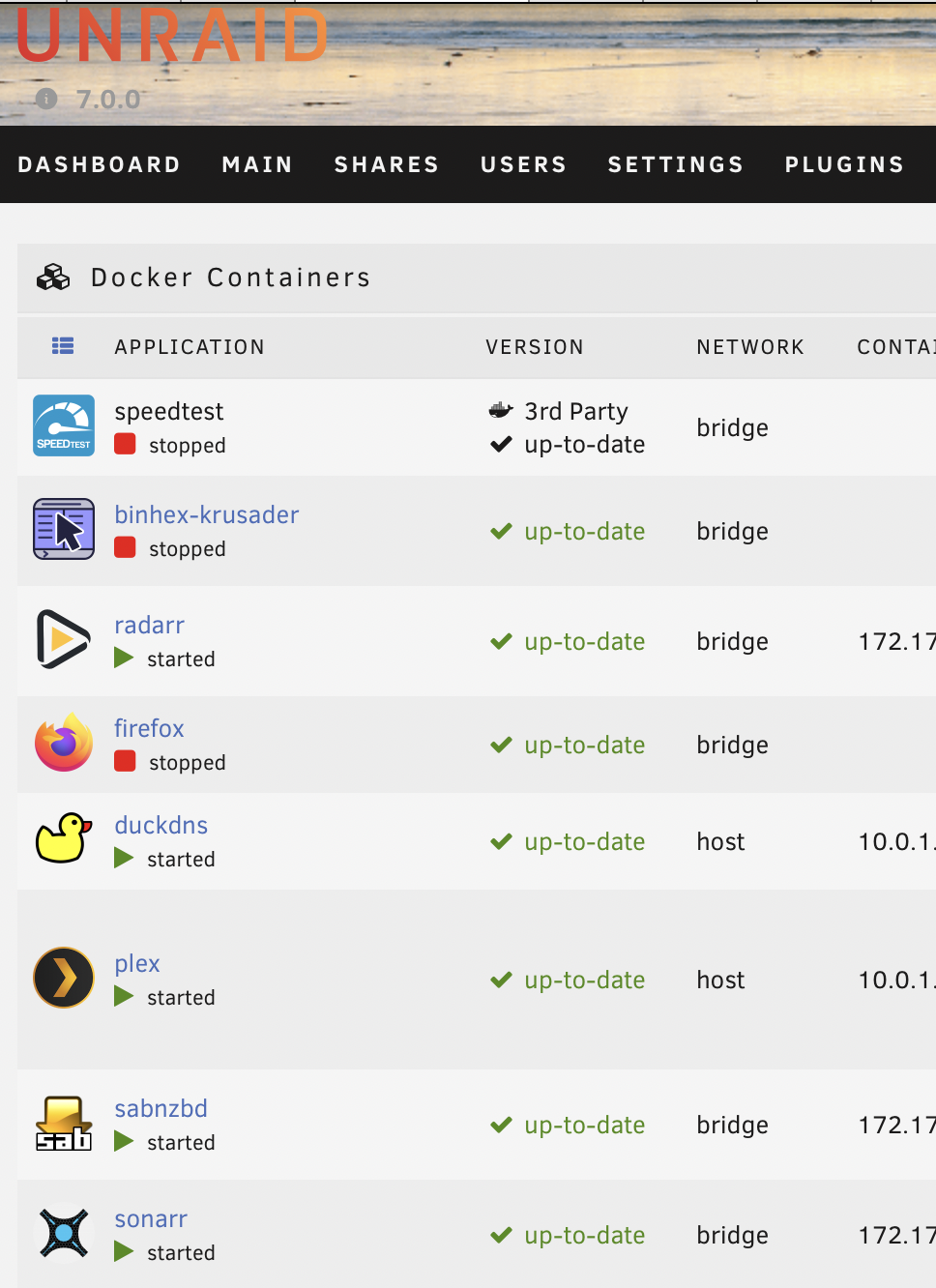

trurl: Yes, on the docker tab it shows that Plex is running.

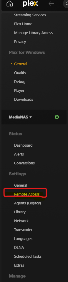

Hoopster: Where do I find the settings for remote access?  I dont see those options
In the Plex webUI. What was the answer to this?

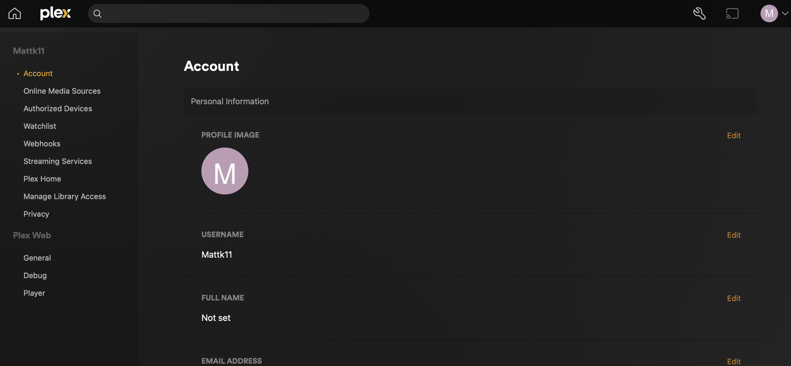

Here is what I see.....ScreenShot2025-02-13at9_48_57AM.thumb.png.bb61f41bc974e989ec0b4304e5063ff6.png
Since you have local access to the Plex webUI, does it appear to be working OK? Can you browse your media?
No I cannot browse it at all.  It's like the Plex app cannot see my server.  Remotely, through VPN or directly

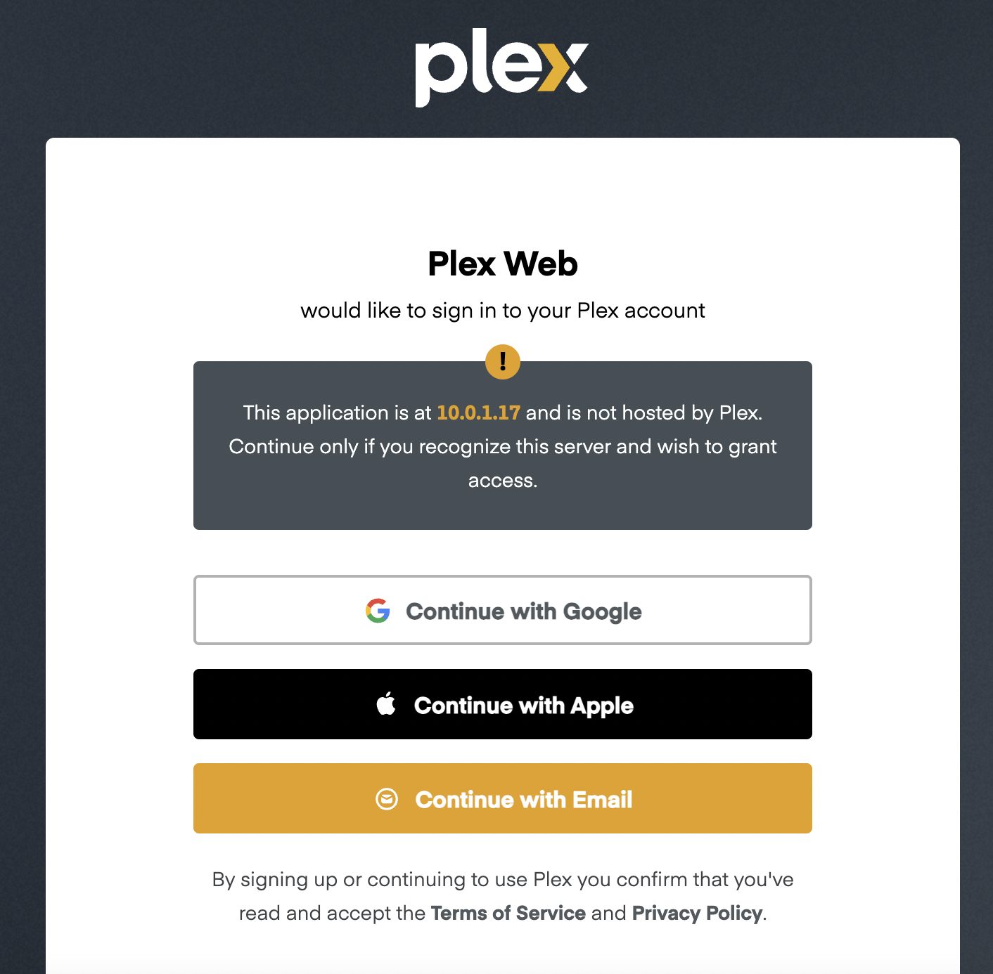

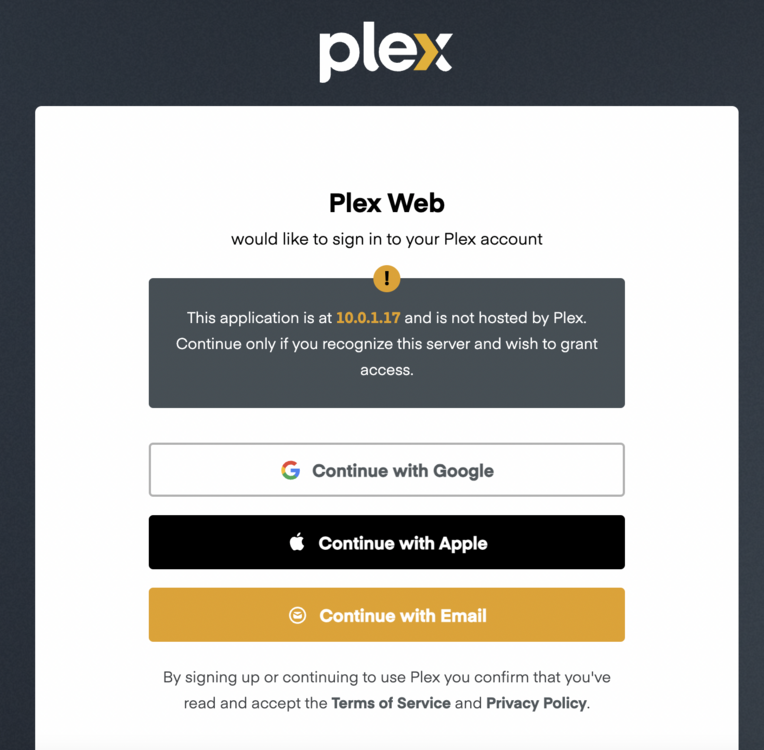

If you click on the Plex icon in your Unraid webUI and select WebUI, what happens?
This is what I see:
When I click on start WebUI, this is what I see:

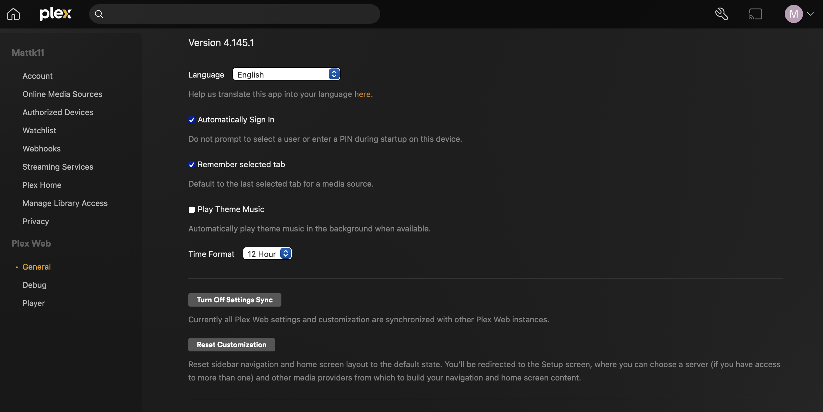

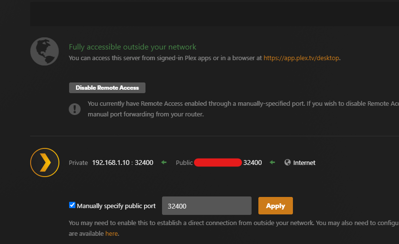

Select the Settings Icon in upper right corner:
Then on the left side, you should see a menu like this with Remote Access under Settings:
I dont see all those options:

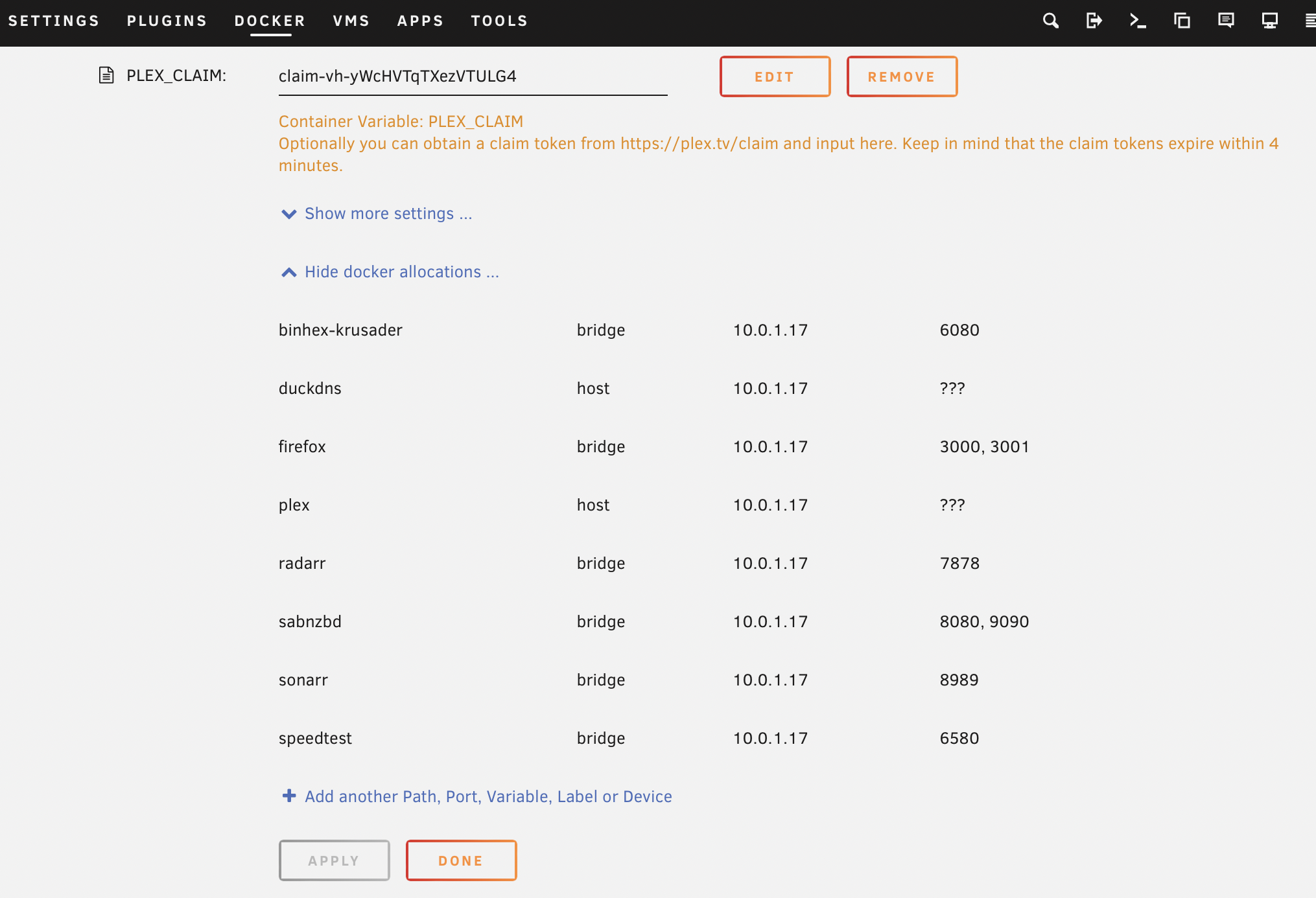

Could this be an issue that there are question marks next to Plex?
I don't think so.  My Plex installation is working perfectly and it also shows the question marks for Plex in docker allocations.
You have to select the setting icon (wrench) first in the upper right corner.  Your prior screen shot shows that is there.

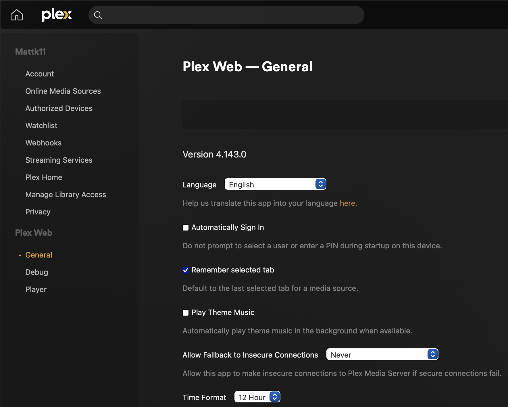

I decided to try to log in with a different browser to see if I have more access and this is what I see.
Did you try to login?
Yes, it looks the same
