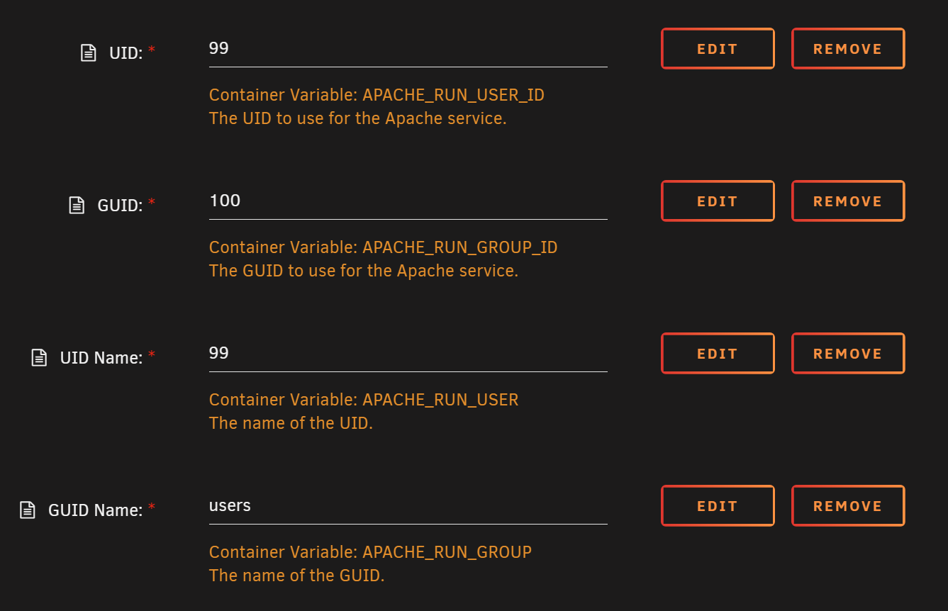

If I use those values in my template and create a file inside filerun the file appears like this:
Thanks! You give me the the way to the solution.
I installed with the standard user name and the .filerun.trash folder had the wrong user. After changing to 99:100 it works now!
Just testing the above and can confirm that you are correct. The user:group gets set correctly and allows rename/deleting as well as being correctly set to nobody:users with the following UID/GUID config:
Quite interesting considering nobody:users is what is stated on FileRun docs.

I started seeing this recently as well and tried reverting the UID/GUID settings which seems to have fixed it - give the below config a go and see if it resolves it:
Interesting, I've not ran across any issues with using 99 and 100 for the names
I still cannot get FR to set "nobody" as the user for my unraid files. it still shows up as "UNKNOWN"
I actually believe UID Name should be "abc" and the GUID name should be "users"
