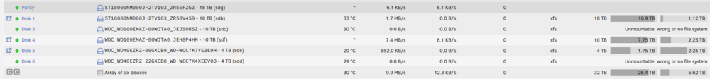

Only a few disks are showing. Parity, disks 1, 3, 4, 5, 6. No disk2, no cache. How many did you have?
Looks like one of the controllers is using IDE mode.
Go into BIOS and make sure all controllers are using AHCI mode. Then check and make sure BIOS can see all of your disks.
19 minutes ago, Smoketrain said:
had a 40 gb drive that was spitting out errors left and right, so I got an 18 tb drive to replace it. I shut down my file system, took out the 4gb drive
I assume you mean it was a 4TB drive. Is that correct?
Was it supposed to be disk2?

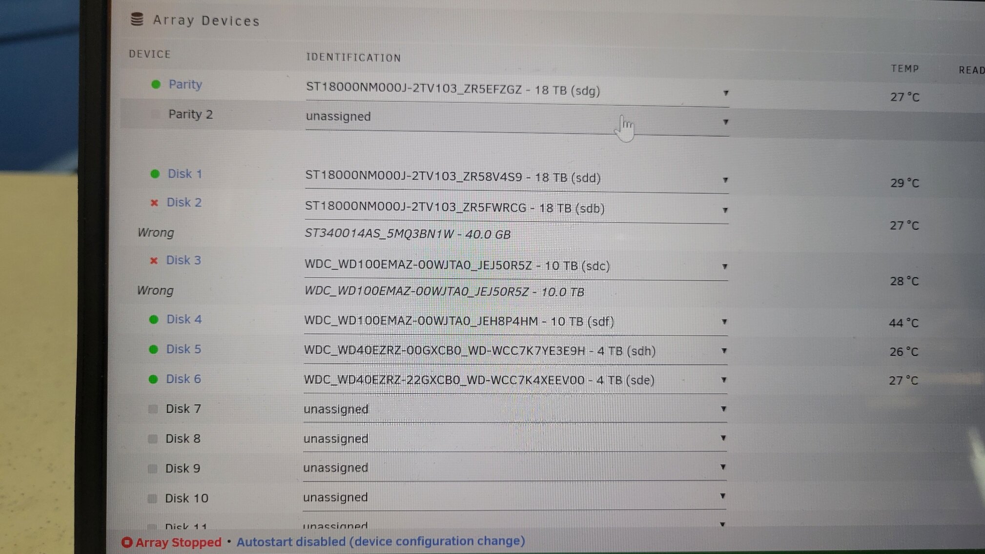

ok, so what happened now that I have calmed down a little? I had a 40GB drive that was spitting errors left and right. I shut down the system, took it out, and put an 18 TB drive in to replace it. When I brought the system back up, disk 3 showed this (attached).  I shut down the server again to take a look at maybe a bad connection, but no such luck. After a few simple troubleshooting things of unplugging and re plugging the disk 6 I belive was doing the same thing (no picture sorry). At this point, I think I did a stupid thing and read somewhere that when adding new drives, you have to make a new configuration, and I think that that messed me up even further. Now you should be totally up to speed.

The photo you posted (much better if you can get screenshots to post) shows disk2 wrong. It would normally be OK to replace that disk, except...
Disk3 also wrong. It doesn't look like it really is wrong though. Maybe something to do with IDE mode as I mentioned earlier.

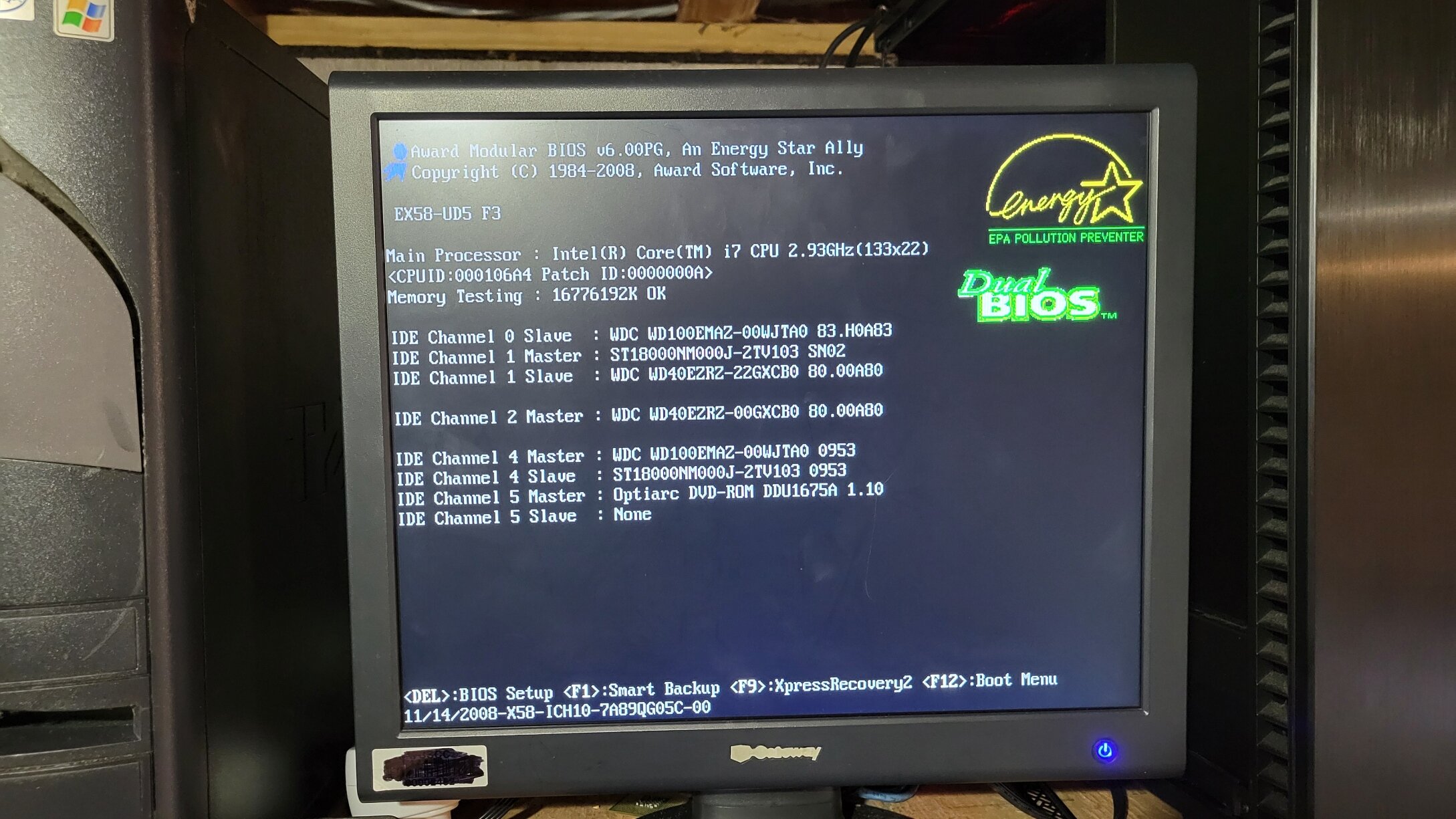

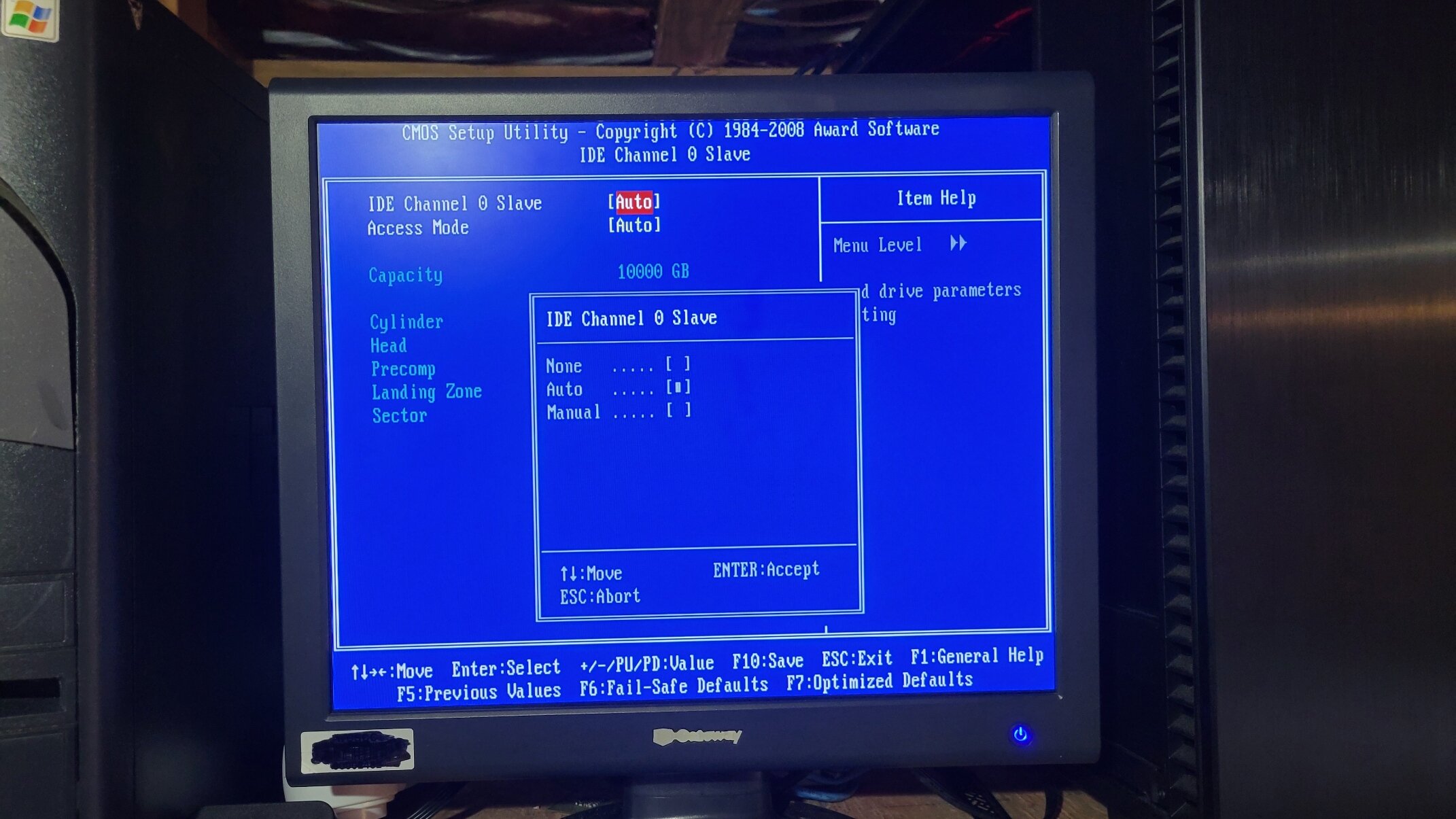

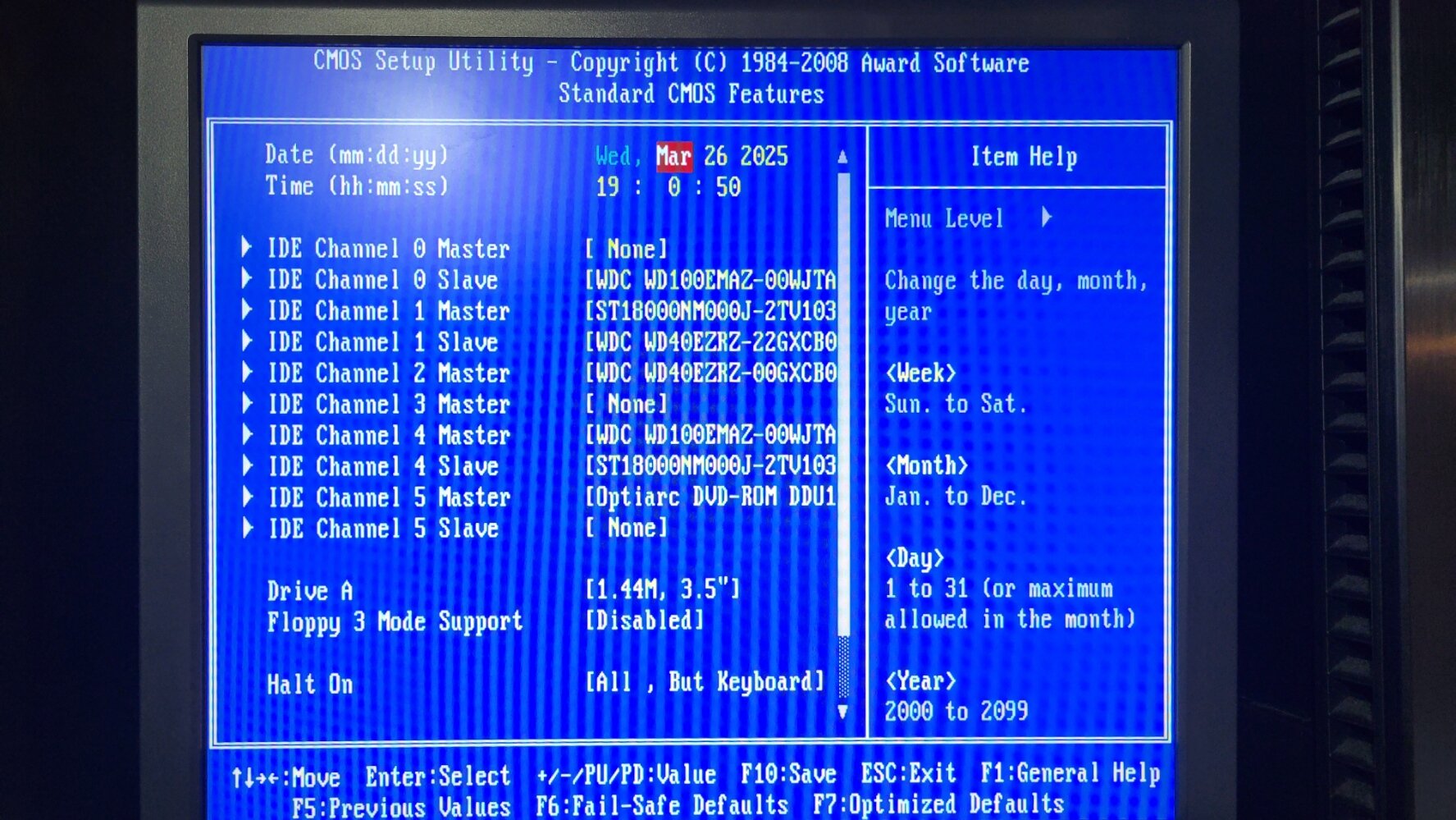

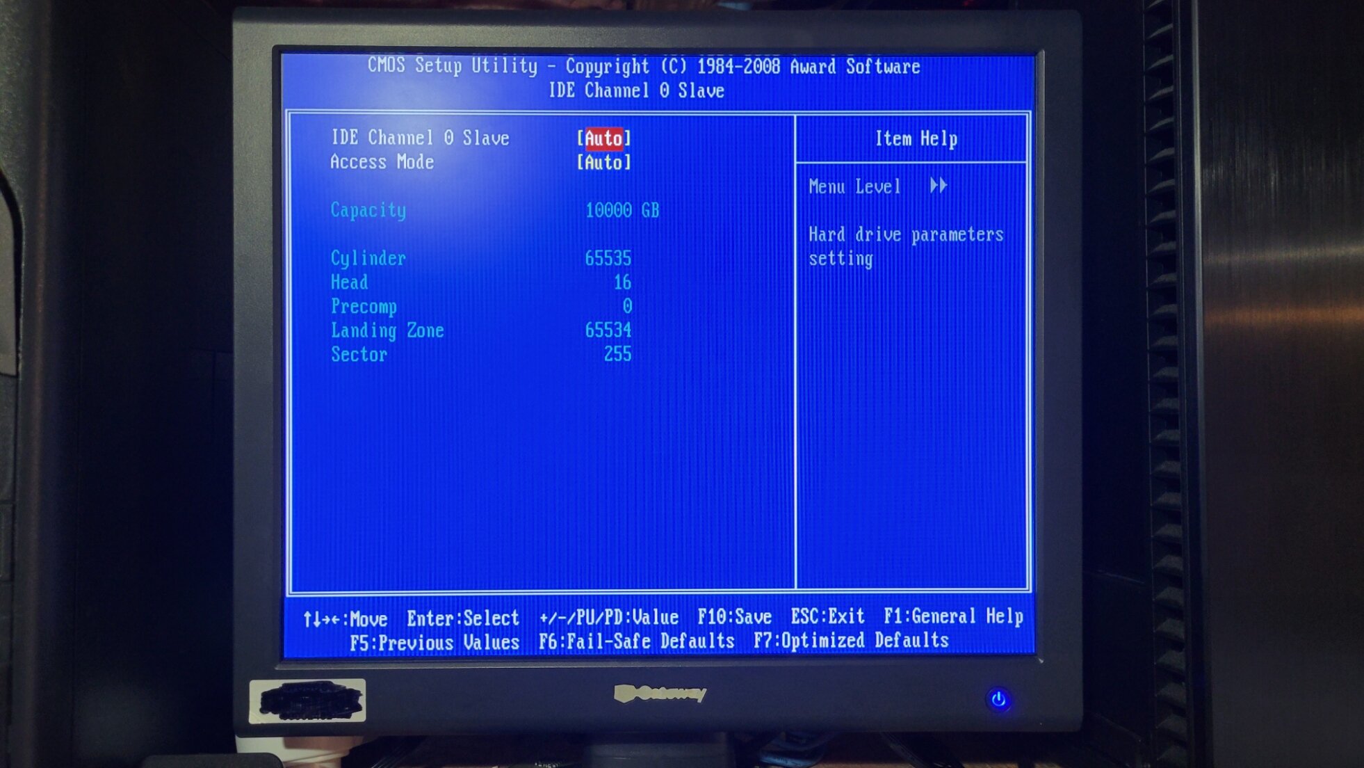

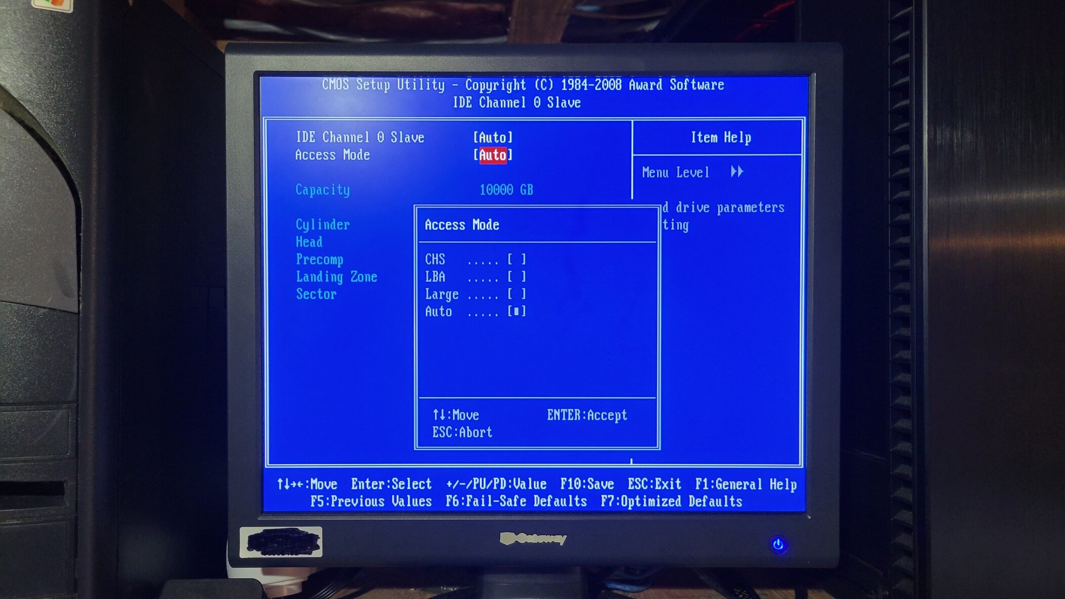

attached is some bios screen photos
I was hoping to get your disks connected AHCI, not IDE.
Are these disk ports on the motherboard, or on a controller card?
these are pluged directly onto the motherborad
According to diagnostics, parity and disk4 are AHCI.
Are there any other BIOS screens?
Looks like you can scroll down a little on that Standard CMOS Features screen, maybe something there?
Been many, many years since I have dealt with IDE master/slave. Any disks with actual IDE connectors are probably in a museum.
Maybe if you unplug the DVD you could get all your disks on the master ports.
Do you have any documentation for your motherboard?
I don't understand why that first photo you posted yesterday said disk3 was wrong since it is displaying the same serial number. I am guessing it got moved to another port, but normally that shouldn't matter since serial number is how Unraid keeps track of disk assignments.
Whatever solution we come up with we need Unraid to be able to consistently identify assigned disks.

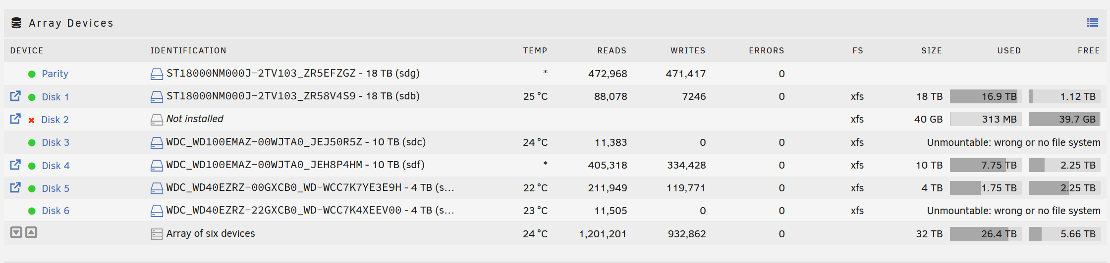

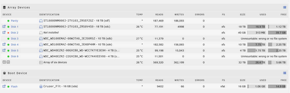

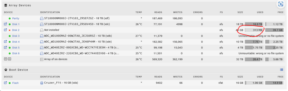

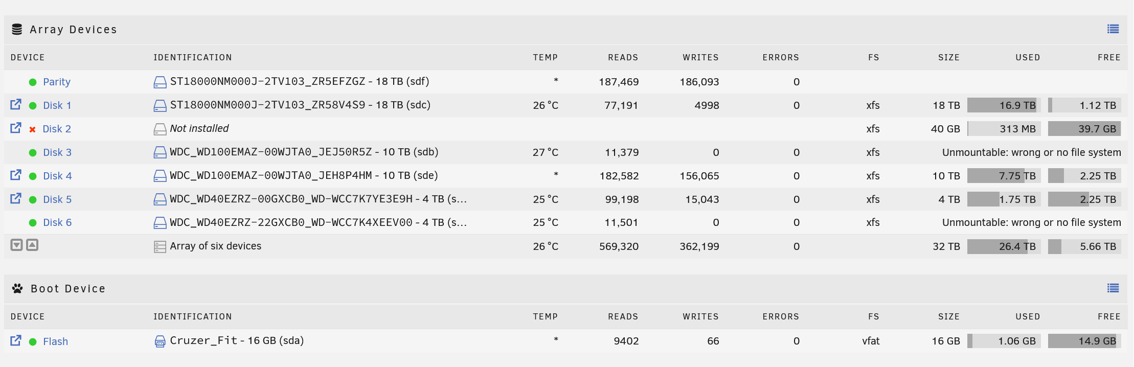

We found how to set up AHCI in the bios and we have turned that on and disabled IDE, have rebooted computer and have re-run diagnostics (attached) and we still have two drives that are unmountable (see screenshot).

Diagnostics shows only DVD still on IDE so that looks like progress.
I'm going to suggest we wait for another opinion from @JorgeB Might be a while, it's probably very late in his timezone.
With a normal configuration, I would just say check filesystem and try to repair the unmountable disks. But since the interface has been changing I'm wondering if something else should be tried instead. I think I have seen some threads where rebuilding each from parity due to controller changes was the way to go.
Of course, we also already have a disk that needs rebuilt, so that is another thing to consider.
Mar 26 15:04:23 Tower kernel: mount: attempt to access beyond end of device
Mar 26 15:04:23 Tower kernel: md3p1: rw=4096, sector=19532873623, nr_sectors = 1 limit=19532871512
Mar 26 15:04:23 Tower kernel: XFS (md3p1): last sector read failed
There's an issue with the device capacity not matching, have two questions, do you have the diags when this happened?
The above suggest the disk was being detected with a different capacity, it would be important to see those diags.
The other question, is how was this resolved, next screenshot shows the array started with that disk but unmountable.
