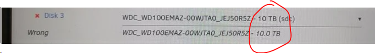

15 hours ago, trurl said:
why that first photo you posted yesterday said disk3 was wrong since it is displaying the same serial number. I am guessing it got moved to another port
If it were moved to another port and that changed its mode IDE/AHCI could that explain it?
  • Replies 55
  • Views 2.2k
That should never change the disk capacity, a RAID controller could, but that wasn't the case.
What about the old 2.2TB limit for some old controllers? Can you tell what the capacity changed to? Could that affect some ports and not others?

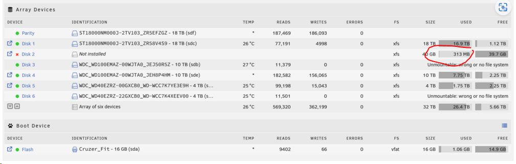

It must have been a minimal difference, if the disk was being detected as 2.2T it would be visible here:
8 hours ago, JorgeB said:
The other question, is how was this resolved, next screenshot shows the array started with that disk but unmountable.
What I did was I did a new config for the sever. I had read somewhere that when adding new drive you had to do that so thats why the server was able to start again.
New Config is not the normal way to add disks, but as long as you didn't need to recover any data probably didn't hurt anything.

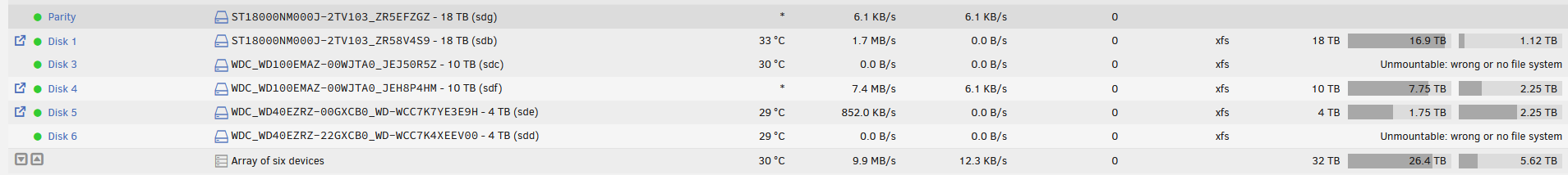

Are all disks mountable now?
no thats the whole issue, the two drives are not mountable even though I changed nothing with them

Now refresh the GUI, and both disks should show as wrong, you can do a new config again, but note that you will lose the emulated disk2, so make sure it's still empty:
Post new diags with the array started.
