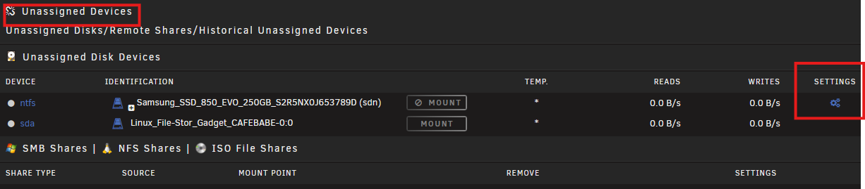

After that do a new config again, just to make sure the new layout is loaded, or just see if it mounts with the UD plugin in read only mode
What is read only mode,  I see maintenance mode, but not read only mode?

He's talking about the unassigned devices plugin, there should be a section on the MAIN tab closer to the bottom where you can mount disks that are not in the array slots at the top. There should be a toggle to mount it read-only from there.
