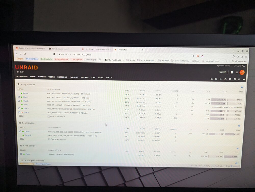

Ok moved the 12 TB to a new cable on the unused second port of my HBA card and its it doesnt appear to be mounting correctly.  This could be either the drive or or there is a chance the HBA port is having issues.  I have attached the latest diagnostics.   Will have to call it a night.  tower-diagnostics-20250406-1108.zip

Just getting back to troubleshooting this today .  So after a few restarts and swapping two cable.  Where it keep giving me read errors and saying the drive was unmountable or had no file system.  The array is now up and drive 3 mounted.
At this point it seems like there are bad sectors on drive 3 and or connection issues.   I could try running another extended smart scan but assume that is going to crash it again.
 I have a new 14 TB drive and another on order as i thought the 12 was completely dead and was ready to start again.
The one 14 tb is connected as an unassigned device and the old 8 TB drive 5 is also attached.   I think the 8 is ok but cant access it as its unmounted at the moment and currently  being emulated.
I'm wondering if the best route is to replace/copy the data from the 12 to 14 and then add the 8 tb and the 14tb back to the array.  If thats possible? Not sure how best to do that.
I currently only have the one extra 14TB drive (and a second 14 on order).  I also have about 10TB of free space on an external if i need a temp location.
I feel like the ideal step would be to rebuild the disk5 thats being emulated but I'm worried if i add the 8 back and try to rebuild it on itself that either the parity is wrong or the disc 3 will crash during the rebuild and then i loose all the data on drive 8.   I'm wondering if its safer to just add it back as is and only loosing any changes that were possibly made while it was being emulated.  I had turned off all my dockers so nothing should be updating on it.
At this point i just want the easiest way to get it back up with the least data loss.
Let me know what you would do.   Thanks again
