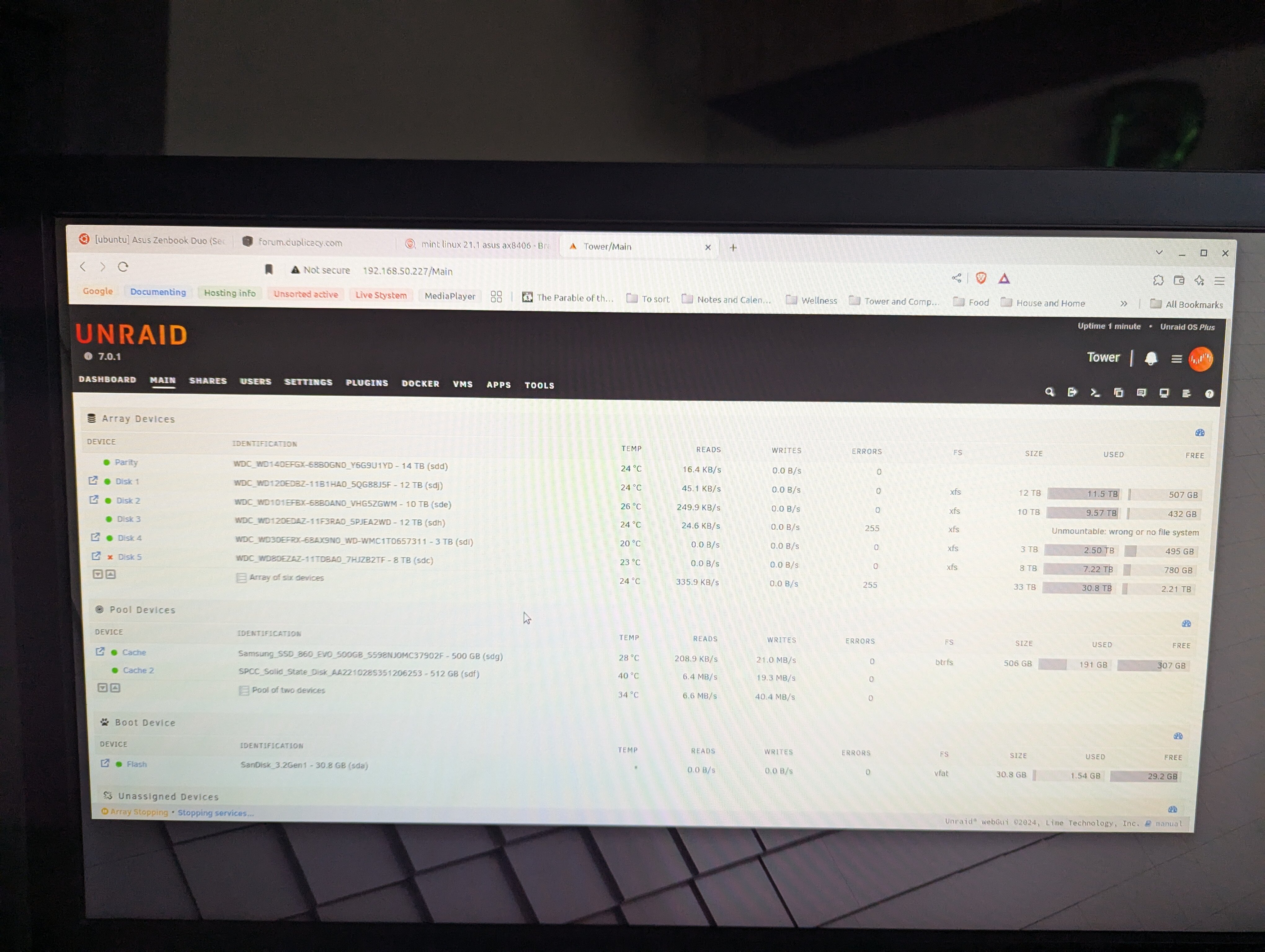

I have a Single parity 5 disk setup with two failed drives. Suggestions on best way forward
This is my first time posting so sorry for any missing info.
I had one 12 TB drive showing read errors and went offline.  I shutdown and changed the cable on the drive and was able to bring it back online.  I ordered a replacement drive just in case. It lasted a day and continued to have read errors so I switched some other cables and best i can tell the one HBA cable was having issues. So i was able to move all drives off that cable.  But in the process of switching those cables i messed up the power connector on a 8 TB  drive that had the 3.3v line taped.  Which gets me to the last state which was the 8 TB offline in emulation mode and the 12 TB listed as unmountable.
I took a picture of the last array setting (to get the drive info) before i removed the drive 3 and 5.  But did not take a final diagnostics at the time.  I did take one a few days before when the first drives started giving errors.  I have attached both.
At this point i shutdown the system re-taped the power on the drive and connected the two drives with errors to an external dock and was able to copy off some files as an extra backup.  I can access the drives fine in the external dock but copying is very slow with the 12TB so i assume it needs to be replaced.
I'm hoping the 8 TB is ok but may be out of sync with parity as it was in emulation mode.  I have a 14TB to replace the 12TB. This is my first time dealing with multiple failures and understand i have made the issue worse by trying to half fix it from what i could read online.
At this point i was hoping to get some advise on the best route forward at this point.  This is a primarily a media server so i would like to restore what i can but everything can be replaced.  I assume the advise would be to bring it online and run a current diagnostic.   Could you please suggest the best steps to get to that ie connect all drive, replace the 12 with tht 14, etc.

Thanks for the quick reply.  I have reconnected the drives and the array came online with disk 5 disabled.

Let me know what you think and what i should try next.
