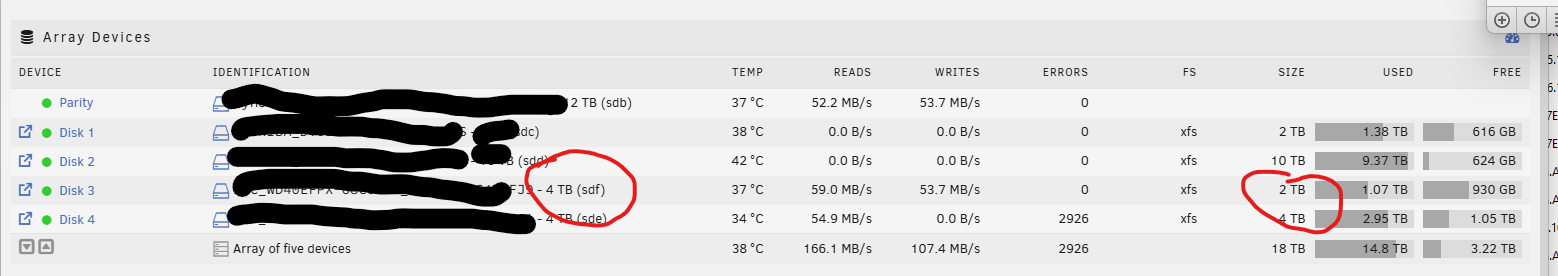

my bad, yes it is, rebuilding disk3, and it faster than my expectation. but my disk replacement is 4TB and it shows capacity 2TB, is that normal?
Once the rebuild finishes, stop and restart the array and post new diags.
