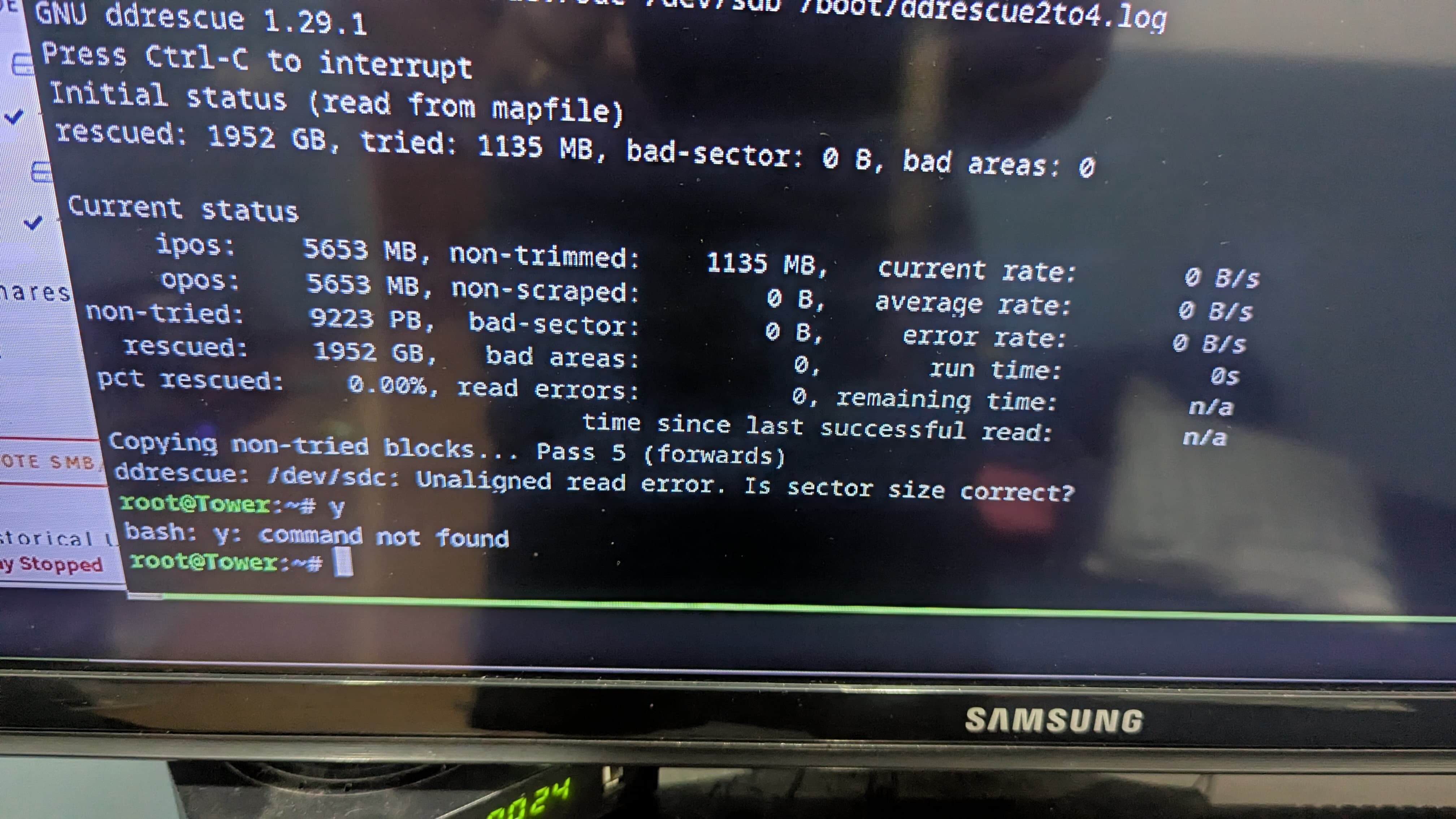

after 7 days ddrescue cloning disk3 there is this notification (4TB to 4TB Drive)..
what should I do or what is the command? ThanksNotifUnaligned.thumb.jpeg.7bc8d6abed6675b93944681d1710f85a.jpeg
Edited by jolma
Looks like that disk is really toast, but you can reboot and try again, if you use the same log file, it will resume.

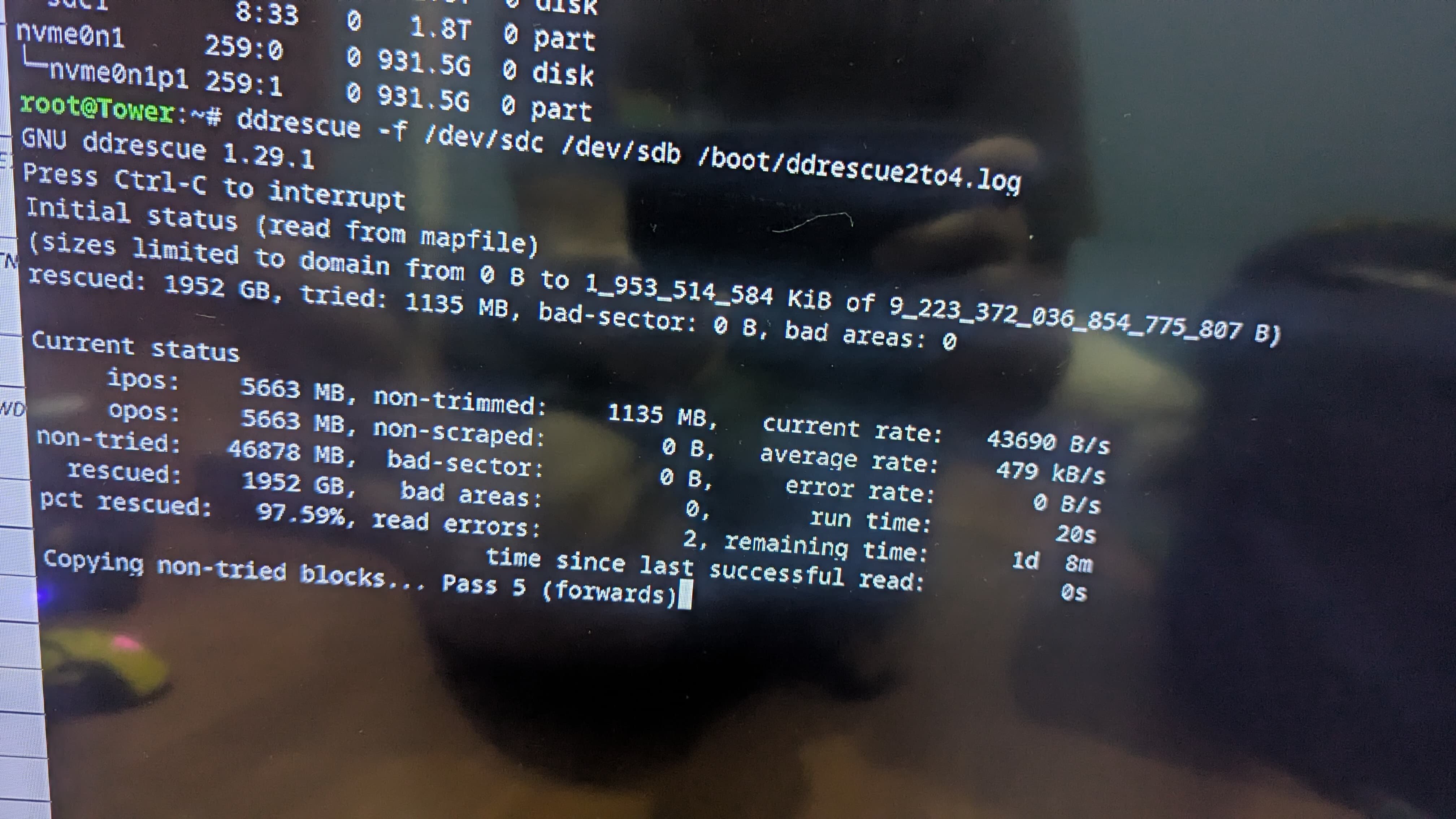

Thank you, I restarted again and the progress resume...

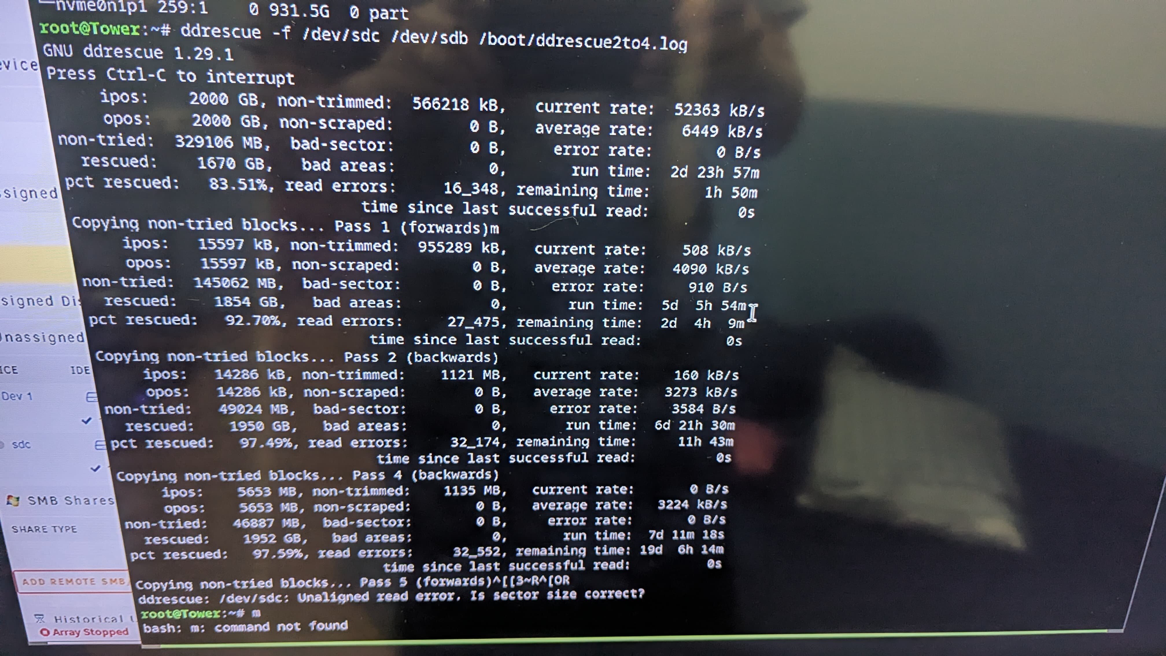

I upload progress from beginning of the ddrescure, and 2nd pic is ddrescue progress now..
Will updated again, Thank you again

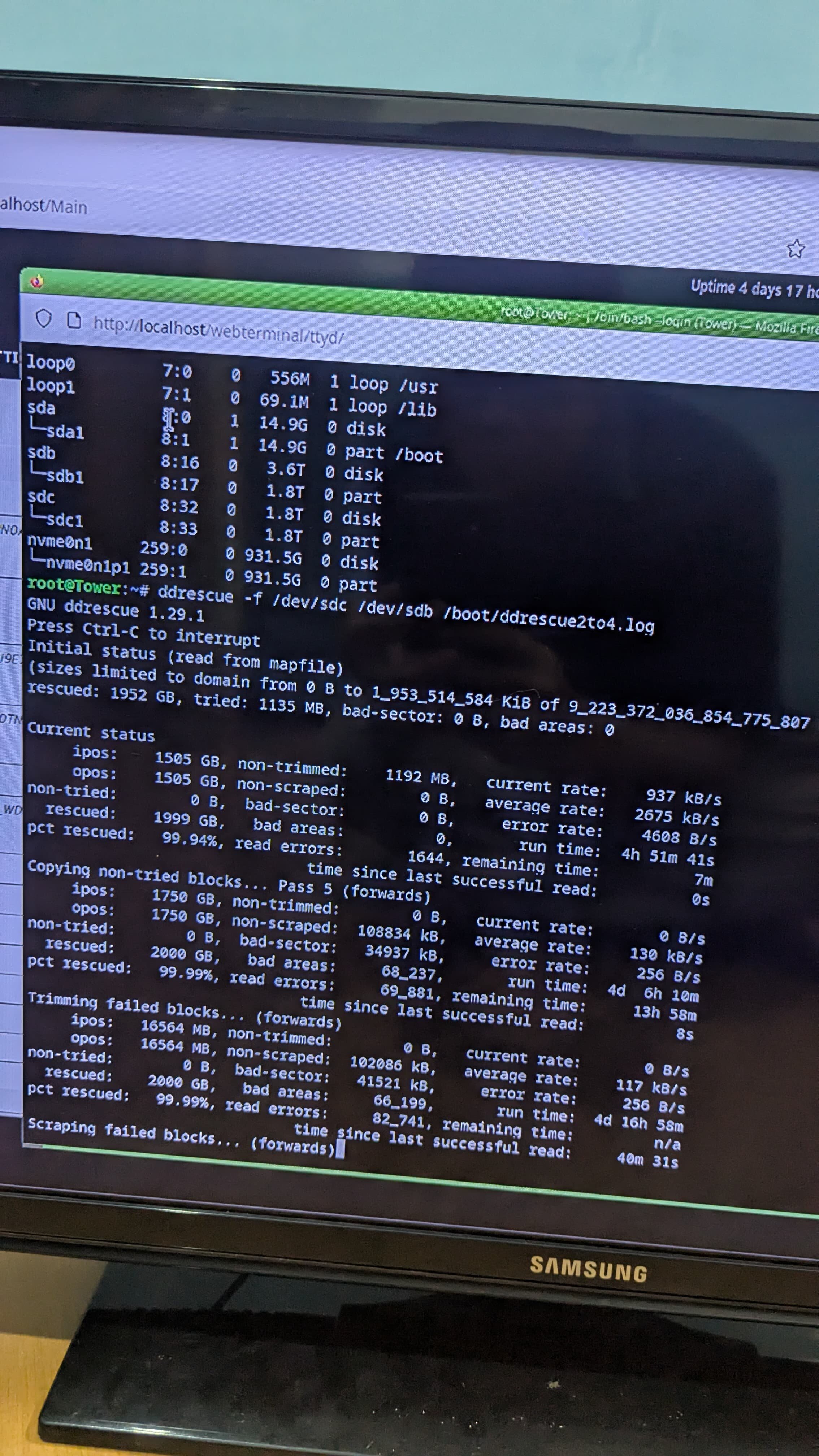

That looks much better, almost 98% recovered, and this includes free space.
while doing cloning, the last successfull read time growing longer...
can i just stop the progress and continue to next step or wait for it to finish?
The last few sectors can take a long time, since it has already recovered 99.99%, you may choose to stop there.
Noted, I'll wait, thanks
