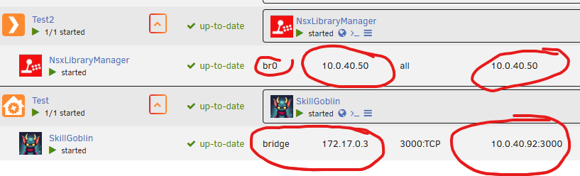

I found I have issue on bridge network and custom network only.

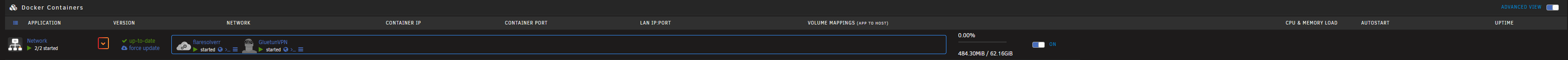

Webui (glob) button of containers from the left side when open folder are working fine only glob button in the  containers and in advanced menus:
Edited by Masterwishx

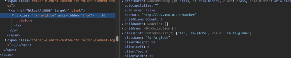

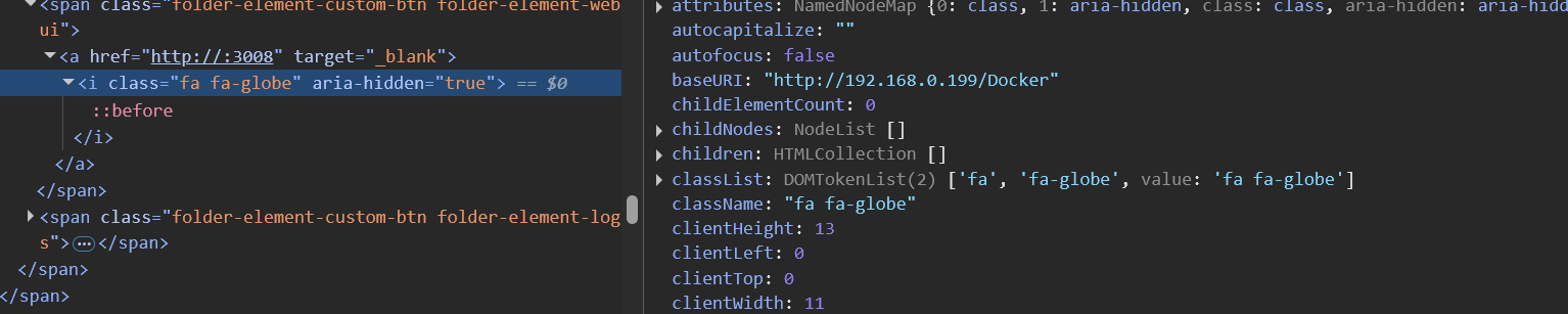

Using customized CSS by @Mattaton also checked without , glob icon seems have a href :
`<a href="http://:3008" target="_blank"><i class="fa fa-globe" aria-hidden="true"></i></a>`

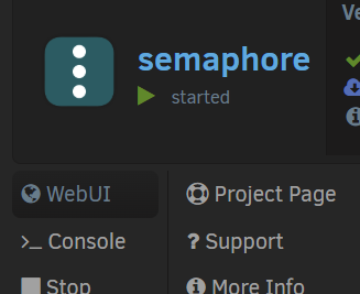

It only doesn't work for me when using the Global Icon here:
The WebUI option in the Docker menu works all the time for me:

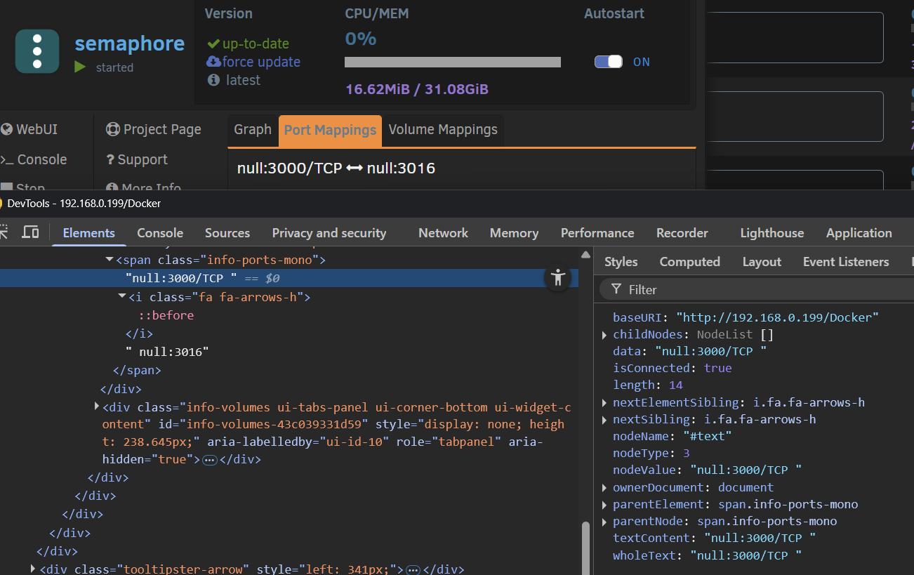

I did notice that if I set my preview context to default, it works, if I use advanced it does not.
I'm working on it with Masterwishx in PMs I'm on to the issue. There is one with the advance context view as you say... it does not show for me at all due to what seems like javescript execution error. And the one in the global icon I think I solved (not released yet, I want to fix both issues first )

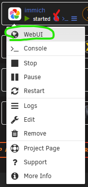

This is how I have to do it since the globe isn't working.

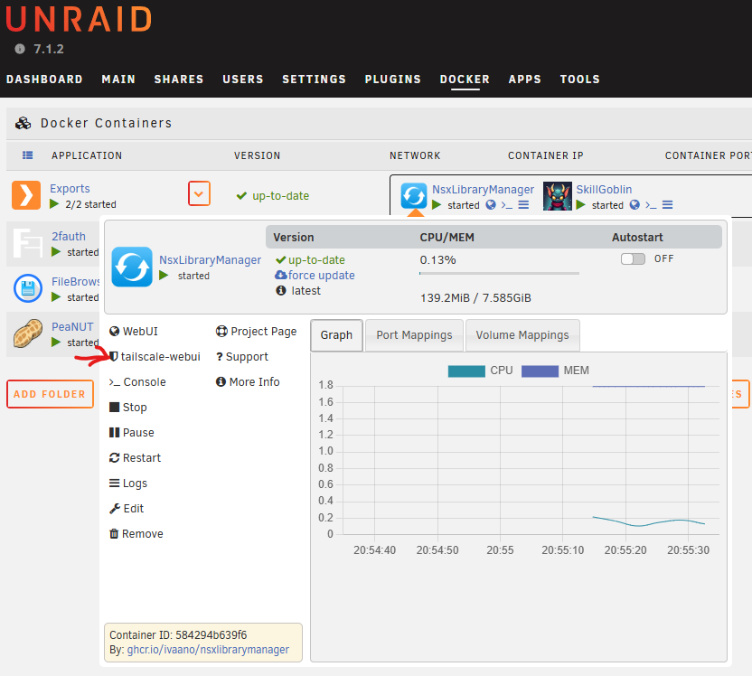

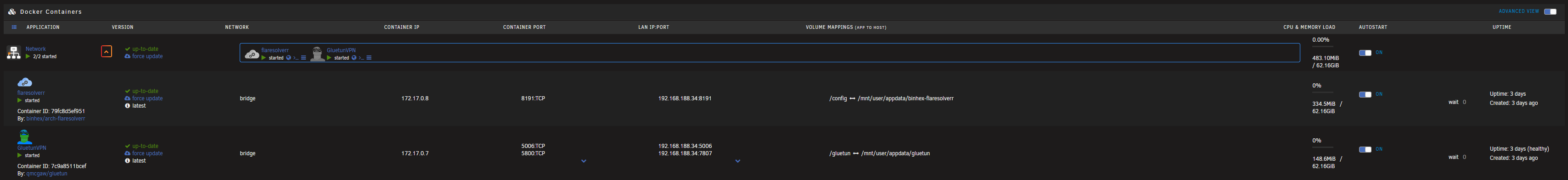

- Advance view was reworked a lot
- Added TailScale link to advanced view ( for some reason the translation is not loaded for it, could be a cache issue... but report back if it does look like this for you and I will have to rework the language/translation part next )
