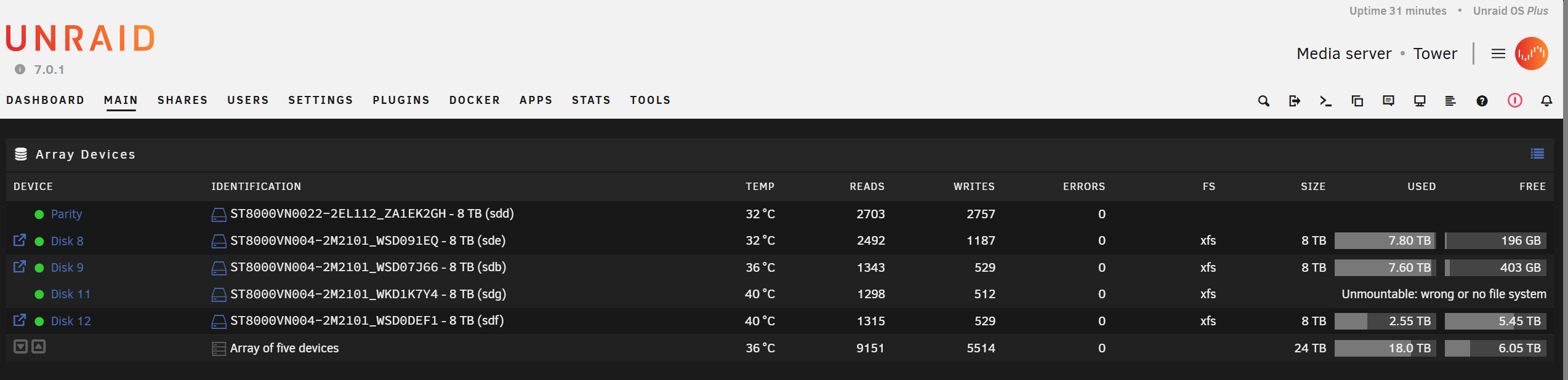

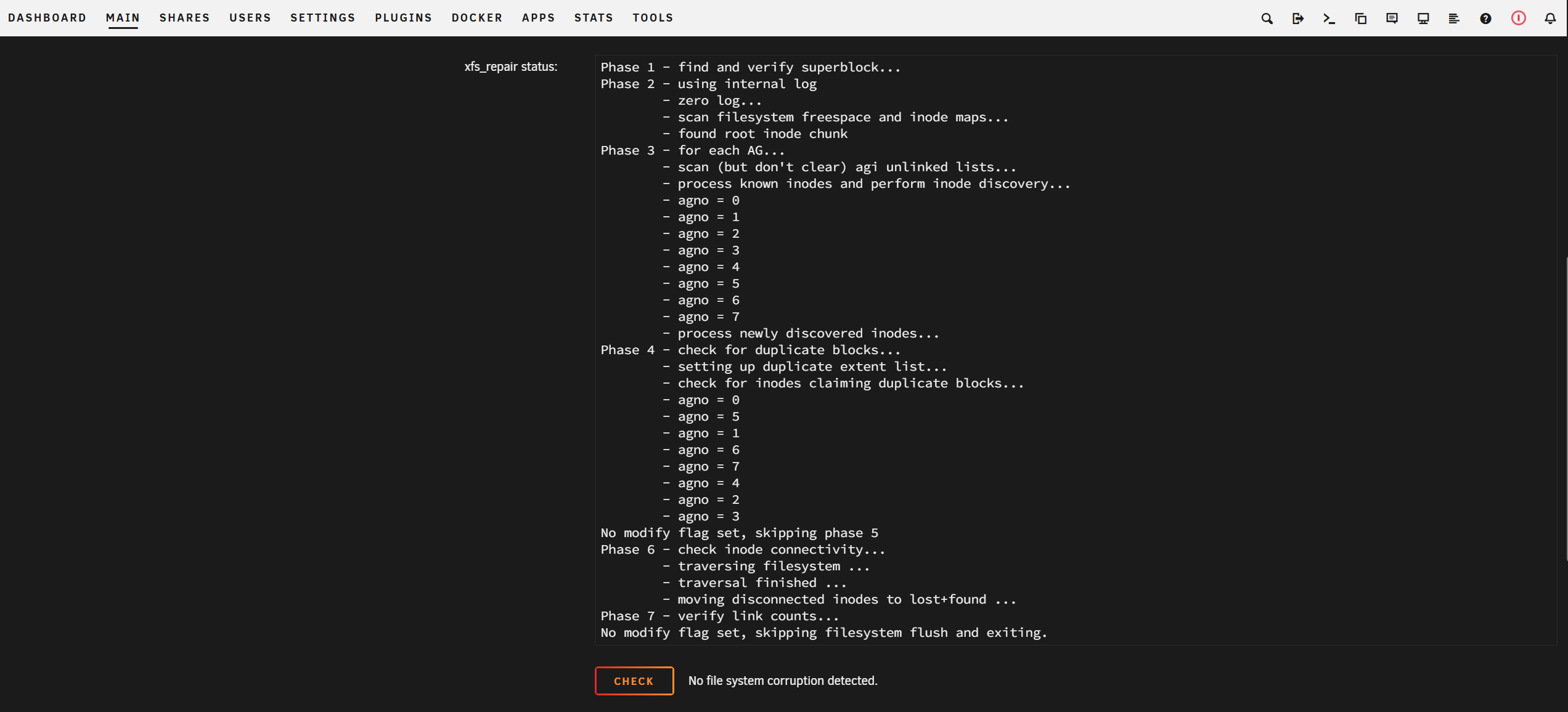

I am also having this problem where the disk shows as unmountable:wrong or no filesystem.
But when I run filecheck it shows no corruption.
Also when in maintenance mode it does not show this error.
Any help would be appreciated
Please post the diagnostics.
There's no attachment, try again.

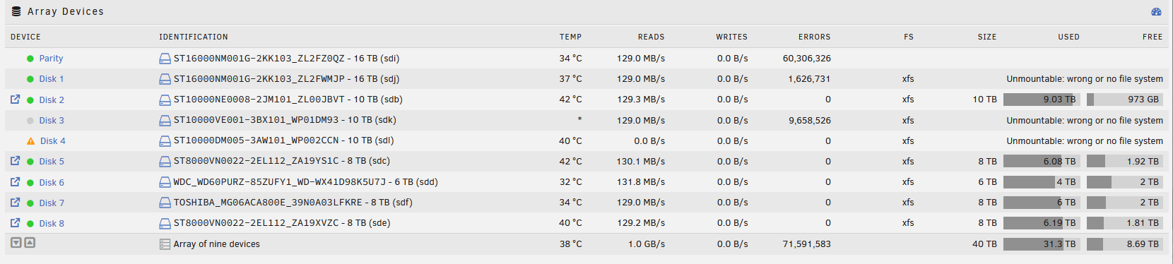

Some not so great news! Got some more errors at random and followed the following process:
"Stop the array, unassign the disk, start the array in maintenance mode, stop it again, reassign the drive to the same slot. The idea is to start the array temporarily with the drive “missing” so it changes from “disabled” to “emulated” status, then to stop it and “replace” the drive to get it back to “active” status."
Like before, however upon restarting the array I had the below:
3 unmountable drives.... currently my server is rebuilding, should I be worried about this? Unfortunately I have to wait 24hours for it to sort itself out before I see how the rebuilding process went.
datavault972-diagnostics-20250523-2047.zip
Rebuilding an unmountable disk will result in an unmountable disk, not much point, and you can destroy the good filesystem, there are errors in multiple disks, check/replace cables for those disks, especially anything they have in common, like a power splitter or miniSAS cable, then post new diags after array start.
Hi @JorgeB sorry I missed your post as I was away and when I had come back (on sunday) my array was fine after letting it rebuild. However now my PArity drive is disabled.
I have tried un-assigning and reassigning the drive while stopping the array but that has not solved the problem. attached are my diags.
datavault972-diagnostics-20250528-1842.zip
You have to unassign, start array, stop array, re-assign, start array.
