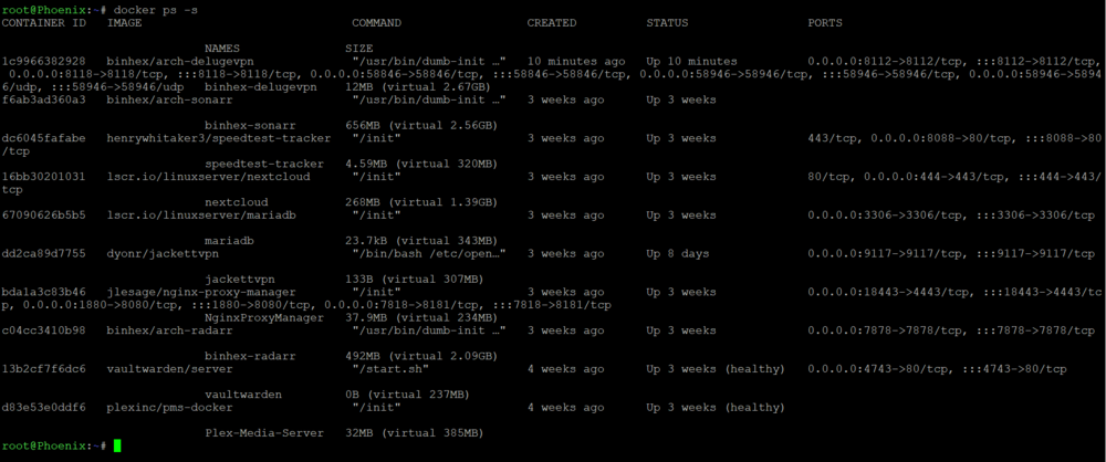

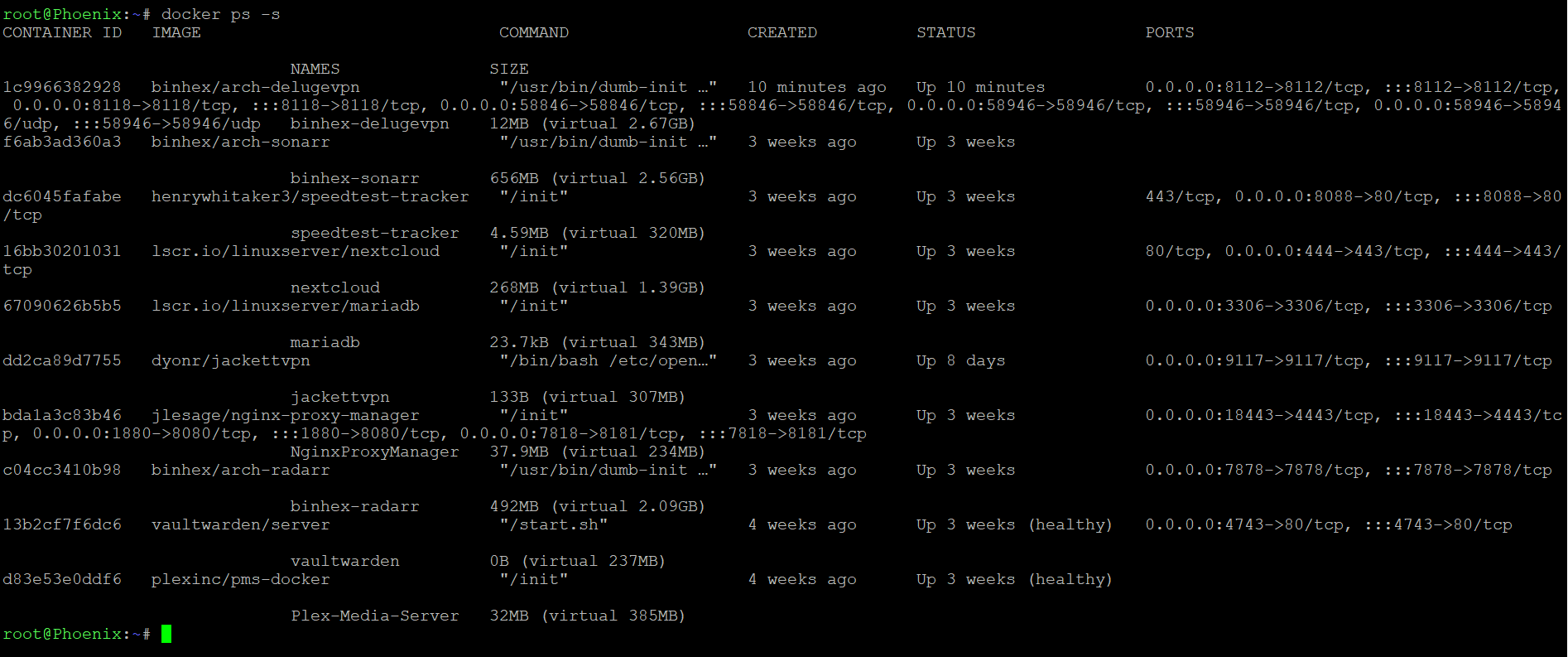

I read that docker ps -s is the best way to get info;

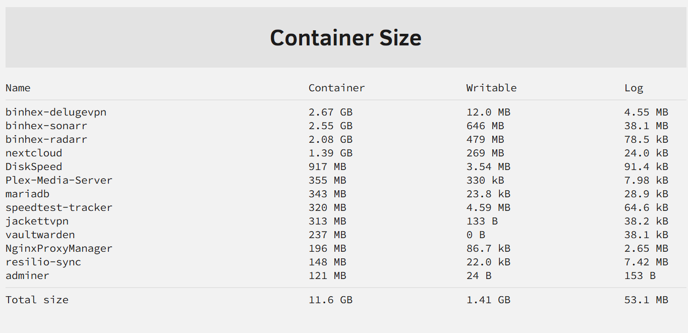

But didnt really know how to interpret this... so, I checked the container size from the docker tab, it shows its 11.5Gb;

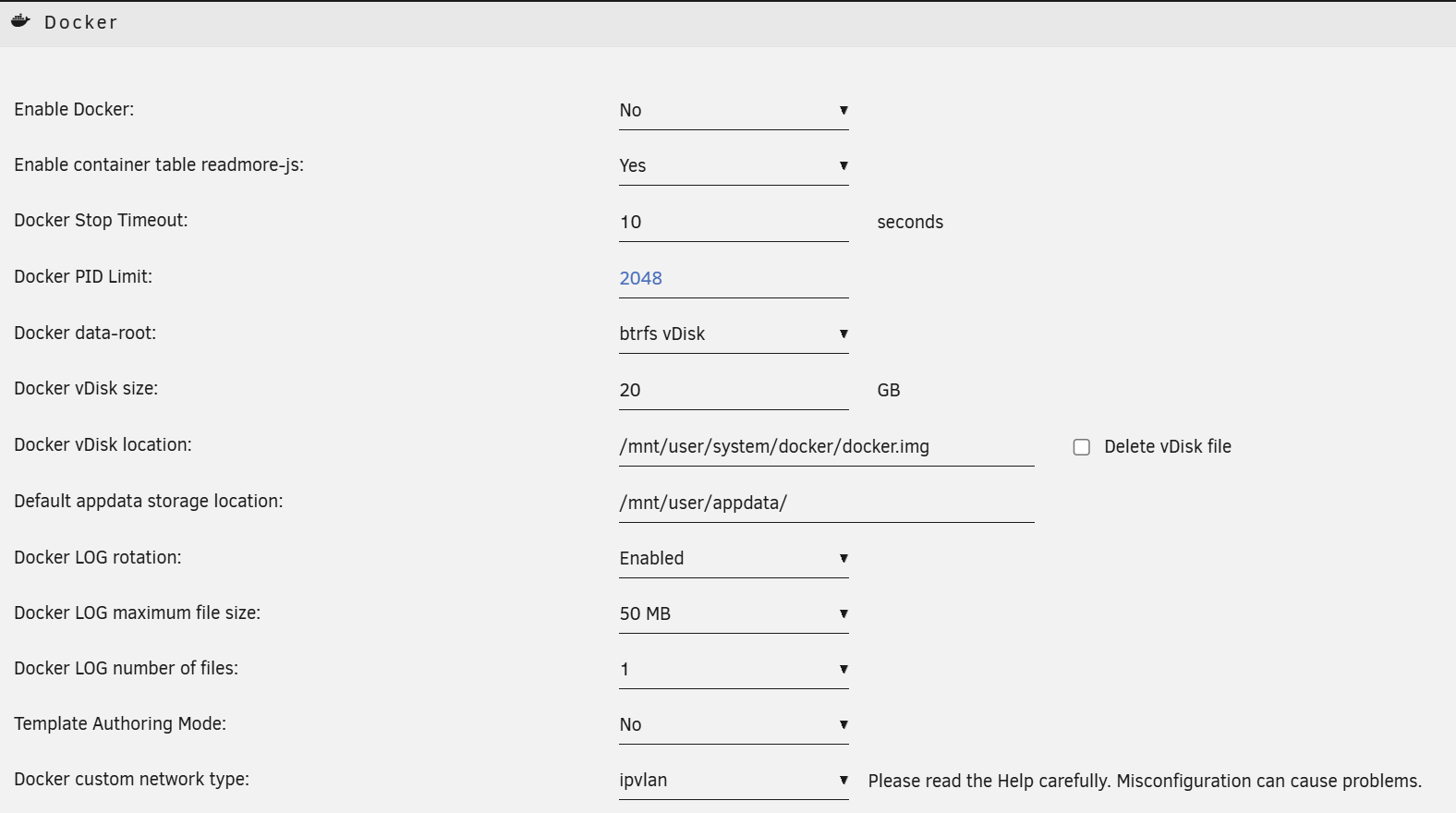

So, having read its meant to be 20Gb, I thought I would stop the docker and increase it - but it shows as 20Gb already...
So where have I lost 9.5Gb?

Most likely in docker images, pull and build taking up space for updates and not having enouth space to complete a existing docker and pull for the same image...
Per picture, You are using a 20 GB vdisk image in total.... That too small for your current work load...
(50 Min thess days...) 100 for log spam and other protections...
SO, You should increase the vdisk size to fix your space issues...

To resolve increase your vdisk docker image...
Stop docker change 20 GB to 50 at least 100 preferred... then turn docker on.
With a few containers it's easy to fill the default 20GB these days. I would increase it by 20GB, not more at a time as too much is just wasted space on your precious SSDs. Also would warn a bit earlier if the image filling up is due to a configuration error.

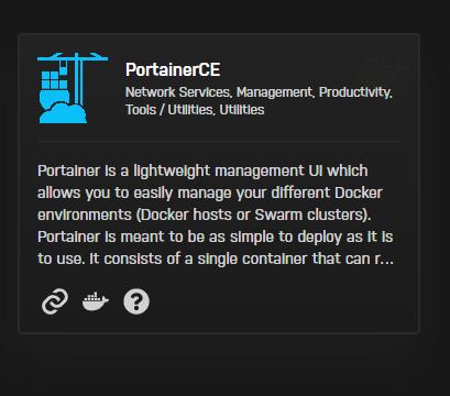

I recommend running portatin and live connect. to seee examples and the adational data.
as example:
I have off and unused dockers that exist this is the temp data that is filling the drive. These commands will delete the Unused images and data.
Similar with docker volumes:
you can install the docker portainer via the CA
this will give you another docker interaction system to help mange and use dockers on unraid. (Especial for those who may be using compose dockers...)

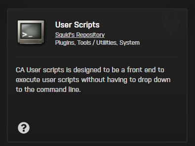

Thanks thats very useful...

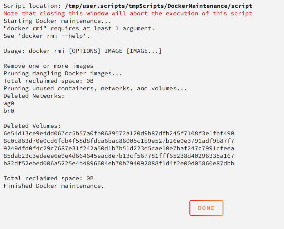

I had completely forgotten about "User Scripts" - so I reinstalled it and added your script;
#!/bin/bash
# Script to prune dangling Docker images and clean up
echo "Starting Docker maintenance..."
#Docker Unraid Check if dangling images exist
docker rmi $(docker images --quiet --filter "dangling=true")
# Prune dangling Docker images
echo "Pruning dangling Docker images..."
docker image prune -f
# Automatically prune unused containers, networks, and volumes
echo "Pruning unused containers, networks, and volumes..."
docker system prune -f --volumes
echo "Finished Docker maintenance."
When it ran, it gave an initial error;
I assume that this actually means that there are no dangling images to delete :)
But says it recovered 0B... so looks like there wasn't any wasted space.

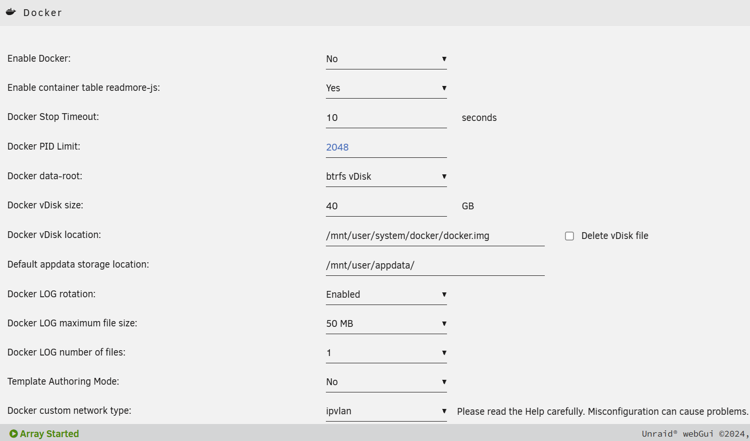

So I will shut down the dockers and increase the docker.img size to 40G to give it enough space to work correctly. If/when I get a 1Tb SSD for the cache drive, I will increase it to 100G.

Exceeding 20GB is not that unusual if you have a lot of docker containers, but if you still run out of space with 40GB I would start suspecting you have some misconfigured containers. You should never need anything like 100GB.

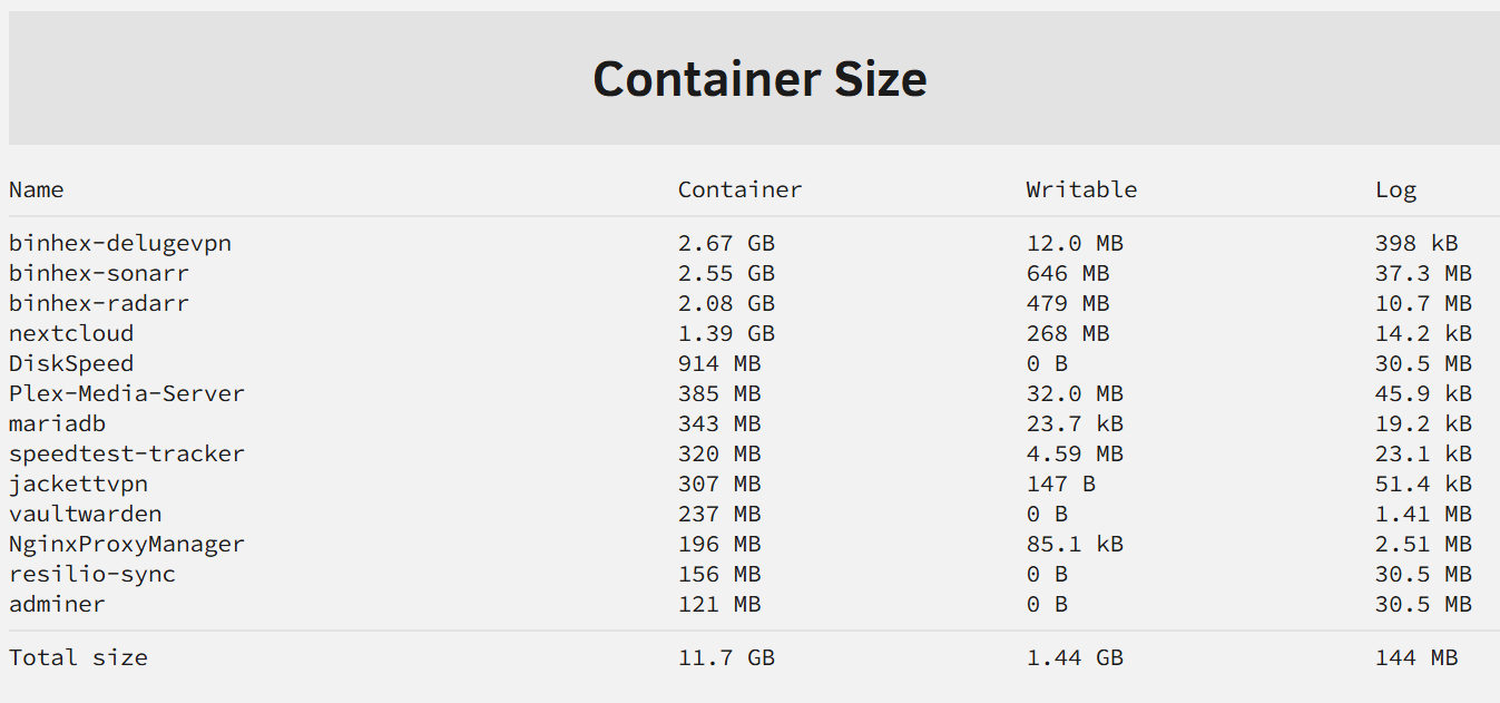

Oddly, have set docker to 40Gb;
Container Size shows;
