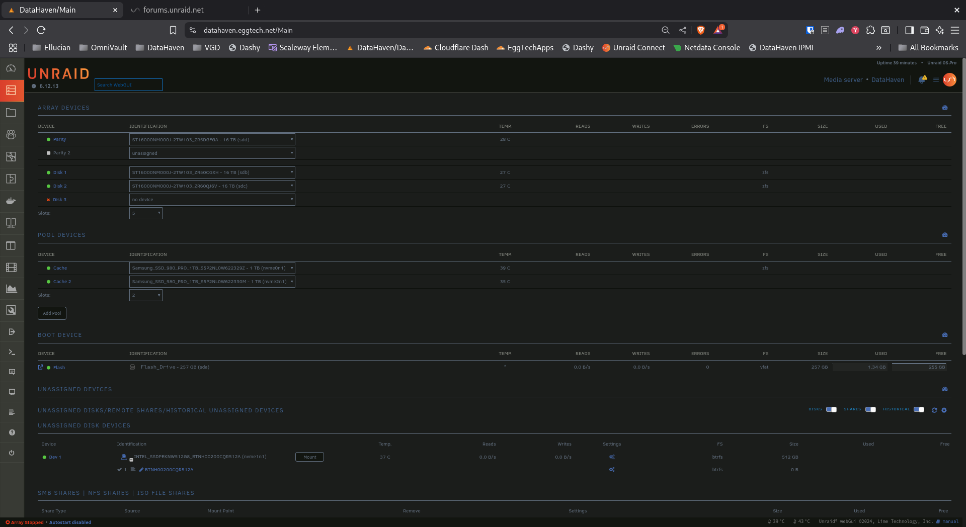

Here's the setup. Disk 3 is the one that i've lost the data on. I've removed it from the server for the time being. Array is stopped. The most I allowed it to "rebuild" the array is ~5%, so I'm hopeful that there is still a significant amount of data remaining hidden on disk 3

with how it is setup in the image above, would I be able to safely let unraid rebuild the array using parity? or would parity have been changed when I formatted disk 3?
