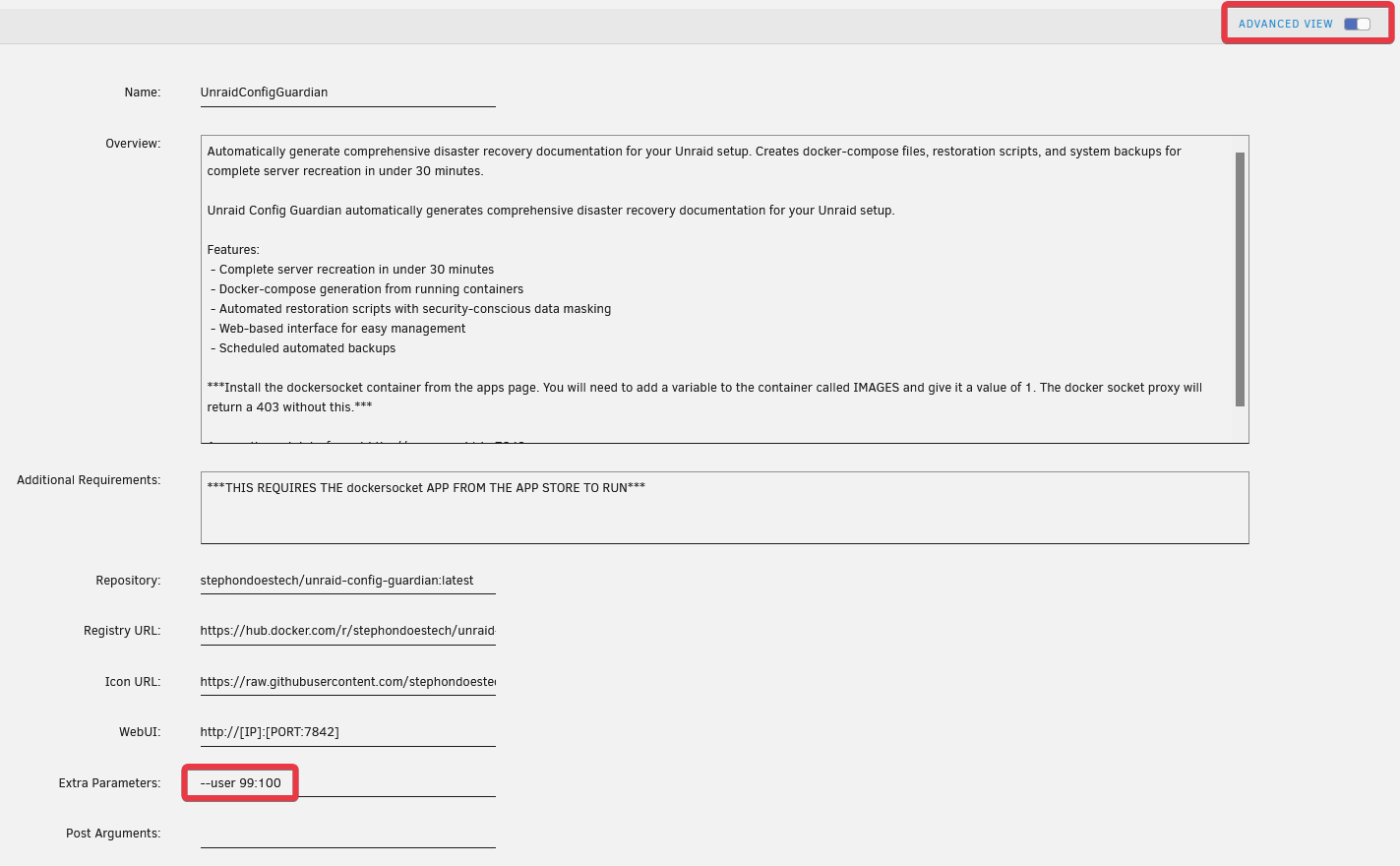

On 9/9/2025 at 1:27 AM, stephondoestech said:
Quick update everyone! I'm still working through all the feedback (damn my pesky day job) and am actively working on making the implementation better. I just pushed version 1.0.4 out to production which does require a manual template update. In hindsight this should've been a minor version bump so I do apologize for that.
In order to have the container not run as root I've implemented the use of docker socket proxy. For this to work you MUST install the dockersocket container from the Apps page. You will need to add a variable to it called IMAGES and set the value to 1.
In the UnraidConfigGuardian container you'll want to remove the docker host path and instead add a variable called DOCKER_HOST and set it to the address of your dockersocket container. This will allow the service to run as a non privileged user while still getting the information it needs for the system. You will also want to update the PUID and PGID to 99 and 100 respectively. Lastly the container port needs to be updated to 7842as the previous value was causing an issue in the template validator.
Thank you again everyone for the continued feedback. I'm excited to keep working on this project and making it more useful with each update.
@Krakout Please confirm if you followed these steps.
I also saw random (test/example?) containers until I followed these steps and it read my actual system.

I'm having the exact same issue. I verified that destination directory has 777 permissions and also verified in the Docker socket container logs that it is receiving calls from the Unraid Config Guardian Webui.
Please follow these steps, I have found that deleting the /output and creating a new folder work.
it should no longer be neccesary to do the chmod777 after patch 1.05
I must be losing it. I tried deleting /output thru unraid cmd line and it still gives an error. I tried deleting in the docker and it I get permission denied.
@Zak501 How did you do it?
Hi @mrglass
Sorry comment should have been clearer.
If you look at the docker container config "Output Directory:" which has a description of "/ouput" the default directory is an an Appdata location. and but most people change to a share where their other backups is located.
Mine is "/mnt/disk2/veeam/unraid_config-guardian/"
I renamed the "unraid_config-guardian" part to unraid_config-guardian.OLD.
a this stage it should create a new folder when run the tool again or you can manually create the folder.
Since I have this share mounted in windows I just created a new folder like that but I also tested and confirmed creating folder via the unraid GUI or running "mkdir unraid_config-guardian" works just as well.
I've remade the folder every which way too. I'm still getting permission errors. The original two builds of this worked fine. Even with manually changing the permissions, I still can't get it to work.

I am not the Dev, just another user try to assist my fellow my with what has worked for me.
This was quite the conundrum for me as well.
  1. 1) The docker socket (Ibracorp worked best for me) and unraid guardiuan must be on the same network,
    • in case your using a custom network the docker socket will not get an <local-IP><port> like your other dockers.
    • Use the 172 generated.
  2. Go back to page one and make all the specified changes wit regard to the images changes in the docker socket
  4. Make a new directory where your should be and the point the docker there
  5. look at the logs of the docker socket and unraid guardian when starting up the 1st time.
    • Right below the restart option is the logs option please click that and see what errors are show.
  6. Please post a logs output so we can better assist and help you with this issue.

i still cant get passed this error
Last backup failed: [Errno 1] Operation not permitted: '/output'
I’ve done everything stated in this thread to end up with the same error. No matter what. And the logs say nothing about errors
After fiddling around it seems that the container isn't respecting the PUID and PGID variables:
If you add the following to the extra parameters it seems to run fine: --user 99:100
This fixed my issues, thank you!
