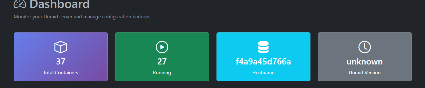

1 minute ago, dernick79 said:
ok, thanks a lot!. It was my mistake, and I found it! but the problem with the unknown unraid version and hostname is still alive...
Yes, This is an issue the DEV still needs to solve, I am not the Dev.
I know;) but again, thanks a lot!!

Hey everyone! Quick heads up I'm aware that the hostname and version are still not appearing correctly in addition to the templates zip not being generated. This is due to Unraid requiring root access to the boot drive to get this information. I'm in the middle of fix now that I should be able to roll out today, but please know I'm working hard to resolve this. The biggest challenge is balancing security vs functionality. I really don't want this running as root.
WHELP...that was short lived. Thanks to user reporting and testing I was able to find a fix that revealed another issue with the cached data. Docker pipeline is building now to roll that out.

Im running rwo servers. One is v1.1 and nil issues. The other I forced update to V1.2.2 and just will not backup. Have tried pointing to dockersoet IP rather than dockersocket:2375.
V1.2.2 does not show unraid version

I removed --user 99:100 from extra parameters. First backup worked, subsequent failed. Same as Scridgeon's description.
Also version and host name now working
