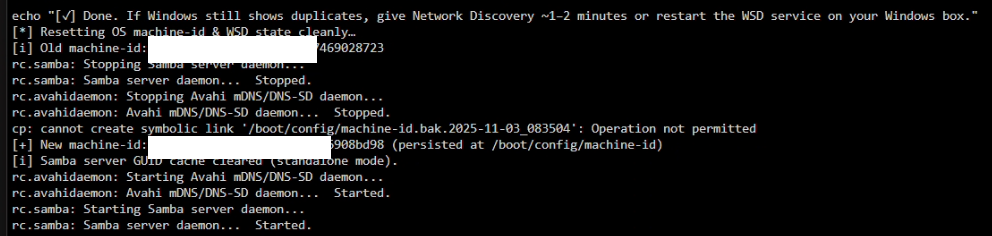

heres a script you can try to purge the machine ID form the system...
on Unraid (Slackware-based, no systemd), the “machine-id” that a bunch of stuff (dbus, wsdd/wsdd2, sometimes Samba helpers) keys off of can live in /etc/machine-id and/or /var/lib/dbus/machine-id. On Unraid the rootfs is RAM, so you’ll want to regenerate once and persist it on the flash drive, then symlink both locations to that single persistent file.
User script plugin:
Below is a safe, copy-paste script that:
  • stops Samba/WSD/Avahi if present,
  • backs up any existing IDs,
  • deletes all machine-id copies,
  • creates a fresh ID (persisted at /boot/config/machine-id),
  • symlinks /etc/machine-id and /var/lib/dbus/machine-id to it,
  • clears common wsdd/wsdd2 state files,
  • (optionally) clears Samba’s server GUID cache if you’re not domain-joined,
  • restarts services,
  • shows you the new ID.
One-shot fix (run as root in the Unraid console/SSH)
#!/bin/bash
set -Eeuo pipefail
export PATH="/usr/sbin:/usr/bin:/sbin:/bin:/usr/local/sbin:/usr/local/bin"
# ===== Settings you can tweak =====
PERSIST_FILE="/boot/config/machine-id"    # where the stable ID will live
RESET_SAMBA_GUID="auto"                   # "yes" | "no" | "auto" (auto = only if not domain-joined)
echo "[*] Resetting OS machine-id & WSD state cleanly…"
# Discover current ID (if any)
OLD_ID="$( (cat /etc/machine-id 2>/dev/null || cat /var/lib/dbus/machine-id 2>/dev/null || true) \
          | head -n1 | tr -d '[:space:]' || true )"
[[ -n "${OLD_ID:-}" ]] && echo "[i] Old machine-id: $OLD_ID" || echo "[i] No existing machine-id detected."
# Stop network announce bits if present
[[ -x /etc/rc.d/rc.samba ]] && /etc/rc.d/rc.samba stop || true
pkill -f 'wsdd2' 2>/dev/null || true
pkill -f 'wsdd'  2>/dev/null || true
[[ -x /etc/rc.d/rc.avahidaemon ]] && /etc/rc.d/rc.avahidaemon stop || true
[[ -x /etc/rc.d/rc.avahi-daemon ]] && /etc/rc.d/rc.avahi-daemon stop || true
# Backups (to flash so they survive reboot)
ts="$(date +%F_%H%M%S)"
for f in /etc/machine-id /var/lib/dbus/machine-id; do
  [[ -s "$f" ]] && cp -a "$f" "/boot/config/$(basename "$f").bak.$ts" || true
done
# Remove all copies/symlinks of machine-id
rm -f /etc/machine-id /var/lib/dbus/machine-id
# Create a fresh, persistent ID on the flash and link both locations to it
mkdir -p /boot/config
dbus-uuidgen > "$PERSIST_FILE"
chmod 0644 "$PERSIST_FILE"
mkdir -p /var/lib/dbus
ln -sf "$PERSIST_FILE" /etc/machine-id
ln -sf "$PERSIST_FILE" /var/lib/dbus/machine-id
NEW_ID="$(cat "$PERSIST_FILE")"
echo "[+] New machine-id: $NEW_ID (persisted at $PERSIST_FILE)"
# WSD/WSDD/WSDD2: nuke any saved UUID/state files if the plugin left them around
for d in /var/lib/wsdd* /var/run/wsdd* /etc/wsdd* /var/lib/wsdd2* /var/run/wsdd2* /etc/wsdd2*; do
  [[ -d "$d" ]] || continue
  find "$d" -maxdepth 1 -type f -regextype posix-extended \
    -regex '.*(uuid|state|machine).*' -print -delete || true
done
# Optionally clear Samba GUID cache (NOT if domain-joined)
should_reset_guid="no"
if [[ "$RESET_SAMBA_GUID" == "yes" ]]; then
  should_reset_guid="yes"
elif [[ "$RESET_SAMBA_GUID" == "auto" ]]; then
  if ! net ads status >/dev/null 2>&1 && ! net rpc info >/dev/null 2>&1; then
  fi
fi
if [[ "$should_reset_guid" == "yes" ]]; then
  # These files may or may not exist on Unraid; removing them is safe for standalone workgroups.
  rm -f /var/lib/samba/server_guid.tdb /var/lib/samba/serverid.tdb 2>/dev/null || true
  echo "[i] Samba server GUID cache cleared (standalone mode)."
else
  echo "[i] Skipped Samba server GUID reset (domain-joined or disabled)."
fi
# Bring services back
[[ -x /etc/rc.d/rc.avahidaemon ]] && /etc/rc.d/rc.avahidaemon start || true
[[ -x /etc/rc.d/rc.avahi-daemon ]] && /etc/rc.d/rc.avahi-daemon start || true
[[ -x /etc/rc.d/rc.samba ]] && /etc/rc.d/rc.samba start || true
# If wsdd/wsdd2 doesn’t auto-spawn via the Unraid plugin, try to launch it (best-effort)
command -v wsdd2 >/dev/null 2>&1 && wsdd2 -t >/dev/null 2>&1 || true
command -v wsdd  >/dev/null 2>&1 && wsdd  -t >/dev/null 2>&1 || true
echo "[✓] Done. If Windows still shows duplicates, give Network Discovery ~1–2 minutes or restart the WSD service on your Windows box."
Make it survive reboots (add to /boot/config/go)
Unraid’s OS reloads in RAM, so make sure the same ID is re-applied early on every boot. Append this snippet to the end of /boot/config/go:
# ---- persist a stable machine-id across boots ----
if [[ ! -s /boot/config/machine-id ]]; then
  dbus-uuidgen > /boot/config/machine-id
fi
ln -sf /boot/config/machine-id /etc/machine-id
ln -sf /boot/config/machine-id /var/lib/dbus/machine-id
(Optional) Hunt down old occurrences of the stale ID
If your /etc/machine-id looked like a “long list” (multiple lines got appended over time), you can purge any places that cached one of those old values:
OLD="$(sed -n '1p' /boot/config/machine-id.bak.* 2>/dev/null | tr -d '[:space:]' | head -n1)"
[[ -n "$OLD" ]] && grep -R --binary-files=without-match -n "$OLD" \
  /etc /var/lib/samba /boot/config /usr/local/emhttp 2>/dev/null | head -n 50
If anything pops up in Samba tdb/registry files and you are not AD-joined, stopping Samba and removing those tdbs (as the script does) is fine—Samba will recreate them.
If you want, tell me what you see for:
ls -l /etc/machine-id /var/lib/dbus/machine-id
pgrep -af 'wsdd|wsdd2'
testparm -s | head -n 1
as you may be fighitng internal samba database and netbios settings... I personly don't like nor use WSD. But I'm also capable of runnign my own smb conf... windwos lately has be disgure in the name of security breaking and destroying how widnows uses samba and conects to shares...
