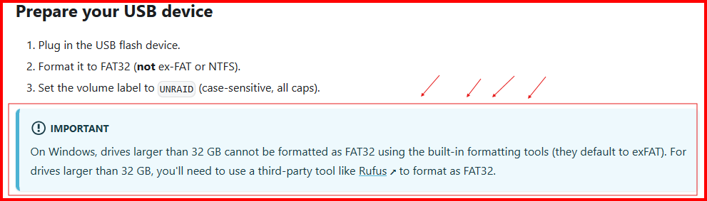

November 17, 2025Nov 17 8 minutes ago, Durgesh said:installed trial version on SanDisk Ultra Flair 64GB mannually.Did you note this restriction on Formatting your 64Gb flash drive:If the trial version is working on your flash drive, then your purchased license should work properly. (I have never heard of an instance where this is not the case.)

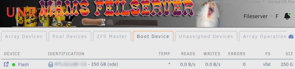

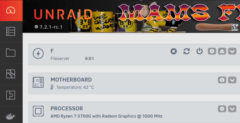

November 17, 2025Nov 17 53 minutes ago, Frank1940 said:Did you note this restriction on Formatting your 64Gb flash drive:This restriction does not exist anymore on recent windows 11 versions.But of course, using FAT with such sizes is a waste of space because a cluster (the smallest disk part a file can use) grows ridiculously large.(exFAT does not make it better)But, as you can see, it works Edited November 17, 2025Nov 17 by MAM59
