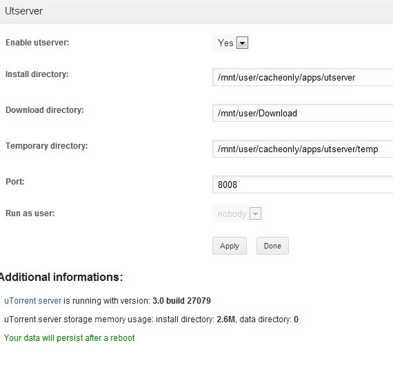

Installed and enabled in Utserver settings page but I am unable to bring up the GUI.  Configured install/temp directory on cache-only user share.  Tried default 8003 port and 8008 port.  http://tower:8003/gui  unable to connect.  utserver.log attached but looks normal i believe.
Any advice?

uTorrent must have been installed, there wouldn't be log file otherwise. Show us a screenshot of utorrent settings page. Also let us see utserver.conf in installation directory. Try to access it by IP like http://192.168.1.254:8003/gui
Thank you for the response.  Attached is a config screenshot and utserver.conf
Accessing via IP had the same result.

EDIT: I just did a fresh unRaid setup (5.0-rc5) and installed just utserver plugin on its own and it works fine. That means it doesn't require any dependencies. Please delete all files and directories associated with utserver, restart yout server and reinstall plugin. Don't precreate any directories prior to installation, or if you do - check permissions for nobody:users. Try placing utserver and temp directly on cache drive (in your case /mnt/cache/cacheonly/apps/utserver), creation of 'cache only' share is a way to prevent mover script from transferring it onto the array, and avoid trick with dotted dorectory (like /.apps).
Last thing - what version of unRaid are you running?
Out of town for a few days and finally had some time to mess with this.  I am still running rc3.  Deleting all files/directories, restarting server, and re-installing plugin did the trick.
The only difference I could identify was your suggestion of not precreating directories prior to install.  I did indeed precreate the directories previously and did not think to check permissions.
Thank you for all the input and work on this plugin!

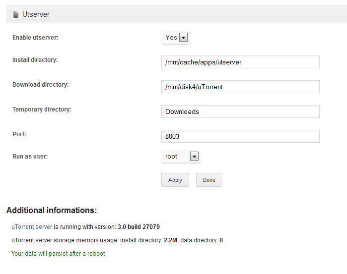

HI

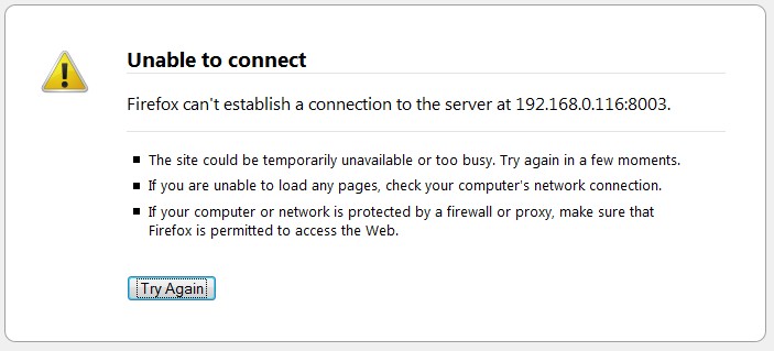

I installed the plug in. Seems to be installed correct. But when I call the GUI page from browser I get unable to connect.
image attached ... please guide ....
Regards
Sammy
You need to set Temporary directory. Placing it on cache (if you have it) is recommended.
