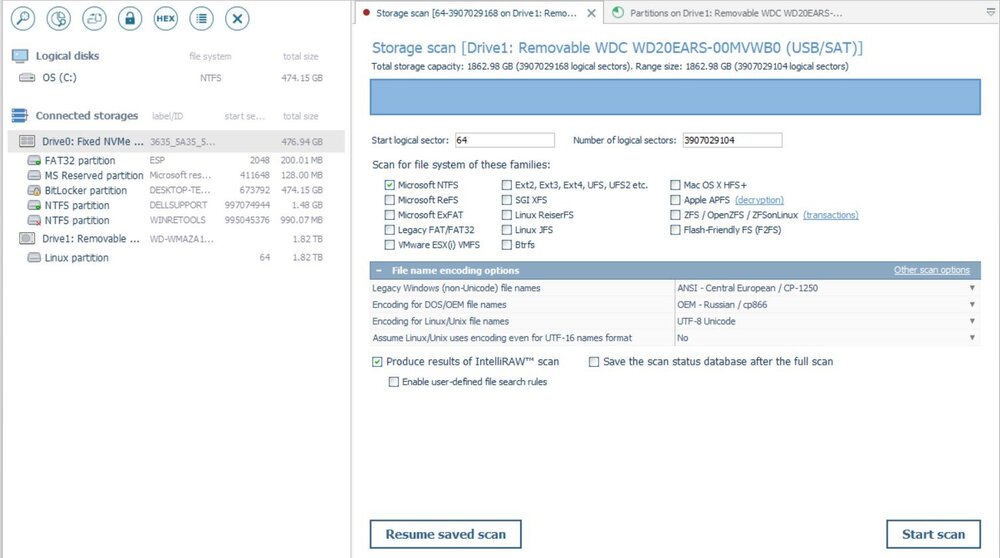

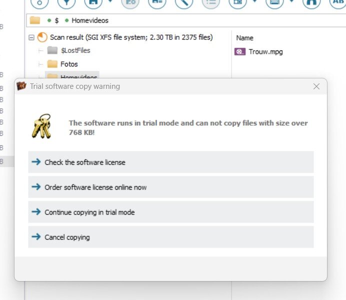

  • Since the disk itself appears to be completely dead, copy what you can from the emulated disk. For this one, if xfs_repair cannot fix the filesystem, you can try a file recovery app like UFS Explorer

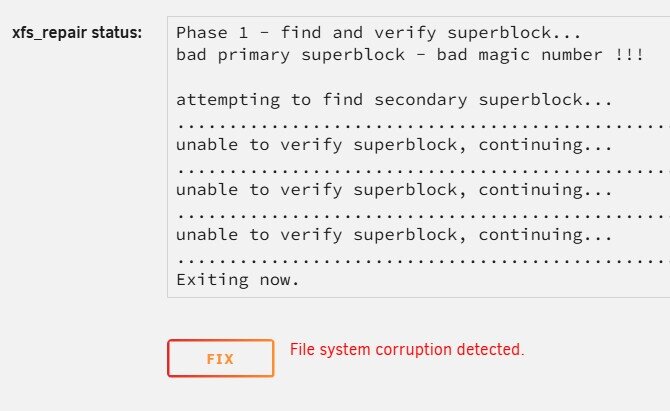

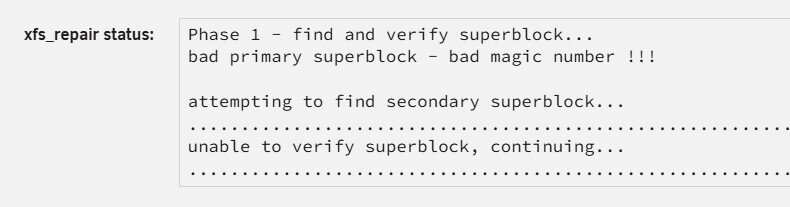

Just swapping disk positions should not touch the file system unless there's some hardware issue. Post the output from blkid
How do i do that?
Open a terminal window and type that command there.
/dev/sdb1: UUID="f06fa2e2-8ed9-4012-9f84-3a629409af03" BLOCK_SIZE="512" TYPE="xfs"
/dev/sdg1: LABEL_FATBOOT="UNRAID" LABEL="UNRAID" UUID="1C0C-2164" BLOCK_SIZE="512" TYPE="vfat" PARTUUID="852ef2e8-01"
/dev/loop1: BLOCK_SIZE="131072" TYPE="squashfs"
/dev/md5p1: UUID="f9c9f6d5-b6c5-4f30-9940-bcec0f9143b6" BLOCK_SIZE="512" TYPE="xfs"
/dev/md1p1: UUID="40e27459-87d8-45ae-ba69-4b42504c6840" BLOCK_SIZE="512" TYPE="xfs"
/dev/loop2: UUID="c15c6455-4916-4e19-aa2c-f6e9865e0031" UUID_SUB="f16c39c7-751a-48d7-a6ae-fdfabca2bfbc" BLOCK_SIZE="4096" TYPE="btrfs"
/dev/md4p1: UUID="2eb085d7-0d56-447a-a388-1f73133ce6ba" BLOCK_SIZE="512" TYPE="xfs"
/dev/loop0: BLOCK_SIZE="131072" TYPE="squashfs"
/dev/md3p1: UUID="aebef0ed-4a59-4526-898f-d74b09a7458b" BLOCK_SIZE="512" TYPE="xfs"
/dev/sdh1: UUID="c1b70e10-2cd4-41ab-b2bc-997b1f9b5862" BLOCK_SIZE="512" TYPE="xfs" PARTUUID="4d372051-1f45-49d7-8954-1474c74a63a5"
/dev/md6p1: UUID="6fdf01e6-c939-4121-8f77-bb4083cae402" BLOCK_SIZE="512" TYPE="xfs"
Disk2 is not showing a filesystem signature, and it has pending sectors, so it could be failing. Run an extended SMART test and post the results.

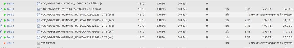

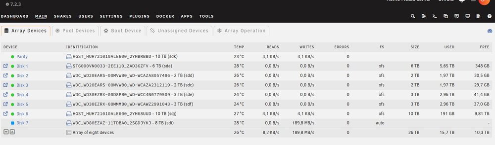

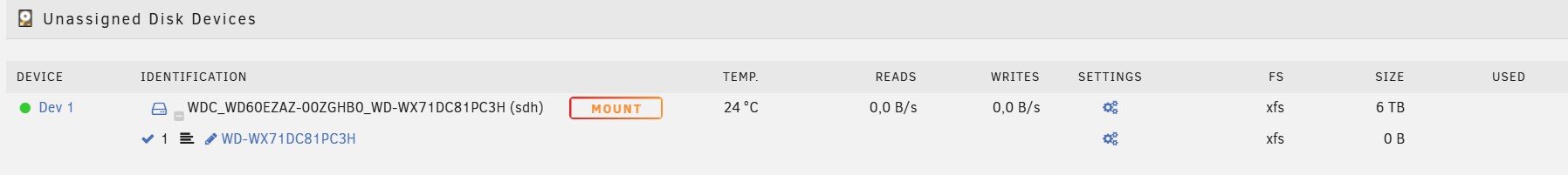

Heres the situation
I got one 8tb parity
I got 2 disks failing
[url=https://ibb.co/1G5LFzF5][img]https://i.ibb.co/4RG7h1hG/1.jpg[/img][/url]
disk 7 is popping as unassigned, but i cant chose to assign
[url=https://ibb.co/Kj5p3pvr][img]https://i.ibb.co/99pkCk5r/2.jpg[/img][/url]
I can live with losing data on disk 2 (2tb)
I cannot live with losing data on disk 7 (6tb)
I would prefer losing no data
Today , 2x10tb disks are coming in so i can replace.
What do i do in what way? extended smart tests are running for both disks. Or do i need to buy another 6tb disk to save the data on disk 7 ?????????

Those images are not working for me, you can attach any images directly to the forum
ok here are the images
I found another 2 tb spare disk, though i'm not sure if it still works.
What can i do now, knowing i have a spare 2tb disks (not sure working), 2x10TB coming in today... and free hot swappable bays
2x smart reports still running
Should i be able to save disk 7 (6tb) or should i get another 6 tb drive...
Edited by skank
If xfs_repair can't repair the filesystem, rebuilding the disks won't fix that. Once the SMART test finishes, reboot to clear the logs and post a new diags after array start.
