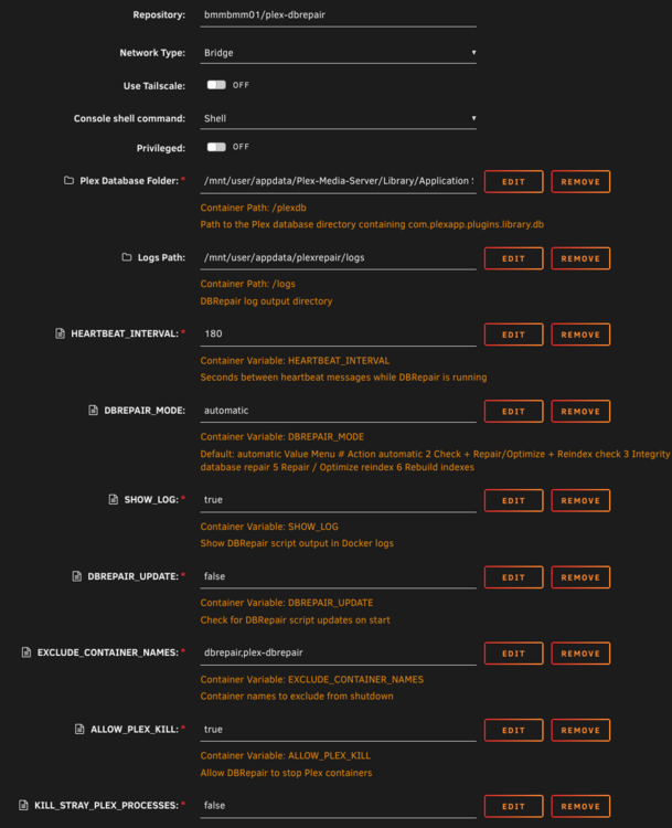

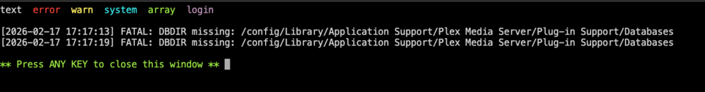

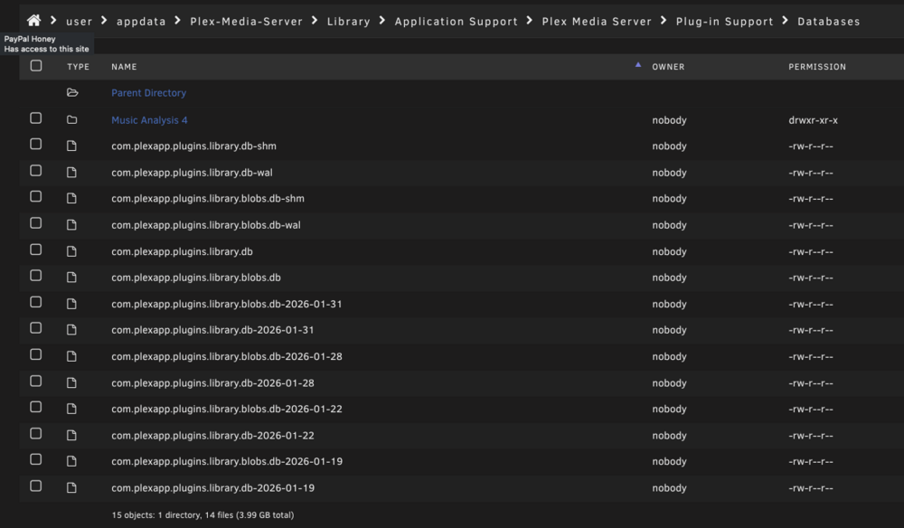

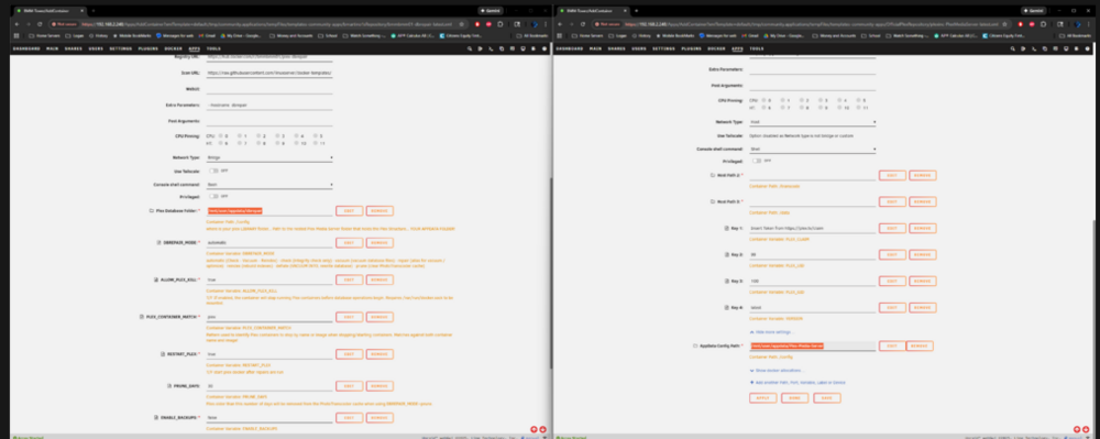

I keep getting the fatal error despite it seemingly being set up correctly. I pointed the Plex Database Folder to the correct path but I still keep getting the error. Im probably missing something, but I dont know what it is. Anyone?

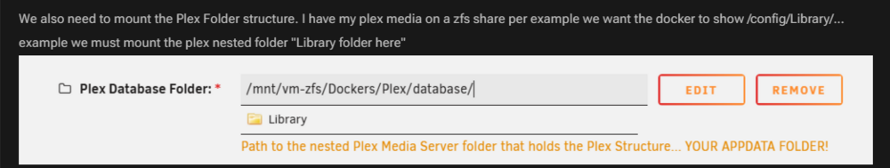

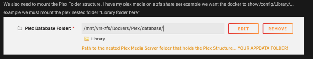

1st post picture your too far deep you need to mount
/mnt/user/appdata/Plex-Media-Server
As the Libray folder need shown... this should be the same as your appdata folder...
https://forums.unraid.net/topic/196453-support-plex-db-repair-docker/#findComment-1601211
This is the only thing that needs set to run... the continer will then see /config/Library
and things will work as intended...
Its the only data I don't have that the end users must set. as you can see my appdata for plex is different and each docker is different for appdata...
my scirpt will traverse into the databse folder folwing default folder nested...
That fixed it, thanks!

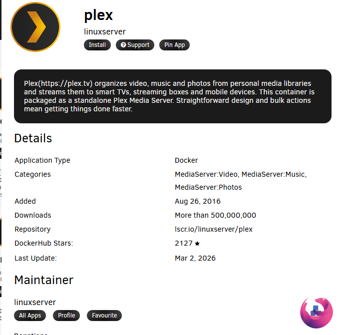

Good evening, folks. This is one of my first posts, so please bear with me. I too require a bit of hand holding in fear of making a mistake.
·         I am using repository Iscro.io/linuxserver/plex on Unraid 7.2.4 saved in appdata/plex
·         I have backed up the entire Plex Media server folder as a precaution.
·         Here are the settings I believe I need to set when installing DBRepair, but am not 100%:
o   Name: dbrepair (default)
o   Repository: bmmbmm01/plex-dbrepair (default)
o   Network Type: Host (defaulted to Bridge but my Plex is set to Host)
o   Use Tailscale: Off (default)
o   Console shell command: Bash (default & what Plex docker is set to)
o   Privileged" Off (default)
o   Plex Databse Folder: /mnt/user/appdata/plex (where Plex is stored on my Unraid)
o   DBREPAIR_MODE: automatic (default)
o   the remaining settings (default)
Are any settings incorrect? Once correct and installed, do I simply run the docker, or does it run automatically after installation? Lastly, do I stop the docker once it's been used?
I appreciate your help in advance as I believe I may have a corrupted database since Plex is not recognizing any new TV Shows and I'm unable to empty trash from any library since I last updated Plex docker.
Thanks!

That is correct, the only thing someone needs to do is set the app data folder. The only piece of inofmration that chagnes.
also per the 1st post of this forum when setting your plex path in the tempate you must see the Library folder.
no other settng change is required.
Per your post your running
if you edit the old docker enable teh advance togle at the top top right. then Scroll down down to bottom and show more settings. You will see an appdata path.
COPY THAT PATH!
Per that appdata default template path is
so you would change the first option in my template to that path...that's it..
as it say in yellow.
WHEN DONE CORRECTLY!
You should see the Library Folder.
This is the only thing that needs editing to run automatic repair...
This is user preference and customizeable this is why a default location is not set and can't be set as not all templates use the same path...
