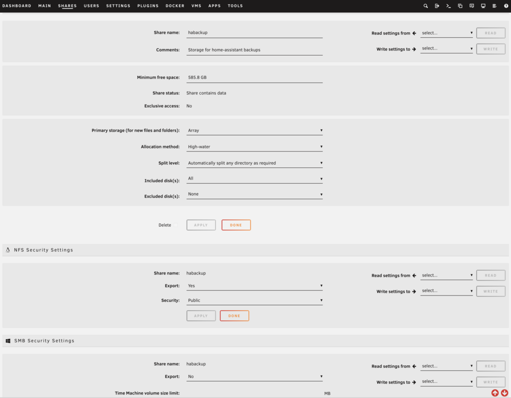

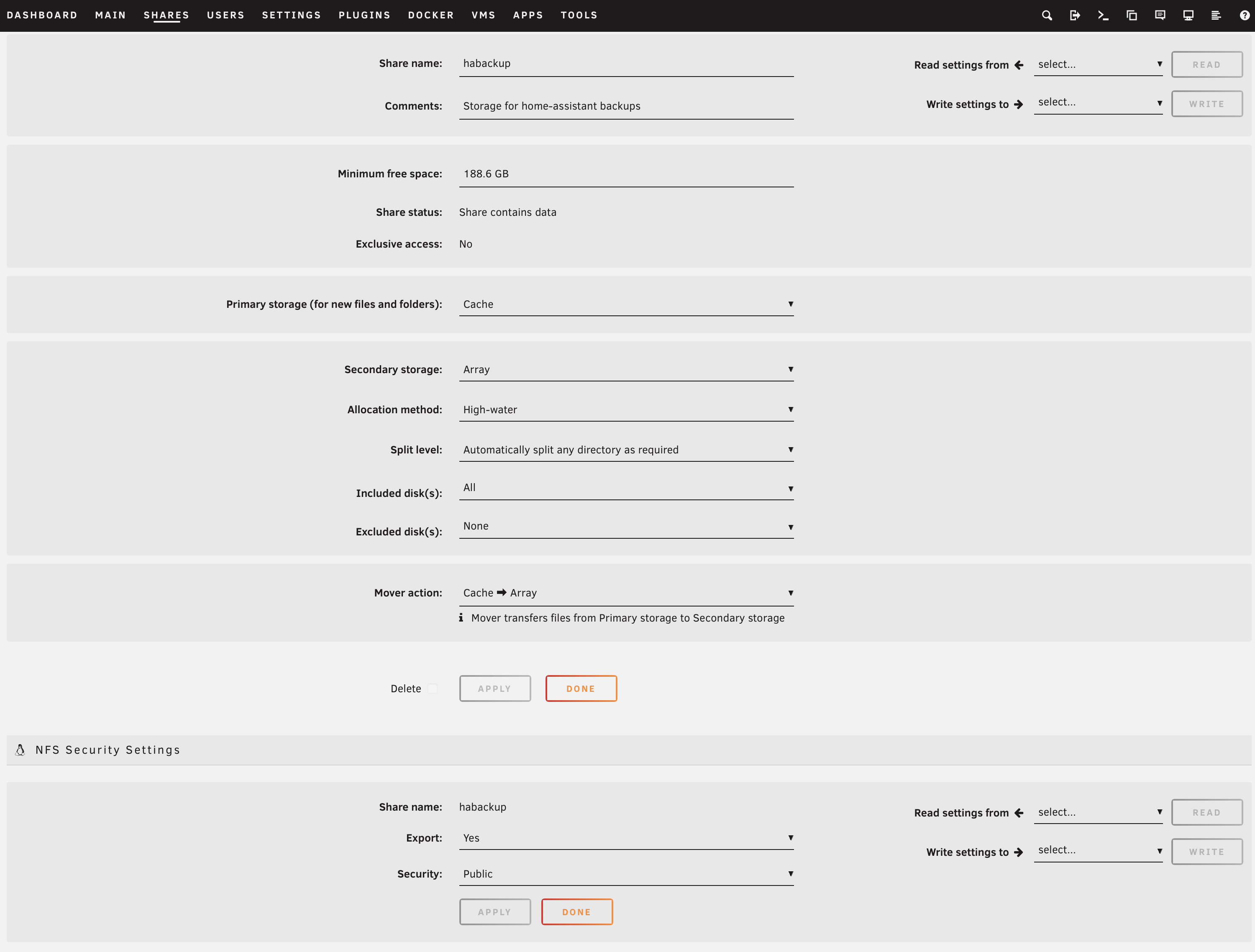

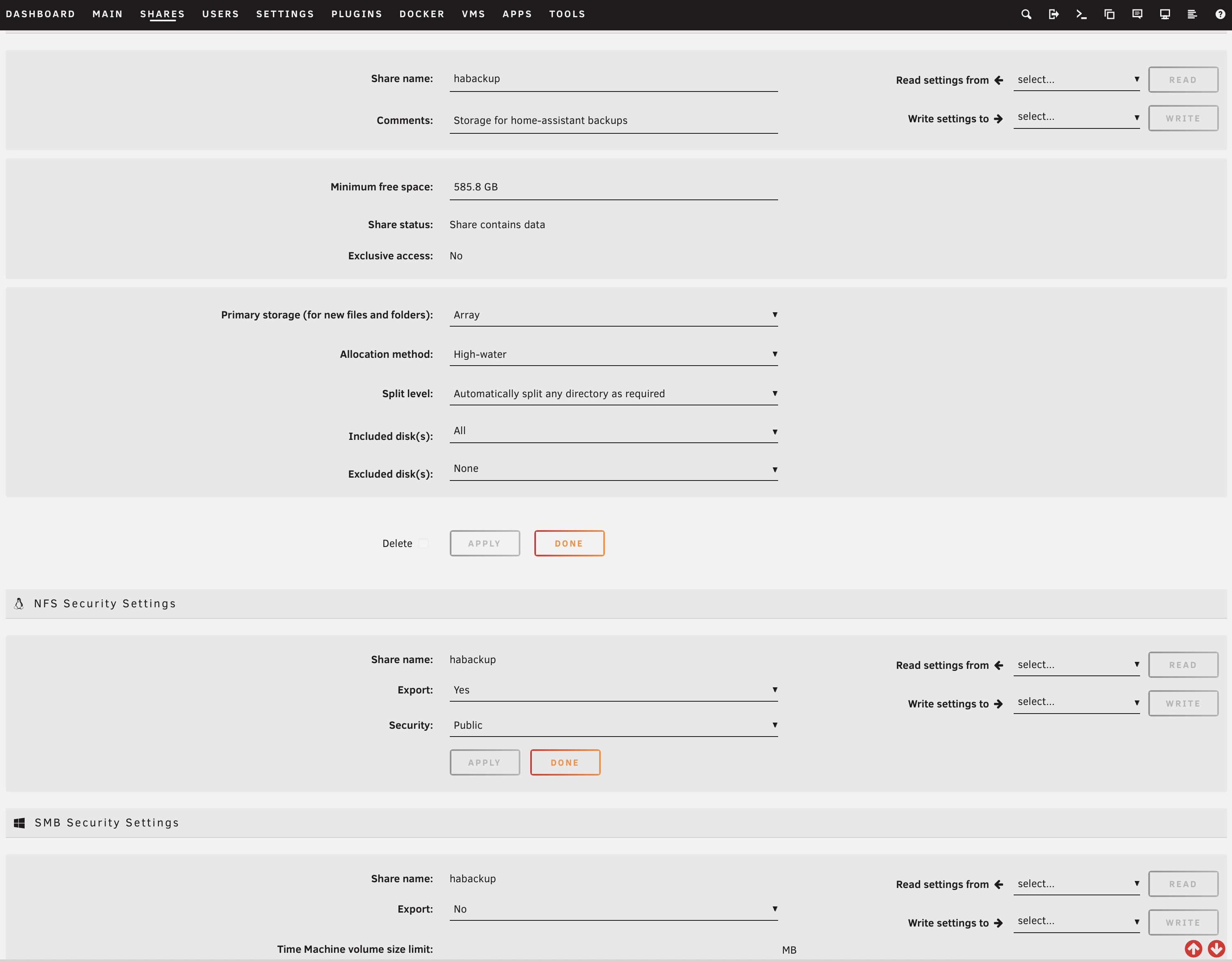

I have a home assistant server that backs up to my unraid server. Everything works when the share is configured as an array but fails as a cache with mover enabled. Is there a requirement that I have to stop the array or reboot? Here are screenshots. Help is appreciated.

The HomeAssistant gives an error that says it "Network storage device failed" after the backup. The relevant syslogs entries from unraid server are these:
Jan 20 05:00:34 Linc move: move: /mnt/cache/habackup/Automatic_backup_2026.1.2_2026-01-20_04.47_01003761.tar Success
Jan 20 05:00:34 Linc shfs: /usr/sbin/zfs unmount 'cache/habackup' 2>&1
Jan 20 05:00:34 Linc shfs: /usr/sbin/zfs destroy 'cache/habackup' 2>&1
Jan 20 05:00:34 Linc move: mover: finished
Jan 22 06:00:50 Linc move: move: /mnt/cache/habackup/Automatic_backup_2026.1.2_2026-01-22_04.55_32003308.tar Success
Jan 22 06:00:50 Linc shfs: /usr/sbin/zfs unmount 'cache/habackup' 2>&1
Jan 22 06:00:50 Linc shfs: /usr/sbin/zfs destroy 'cache/habackup' 2>&1
Jan 22 06:00:50 Linc move: mover: finished
It's the same each time. It appears that the 'backup' completes but then the directory/folder is then unavailable for whatever time. I feel like it's something how I have this share setup.
The cache pool is setup up as a 2TB zfs filesystem.

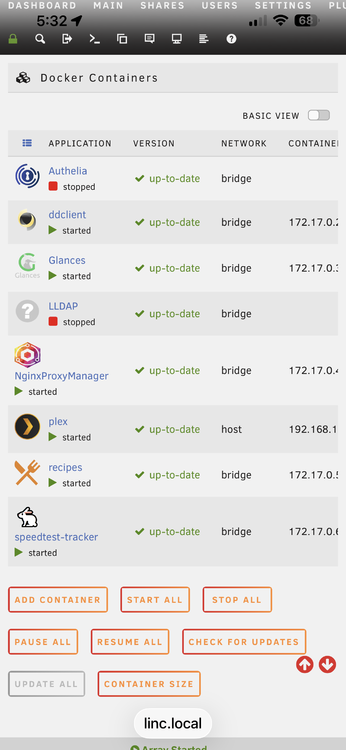

Not much actually. See attached. I also have a Frigate host writing to it. The HomeAssistant is also a separate host but only writes a tar backup once a day. Finally I have Apple computers writing backups (Time Machine).

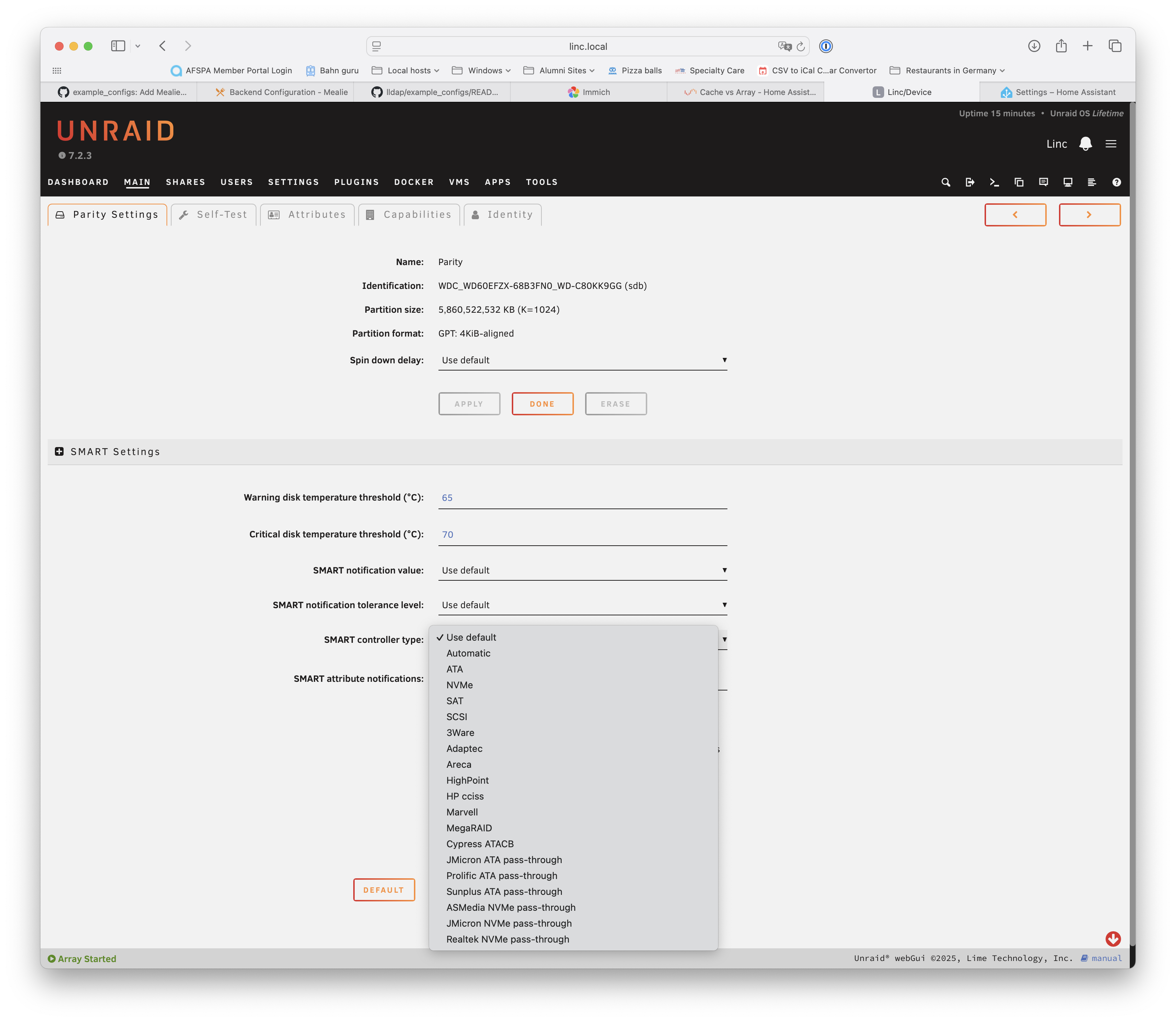

Is it possible that I have the SMART controller type set incorrectly? Do I need to change the SMART controller type to SCSI? I ran a Smartctl --scan and here are the results:

So should I change the SMART controller type to SCSI for a SATA device? Could it be this?

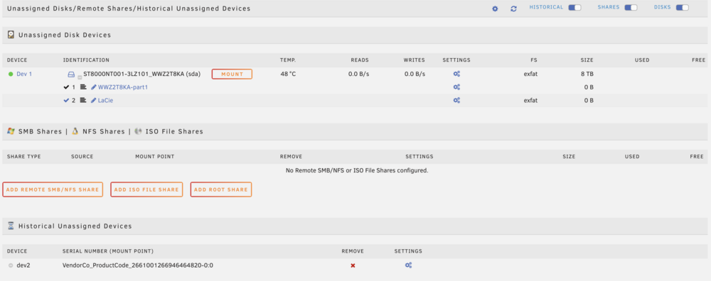

Do you have a Remote share or the rootshare mounted with Unassigned Devices? Some other system accessing your rootshare perhaps?
2 hours ago, trurl said:
None of the plugins you have installed according to those diagnostics should directly cause this problem though.
I have two servers connecting to my UNRAID server. Both are using NFS.
1st is the Homeassistant for backups. These only occur once per day between 4:45-5:45 am.
2nd is a Frigate NVR server and it is connected as a remote share from that server. It uses the UNRAID as storage for upto 3 days worth of triggers.
Lastly, I did have a USB drive with all my PLEX movies attached as an unassigned device. Not sure what a root share is. In SAFE MODE, this isn't mounted. Still running in SAFE MODE for nearly 4 hours and there are none of these errors in the logs. Current diagnostics attached.
I shutdown every docker container and "unmounted" the external drive prior to SAFE MODE but it didn't seem to matter. I'm gonna try and reboot in NORMAL mode and see if the issue returns.
Under your Unassigned Devices you should have a button for that. Click it for more information.
I shutdown the Frigate server to ensure there the remote NFS connection wasn't causing the problem and the external USB drive is unmounted. It still persists. I guess the next step is to completely unplug that drive and reboot.
linc-diagnostics-20260125-1754.zip
I completely disconnected the external USB drive and there is no remote device accessing my system. It's still happening. Here are the logs. Is it possible bug? I've also shut off every docker container.
linc-diagnostics-20260125-1810.zip

Could it just be that I need to set the SMART control type to SCSI, SAT, ATA, or automatic for each drive in my array? Will this hurt anything if I set it to SCSI or automatic?
