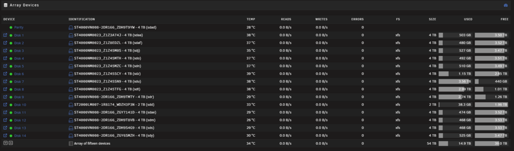

Probably this is more useful:
            [name] => parity
            [device] => sdad
            [id] => ST4000VN008-2DR166_ZDH9T9YW
            [format] => GPT: 4KiB-aligned
            [name] => disk1
            [device] => sdaa
            [id] => ST4000NM0023_Z1Z3A74J_35000c500581798d3
            [format] => GPT: custom
            [name] => disk2
            [device] => sdaf
            [id] => ST4000NM0023_Z1Z8EDZL_35000c5008347f6bf
            [name] => disk3
            [device] => sdj
            [id] => ST4000NM0023_Z1Z45M0S_35000c50058a80177
            [name] => disk4
            [device] => sdo
            [id] => ST4000NM0023_Z1Z45MTH_35000c50058a7e4e7
            [name] => disk5
            [device] => sdn
            [id] => ST4000NM0023_Z1Z45MZC_35000c50058a7e07b
            [name] => disk6
            [device] => sdz
            [id] => ST4000NM0023_Z1Z45SCY_35000c50058a7793b
            [name] => disk7
            [device] => sdu
            [id] => ST4000NM0023_Z1Z45SN9_35000c50058a73d5f
            [name] => disk8
            [device] => sdt
            [id] => ST4000NM0023_Z1Z45TFG_35000c50058a80fe3
            [name] => disk9
            [device] => sdr
            [id] => ST4000VN008-2DR166_ZDH9TMTY
            [name] => disk10
            [device] => sdd
            [id] => ST2000LM007-1R8174_WDZH3P3N
            [format] => MBR: custom
            [name] => disk11
            [device] => sdae
            [id] => ST4000VN008-2DR166_ZGY7141D
            [name] => disk12
            [device] => sdm
            [id] => ST4000VN008-2DR166_ZDH9T8VB
            [name] => disk13
            [device] => sds
            [id] => ST4000VN008-2DR166_ZDH9S4G9
            [name] => disk14
            [device] => sdy
            [id] => ST4000VN008-2DR166_ZGY6SMZH

Parity and disk3 both have
            [size] => 3907018532
So I assume that means there won't be a problem with parity being smaller than any 4TB array disk.
59 minutes ago, trurl said:
shfs             50T   14T   36T  28% /mnt/user0
Looks like total array capacity is 50T. Maybe some of that is multipartioned disks though.
/dev/sdv1       166T   79T   66T  55% /mnt/moker-vet
And raid5 pool has 79T used so won't all fit on array as currently configured.

3 minutes ago, trurl said:
According to df, it looks like all 4TB array disks are showing 3.7T capacity, with the only other array disk, 2TB, showing 1.9T capacity, so maybe no reason to format anything.
1 minute ago, trurl said:
cache pool is 2x1TB zfs mirror, so that should be OK too.

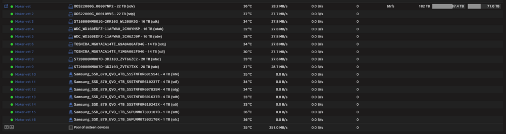

What about the raid5 btrfs pool moker-vet?
Is there some way we can preserve its data while removing some HDDs to use in the array?
Here is what I get from carfax.org.uk:
https://carfax.org.uk/btrfs-usage/?c=1&slo=1&shi=100&p=1&dg=1&d=1000&d=1000&d=4000&d=4000&d=4000&d=4000&d=4000&d=20000&d=20000&d=14000&d=14000&d=16000&d=16000&d=16000&d=22000&d=22000
The smaller drives (<=4TB) are SSDs.
As long as there's enough free space, it's possible to manually remove one or more disks, it must be done using the CLI, and once one or more disks have been removed, the pool needs to be reimported to sync it up with the GUI.
This FAQ entry shows how to do it:
https://forums.unraid.net/topic/46802-faq-for-unraid-v6/#findComment-462135
We could move some of its data to the array first.

For my benefit and anyone else following along, I have reordered the carfax from smallest to largest, with the idea that the smallest (SSDs) will not be used in the array and the largest will need to become parity. So it will be easier to remove from the page as we go.
https://carfax.org.uk/btrfs-usage/?c=1&slo=1&shi=100&p=1&dg=1&d=22000&d=22000&d=20000&d=20000&d=16000&d=16000&d=16000&d=14000&d=14000&d=4000&d=4000&d=4000&d=4000&d=4000&d=1000&d=1000
Just to recap, all multipartition disks are in the array, and not missing enough space to bother with reformatting. All drives in cache and moker-vet pools are partitioned correctly as SSDs or HDDs.

but i think some screenshots can help showing what i have and have left:
  1. CACHE POOL ZFS:
Primary use: fast storage for plex database, docker containers and any performance hungry application.
  1. storage pool 1: ARRAY XFS
  1. storage pool 2: pool BTRFS
the storage pool 1 & 2 act as a storage pool for my movie files and they move the files with mover. this is not ideal and it would be great going to one.
my question is, should i move it all to the array and use 2 parity disks and use a xfs? or move the array to the btrfs pool?
and what should i do with the SSD disks i have? can you explain to me how i would need to set it up?
is it possible that i can remove disks one by one from the btrfs pool and add them to the array? i can move one disks data content to the other disk in the BTRFS pool and then remove it and add it to the array and work like that.
root@Moker-Vet:~# du -h -d 1 /mnt/moker-vet | sort -hr
80T     /mnt/moker-vet
77T     /mnt/moker-vet/mokervet
2.5T    /mnt/moker-vet/Media-Landingzone
719G    /mnt/moker-vet/Back-ups
15G     /mnt/moker-vet/appdata
8.1G    /mnt/moker-vet/Admin
0       /mnt/moker-vet/synology-nas
0       /mnt/moker-vet/Downloads
^this
moker-vet pool has 65T free
/dev/sdv1       166T   80T   65T  56% /mnt/moker-vet
with disks ranging from 22T down to 1T:
@JorgeB
Can we remove 22T + 20T + 20T = 62T from moker-vet pool for reuse in the array (22T single parity with 2x20T for data) while still preserving all data in moker-vet until we can move some of it off?
21 minutes ago, trurl said:
Can we remove 22T + 20T + 20T = 62T from moker-vet pool for reuse in the array (22T single parity with 2x20T for data) while still preserving all data in mover-vet until we can move some of it off?
Should be, there were 71T free on the last screenshot; they would need to be removed one at a time, and it will take some time to rewrite the data to the other pool devices.
