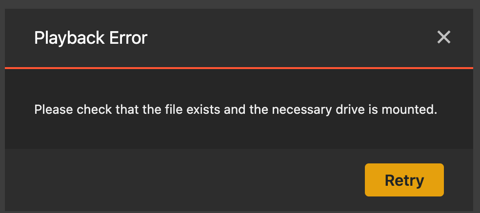

Everything starts up fine and all of my shows and movies are recognized when Plex first starts, but after some time (not sure how long), Plex will randomly throw the error in the screenshot:
Please check that the file exists and the necessary drive is mounted.
For some reason, this seems to only happen to Movies. TV shows remain fine. The only way I have been able to resolve it is to restart the Plex service.

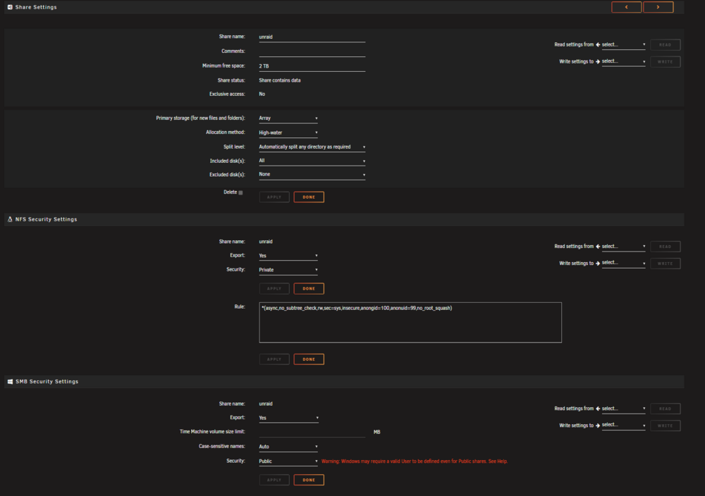

My Unraid share settings:
Edited by raphytaffy
Added Unraid share settings

13 hours ago, itimpi said:
If you have secondary storage set for a share then you are 'caching' it.
If Primary storage is set to Array (as in the screenshot) then it has no secondary storage and is not cached.

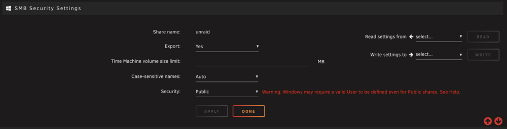

Hmm I'm still having trouble getting this to work:
//192.168.0.30/mnt/user/unraid /mnt/unraid cifs rw,guest,_netdev,noatime,noserverino,cache=none 0 0
I have set SMB Security Settings > Security > Public. Do I have to set any particular mount setting for fstab to pick up the mount?
