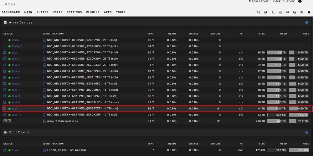

I have a drive in my BACKUP server array showing smart erros
I want to remove a drive from my 3rd unRAID server array that doesn't yet have any data on it and place it in the array with the failing drive replacing the drive with errors.
I don't know how to properly remove a drive from an array and make the array whole again without the missing drive. There's no SHARE data on the 3rd server drive but there IS share data on the 2nd unRAID server drive that needs to be put back on the replacement drive.
Yes, it failed self-test so must be replaced.
Okay, so far I have managed to extract the not yet filled with data 14TB drive from my 3rd unRAID server and used the "New Config" preserve current assignments to relaunch the old array minus the unfilled 14TB drive. I am about to introduce a parity drive to that array and start the SYNC this morning.
On to the real problem child. I brought the BACKUP server down, replaced the ailing 14TB drive with a like 14TB drive I just removed from the 3rd server. I started the BACKUP server then assigned the new drive to replace the failed one, then started the array in Maintenance mode to speed the rebuild. If all goes well, in 15-16 hours the array will be healthy again.

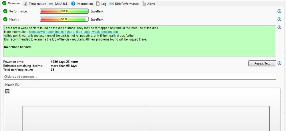

I pulled the ailing drive and put it in a dock on my PC and ran HD Sentinel.
The drive seems to have 8 weak sectors after 1956 days of ON time. So the drive isn't DEAD but health is starting to decline. Technically data should still be good but ADMIN BEWARE, use at your own risk. The deed is done. Thankfully I had a drive I could quickly swap in there.

Preclear might get those pending sectors converted to reallocated sectors. Then you can see if it will pass an extended self-test.
Yes, I am in the I.T. industry and noticed pricing shenanigans starting in late August 2025. By late September I was advising many clients to get off the fence concerning new build-outs. Some listened, some didn't. Most in the news reporting sector were predicting the same for SSD's and HDDs. There was still channel stock of HDDs last November so I bought up 10 of them, some NVMe drives and a few sticks of RAM. I'm feeling completely justified right now. My platforms are not more than 1 generation older than current and are plenty fast enough for me.
I will give preclear a look-see once this Parity sync finishes by tomorrow morning. If I can find that the drive is stable for a few months by itself I may use it for something rather that toss what is now an almost $600 drive. thanks, good advice.
