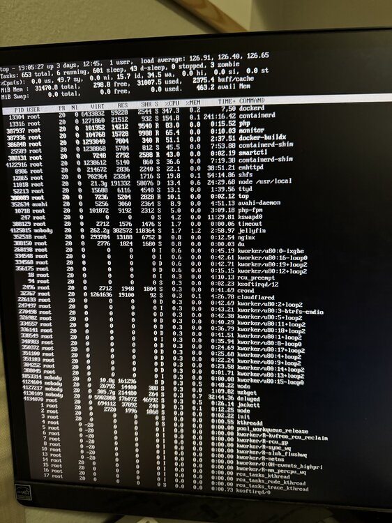

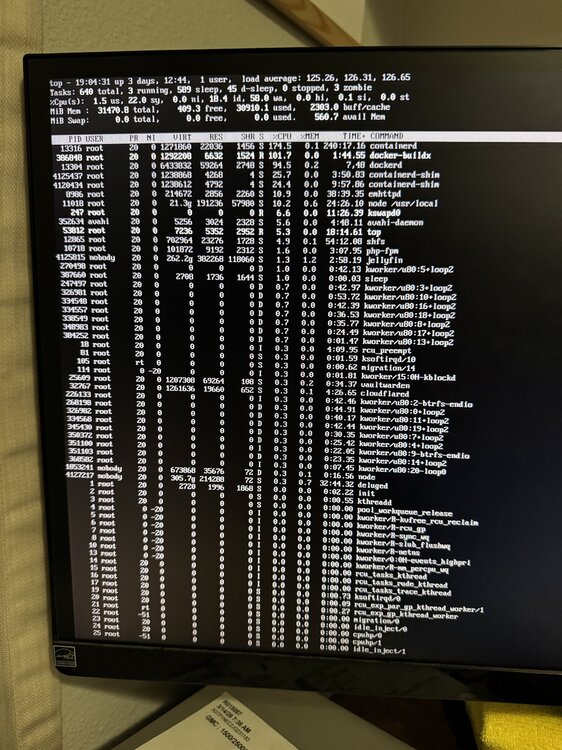

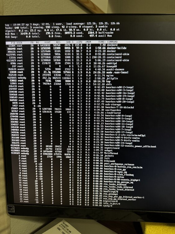

    So after enabling one container at a time. I started today Jellyfin and the server crashed around 9PM. I was up for over 7 days till I turn that container on. I will leave it off and continue with all

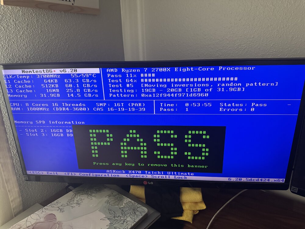

I am doing an Memtest86+ see if I get anything.
Memtest86+ passed.

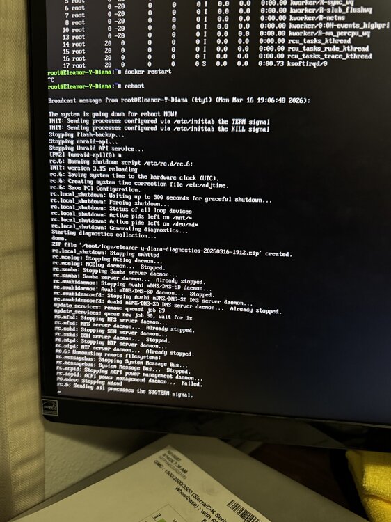

It froze again. Also, I saw that I was able to see the Tower Login and place the root user but didn't let me place the password. I hit the power button on the server and now waiting to shutdown gracefully. I see that is stopping Unraid-api... and then stopping Unraid API service... and so far nothing else. Hopefully, by the time I come back it is done and something shows up on the logs. Ill upload a support file right after I get back up and running.
OK, so not a total server hang, you can enable the syslog server and post that after it happens next to see if there's something there.
