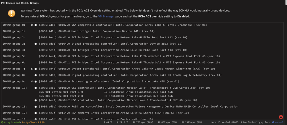

In Tools - System Devices, is your VGA controller checked?
I don't see it checked. Here is a screenshot @trurl
Delete config/vfio-pci.cfg on flash and reboot.

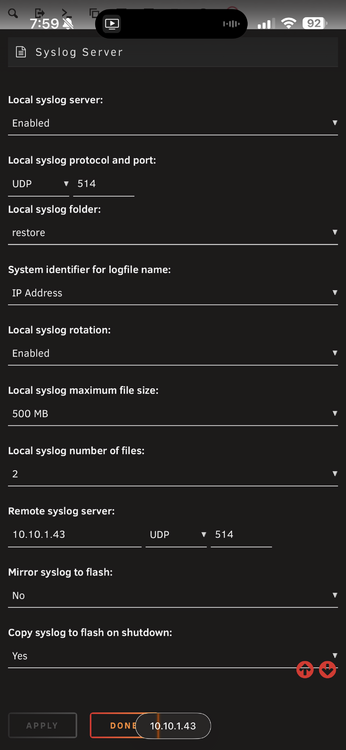

I already did that, see screenshot. I’ll check again but I had enabled it already when I had the AMD system.
Edited by Tucubanito07
You would need to separately attach the log file that is being stored in the 'restore' share as that is not automatically included in the diagnostics.
I apologize, I didn't know. Here it is.
syslog-10.10.1.43.log.zip

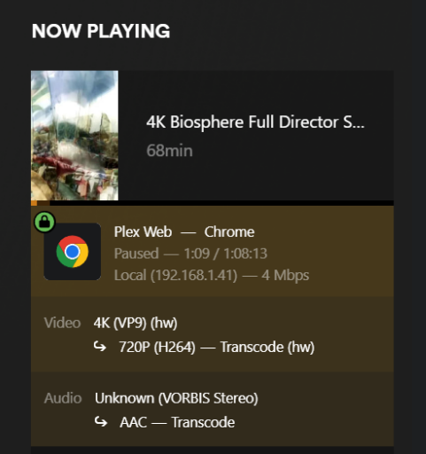

Looks like I was wrong, I now have confirmation that 245K works with Plex in 7.2.4 using stock settings.
0188893f190951d2833d3fff4c3029bf?e=1773141642&v=0&t=MlnfvlsKxME1PeBggkZG95yu9AtaOTpglhCEWlRIboo
a59c1c8c374a687e37153e0095b09bd2?e=1773141642&v=0&t=SO_lZCXkL4rAsA6-gJY5aRyBbicX2b1TlEJONj2yFIE
Now the real question is, why it does not work for me? If the requirement is 7.2.4 and is the same kernel as 7.2.3, then it should work on the version Ami am on.
