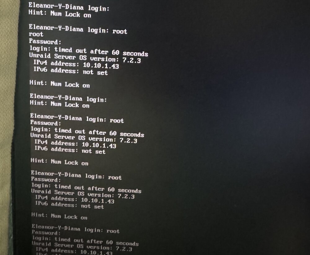

@JorgeB It just crashed again. Every time I try to place the root password on the screen so I can maybe run command to see what is going on and I keep getting login: timed out after 60 seconds. Uploading the support file and the logs when it comes back up.
I am still able to ping the server but the dashboard and the containers are all down. I also tried to SSH to the server but is not working.

Do you have an attached monitor and keyboard?
I do but when I placed the root and password it just says timeout. Here is a screenshot.
Edited by Tucubanito07
That zip you just attached suggests you have other problems including a failed disk, but can't really work on that until you can work with the OS.

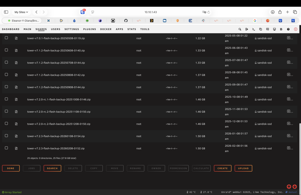

Do you have a current flash backup?
I probably have some backup of the flash drive but cant say is current.

How recent is your flash backup? Have you made any changes to disk assignments since then?
3 minutes ago, trurl said:
In the diagnostics, in the system folder, in the folders.txt file, /boot has a lot of FSCK files, where corruption was "repaired".
I had added a drive that had error before and see if I was able to use it. However, the error kept on coming back on that drive, so I removed it. I had taken out the drive and I saw that it was still saying emulating the drive.
I had copied stuff from the emulating drive to another drive before I did a new config. Once in the new config. I did a parity sync and it fixed a lot of errors. I then ran a second sync and no more errors.
At that time I did a new config and added all the drives in the same order and kept everything the same. on the screenshot below you can see a have a lots of usb flash drive backups.

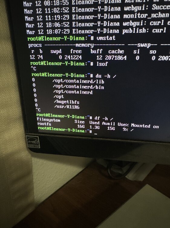

@JorgeB or @trurl So the server crashed again and I only had like 5 containers online. However, I did login on the server before it crashed and I am able to still run commands. All containers are down and also the web gui is down.
Is there any command you guys would like me to run while it is up and running and kind of frozen? Trying to run HTOP but nothing commands up. I also ran docker stats and nothing shows up. But if I do Lls -la /mnt/ it gives me the files and folders on that directory. So it kind of works.
command
df -h /
That looks OK

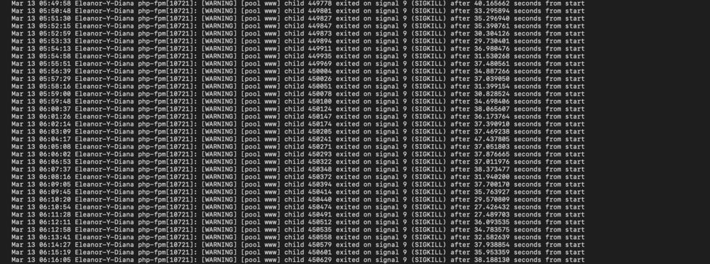

However, I see a lot of this still.
Archive.zip
With no containers running after a fresh boot?
