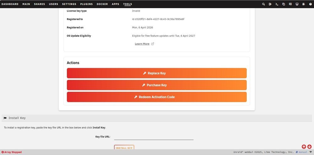

  • New drive loaded with a new backup
  • Booted fine
  • Purchased license
  • Unraid will not accept license, cannot start array
  • Unraid connect shows what to do: copy URL, paste in tools>registration. Popup says license installed. No change.
Syslog last three lines:
emhttpd: error: get_key_info, 741: Invalid argument (22): stat: /boot/config/Unleashed.key
emhttpd: Unregistered Trial - invalid key (EGUID)
emhttpd: Unregistered Unleashed - invalid key (EGUID)
I've opened a support ticket. Probably need to manually modify that "/boot/config" file. Since I won't know what I'd be doing, my luck I would brick the system. 😄

The EGUID error is a key file placement issue.
Your syslog confirms you purchased an Unleashed license -- so the file should be named Unleashed.key inside the /boot/config folder on the drive.
With the drive accessible from another computer navigate to that folder and verify the file is present and correctly named.
If it's missing, download it directly from account.unraid.net and place it there manually.
Support will tell you the same thing -- straightforward fix once the file is confirmed present.

@Lolight thank you for all your time and advice.
Unfortunately Unleashed.key IS in the /boot/config folder. I used Midnight Commander on the server to look for it.
But Trial.key is also still in the /boot/config folder. Could that be confusing unraid?

It should not, but deleting it will not cause a problem.
Unfortunately if it is nothing obvious you are going to have to continue to contact support and work with them to get it resolved.
I would copy the Trial.key file somewhere before deleting it. Just in case....

The official Unraid documentation specifically states "Ensure only one key file exists in the config folder".
https://docs.unraid.net/unraid-os/system-administration/maintain-and-update/changing-the-flash-device/
Sure enough, step 8 of replacement method. I moved it out of the folder. That by itself did not resolve the issue.
So I looked closer at that 'registration' page. One of the orange bars is what I used to purchase the license. But another bar is 'replace key".
I followed those steps and can report successful completion of my license issue. It allowed me to start the array and all appears normal. Dockers were all stopped but it allowed me to start them.
