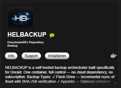

## ✨ What is HELBACKUP?
A self-hosted, intelligent backup orchestrator built specifically for **Unraid**.
One Docker container. Full control. No cloud. No subscription.
## 🚀 Core Features
### 🗂️ Backup Types
- **Flash Drive** — Incremental rsync with SHA-256 verification
- **Appdata** — Optional container stop/start, Docker config export
- **Virtual Machines** — Libvirt snapshot, vDisk rsync, XML export
- **Docker Images** — Save as `.tar` via Docker API
- **System Config** — Network, users, shares, plugins, disk assignments
### 🎯 Backup Targets
- **Remote NAS / Server** — SSH + Rsync with optional strict host-key pinning
