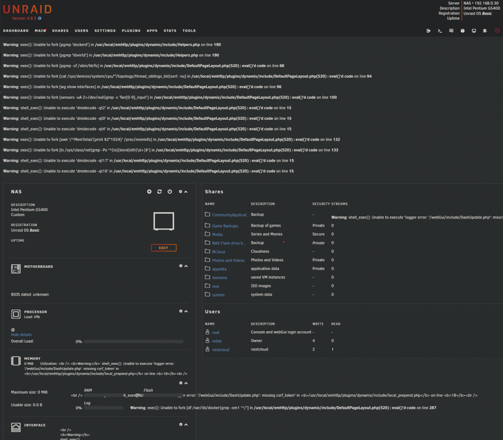

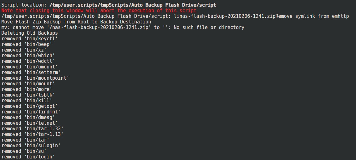

So I did run this and this happened:
I think it somehow deleted more things than it should have done
EDIT:
Reboot fixed it, so I think it caused a memory leak or what its called that made unRAID itself not able to run from memory anymore as it usually do. Had to turn it off by the power button.
(I do have a manual flash backup already btw)
This is what the script looks like for me right now:

When I run it, it did say something about it could not find directory " " over and over and over I think? dont quite remember
Did I write something in to the script wrongly?
Edited by Mihle

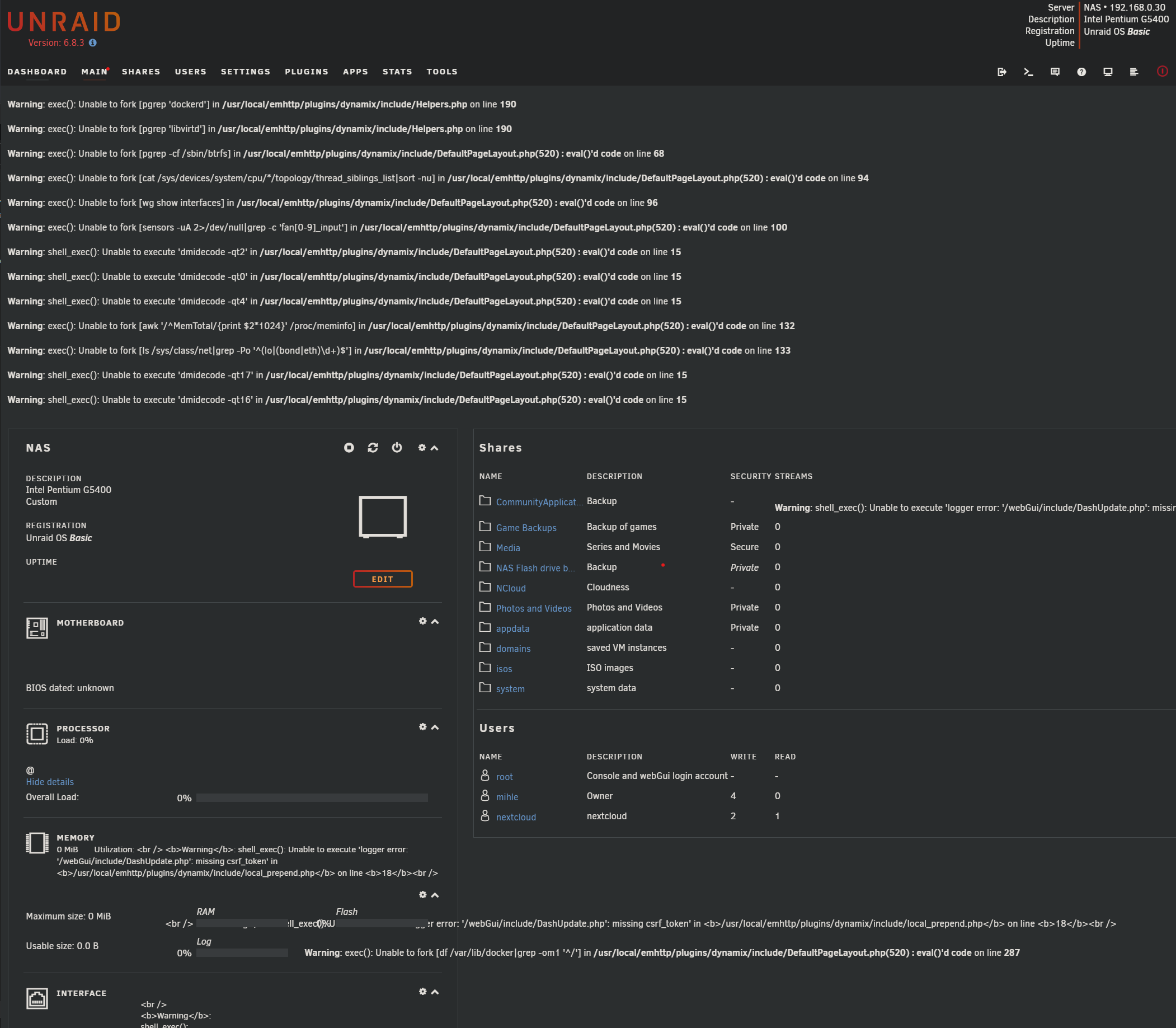

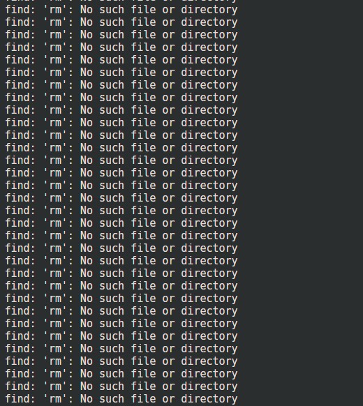

Tested again, but I removed the / at the end of the directory, it says this:
1635072809_Skjermbilde2021-02-06124337.thumb.jpg.abb439277bc0b2d25a225ea8f55ac02a.jpg
Then remove some other things
then continues like this, probably until the NAS runs out of memory and crashes?
(I run it manually)
Is there something I have done that causes it?
Edited by Mihle
Does your backup directory (/mnt/user/NCloud/Mihle/files/Filer/Backup/NAS Flash Backup/) already exist?
If not, it needs to be created before the script runs.  I learned this making my Plex script that you cannot move a file to a destination that does not exist.
Also, I'm not clear on whether it's actually needed or not, but it's good practice to enclose your backup path in quotes since it has spaces in the path:
dir="/mnt/user/NCloud/Mihle/files/Filer/Backup/NAS Flash Backup/"
The error message on the mv command indicates that one or both of these are the problem.
It's probably also why the rm is failing as well.  During the creation of my Plex script I had this rm command mis-formed and had the same errors as you, and the GUI was totally unresponsive due to it.. had to pull the power plug to reset the server since I couldn't restart it any other way... was not a good time!
So I'd change your section 1 to this and see if it helps:
#dir = WHATEVER FOLDER PATH YOU WANT TO SAVE TO
mkdir -p "$dir"
The mkdir -p just ensures that if the path does not exist that it is created.
I’d have to agree with @Energen. The spaces in the directory path was the first thing that caught my eye. I think it’s time for a revision with a mkdir section too
Edited by Cpt. Chaz
Yes.
I did not know that
mkdir -p "$dir"
Ah, ok, only adding the quotes seem to have fixed it!
Well, It does not show up in Nextcloud as I ideally want, but that might be Nextcloud. At least it doesnt make the folder it is moved to uneditable for Nextcloud as the appdata backup do.
Edited by Mihle

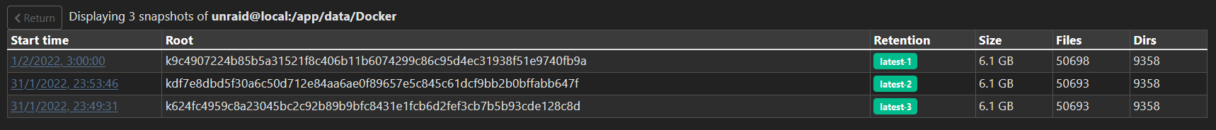

I'm doing backups with Kopia (highly recommended after trying many) and this would be wonderful to have a decent versioning without taking almost any additional space.
With Kopia docker I don't have permissions to access to the boot folder so this is the only solution so far
For example for each snapshot
You can browse it individually and get any file, restore everything... it has encryption deduplication, compression, and it is way faster than duplicati.
Edited by L0rdRaiden

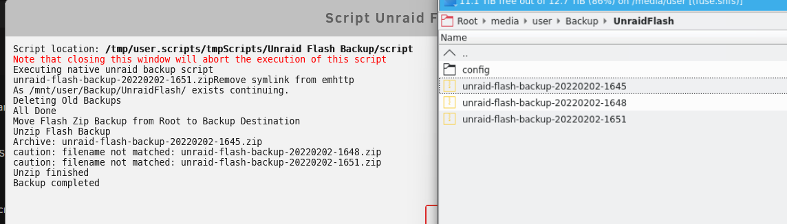

This script is built on the native unraid script that includes the zip function. However, it would be easy enough to add an unzip function to my backup script for you to use. I wrote this fairly quickly and only tested once to make sure it worked. Looks like it did, but please use caution until you've tested and are certain. Also, this assumes you only have the one single zip file in $dir. the way it's written, it will unzip every zip file in $dir. Just copy and paste to the end of your script. Hope it helps.
#### SECTION 7 ####------------------------------------------------------------------------------------------------------
echo 'Unzip Flash Backup'
cd "$dir"
unzip *.zip
#UNCOMMENT THE NEXT LINE IF YOU WISH TO DELETE THE ORIGINAL ZIP FILE AFTER EXTRACTION
#rm -rfv *.zip
4 hours ago, Cpt. Chaz said:

@Cpt. Chaz  well I am not as good as I though
For some reason
  • Section 4 for doesn't delete previous zip files but deletes uncompressed files
  • Section 6 fails to unzip the file because I guess there are more than 1 file that matches, right?
If we can fix section 4 I guess section 6 will work, it should be easy but I am afraid to experiment with the rm command.
Maybe replacing section 4 with this will fix everything?
cd "$dir"
rm -rfv
echo 'All files deleted'
you're on the right track! however the rm syntax requires a target. try this instead
rm -rfv "$dir"*
if you want to confirm this works before trying on "mission critical" files, take everything out of $dir. Then cd into the directory, and run this
touch test1.txt test2.txt
mkdir testfolder
this just simply puts in a couple basic files and a directory. If the commands i gave you for section 4 work correctly, it should remove these test files, and the rest of the flow should result in the latest unzipped backup copy of your flash drive.
rm -rfv "$dir"*
mkdir testfolder
Thanks, it works perfectly  :) I have learnt a lot with you
