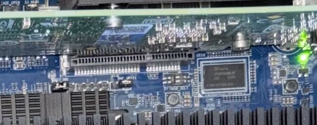

Finally got my new X15 and looking at the x4 slot I’m not sure if it’s open-ended or not (Google insists that it is and the x710-da2 will work). Looks like a little piece of white plastic at the back of the slot.
I know this pics not the greatest.
3 hours ago, wgstarks said:
@_cjd_
I can't be sure, but if you compare the left side of the slot to the right there's a clear difference (left side is closed for sure), it sure looks like it's open ended. You can see the same white on the left side, and I'm pretty sure that's silkscreen on the board itself.

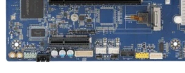

Here’s another shot better pic but it’s still hard to tell since there’s a board in the slot.

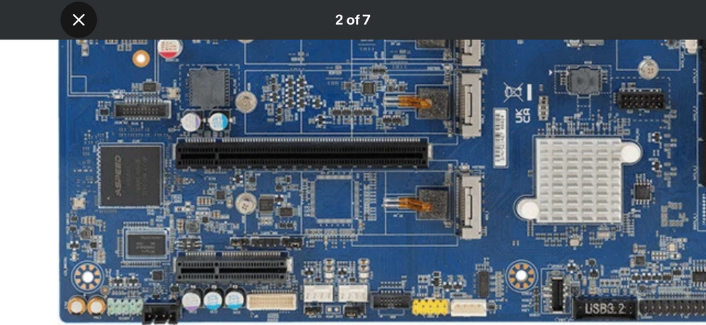

Found a listing for the MB on eBay with better pics.
Definitely looks open to me. I think you’re right about the silkscreen.
Thanks for your help.
Edited by wgstarks
The pic with the card in the slot you can clearly see it's silkscreen and solder pads. I don't have the board so can't say 100%, but reasonable confidence.

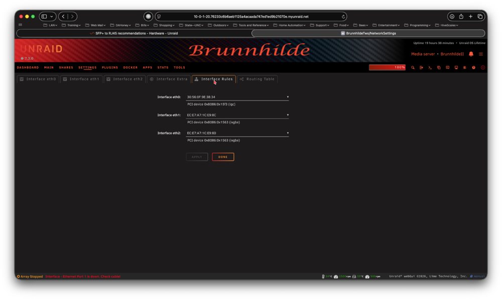

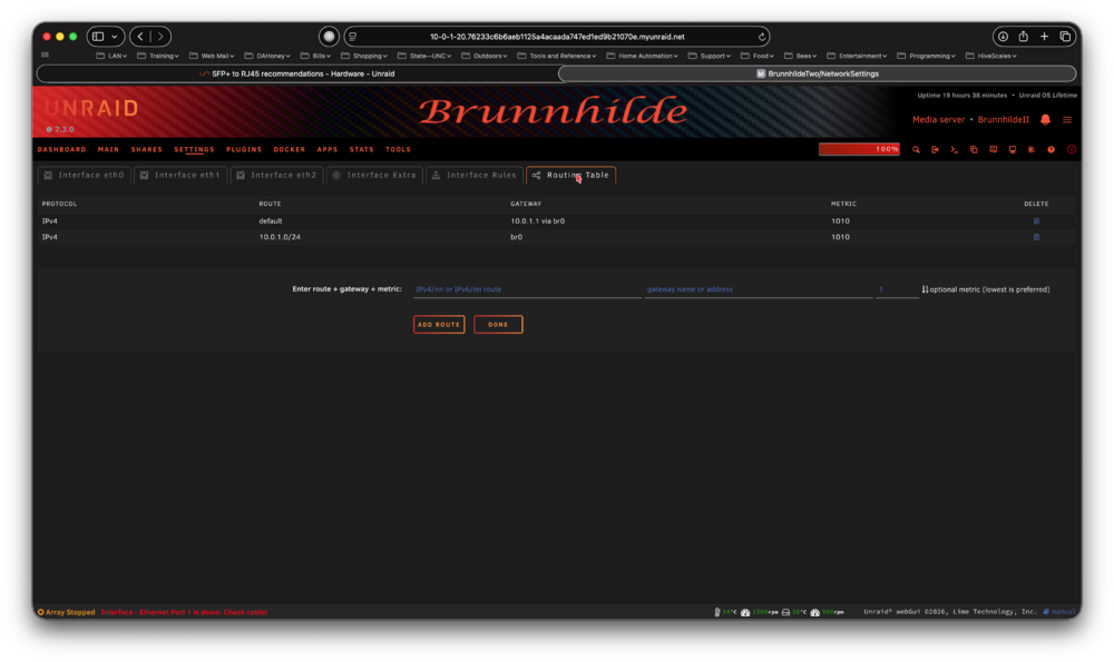

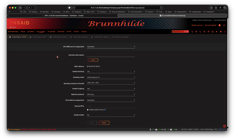

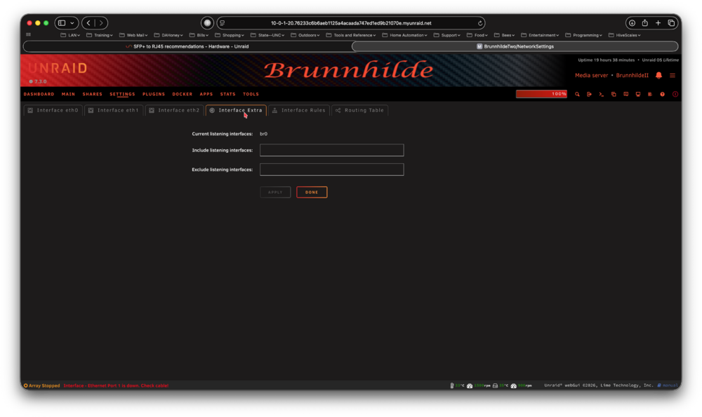

I've ordered the x710-da2 and will be replacing the current ethernet card with it once it arrives. Wondering if there are any changes I'll need to make in unraid network settings or any drivers that need to be installed for the da2?
It should just work as far as detection. Network setup changes will depend on a few things, but I'd recommend screenshots or otherwise documenting everything on network, as well as docker assignments and VMs.
