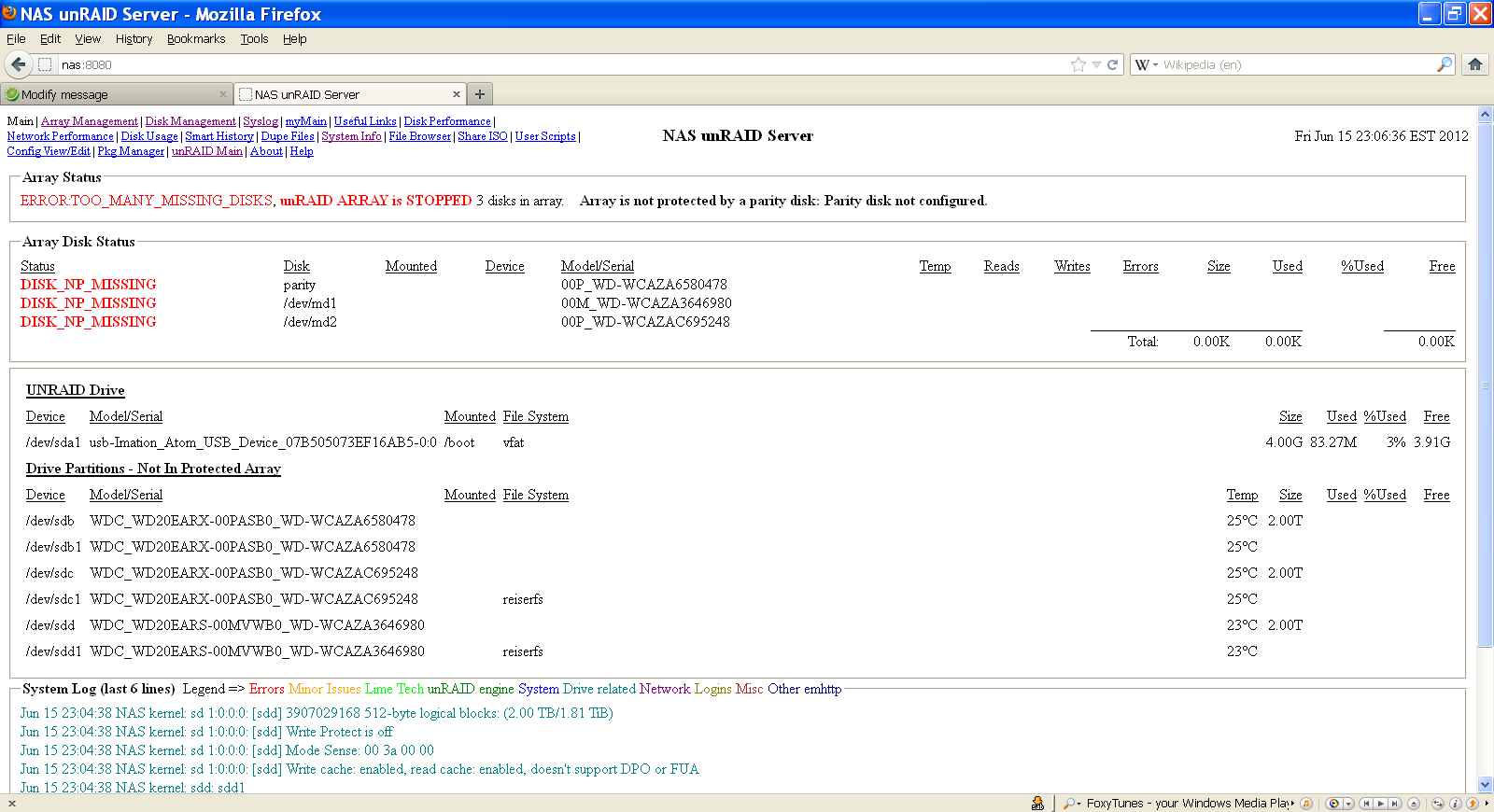

Unfortunately I can't get any of the disks online now. If I start the server with any of the disks physically connected the server does not appear on the network at all, it can not be pinged and the webui does not work. If I physically disable the disks then start the server it is accessible via pings and through the webui, but of course it has an error that there are too many missing disks.
If I start the server with all disks physically disabled and then enable them when the server is up, I get this (see attachment):
Before this happened my disk assignments were:
DISK 1
WD20EARS S/N: WCAZA3646980
DISK 2
WD20EARX S/N: WCAZAC695248
PARITY
WD20EARX S/N: WCAZA6580478
So the disks seem to have changed their assignments and there are duplicates of each disk?
The sdX values are unimportant and subject to change. sda refers to the entire disk and sda1 refers to the first partition. Can you reassign the drives correctly on the unRAID devices page?
It looks like I should be able to re-assign the disks. I have the option to unassign them all in the devices page so I assume I can reassign them. But the question is should I?, I don't want to lose any data by reassigning them in the wrong sequence or something.
