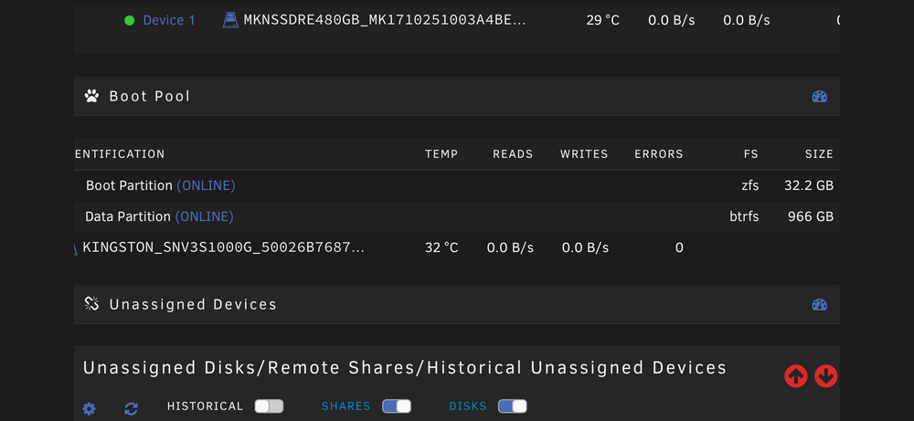

Just bought a new X15 server which comes pre-built with a 1TB internal boot drive. The boot partition uses about 32GB which leaves about 99.5% of the drive unused. I’m trying to decide what to do with the unused space. Currently I’ve added it as a 2nd cache drive. I already had one in my old machine (500GB 2.5” SSD) and didn’t really need a second one though.
I’m a little hesitant to use the unused space as a cache because I’m worried that the extra read/writes will wear out the drive faster, so was thinking about getting a smaller m.2 nvme for the internal boot drive and another 1TB m.2 nvme to use in a 2 drive cache pool (replacing my old single disk cache).
One problem I’m seeing with this plan is that nobody seems to make a small (32GB) m.2 drive. The smallest I can find is 128GB and those are all from manufacturers I’ve never heard of. Looks like the price of the 128GB is low enough that the wasted space isn’t really a concern though.

Yeah, maybe that would be best. It looks like it’s not currently possible to replace one internal boot device with another one.⁉️
Google is telling me an internal boot device can only be replaced with a flash drive. Hopefully that will change at some point. I know internal boot is new and hopefully still developing.
So all the read/writes on the 2nd partition on the internal boot device won’t have an effect on the boot partition?
You can replace a device from a mirrored pool (same size or larger). You can also add a new device to a single boot pool, then remove the other one (again, same size or larger), to replace it with a smaller device, you can boot from a flash drive, then run the wizard to create the boot pool on the new device

I see that my current internal boot partition shows as 32.2 GB so can I just create a pool with a slightly larger drive (maybe 64 GB) and then remove the 32.2 GB) partition from the pool? I think that would be easier if I’m understanding correctly.
No, because the data partition is also mirrored when you add a second device. so it would need to be 1TB.
You can add a device just large enough to cover the boot partition if you erase the data partition first (all data there woudl be lost).

The data partition isn’t being used right now so this should be fairly easy. Do you have a link to a description of how to do this?
Click on the data partition and then "Erase Pool" (it won't erase the boot partition)
Then set the filesystem to "auto"
And then I could add a new 32G m.2 to the boot pool and remove the original boot partition?
Does this mean that I couldn’t create a mirrored cache pool using the cachenew partition I created with the unused space?
Yes, if it's same size or larger than the current boot pool, I see the GUI reporting 32.2GB for the current boot partition, so 32Gb may not be enough
Sounds like the simplest solution would be to just get a 1TB m.2 and create a mirrored cache pool with the 966GB btrfs partioned space on the original m.2 if that’s possible?
