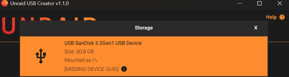

Also this is the usb I was using - it appears to no longer have a GUID?

You can try and ignore the missing GUID message, and manually recreate the flash drive.
