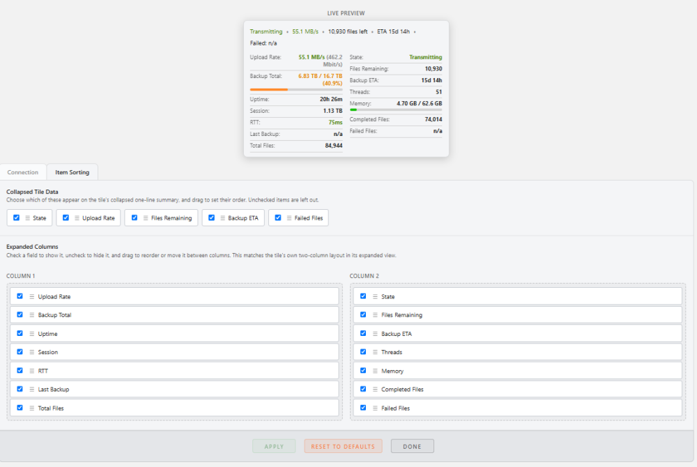

This is awesome, I will convert the plug-in to full API access tomorrow and add in some of these new fields. I really love the compact view on the monitor too instead of seeing 40 chunks listed per file it's one nice line with blocks. I'm not some wizard programmer like you either so feel free to take what I've started with on the plugin and run with it.
The home assistant alerts is brilliant and that will be setup tomorrow also. Maybe a report on how many new files were created each week and how many backed up, did any fail. A monitor itself in HA, the sky's the limit now with this update!
Update: got the plugin working with the API, and everything is butter smooth. Really liking the possibilities with having API access.
It's still in beta as I iron out some of the settings panel, but here is a peek
I've abandoned my custom web monitor as the packaged one is far superior, and there's no point in having both.

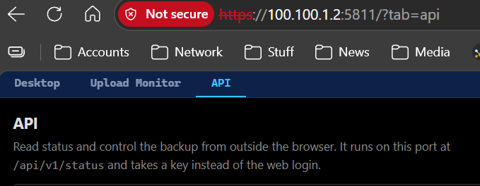

Did you try opening the web GUI and using the API tab from there? Not the terminal monitor. Whatever your web UI port is set to in docker template open in browser https://localhost(unraid-IP):5800(web port) eg https://192.168.1.5:5800 then click API tab. Select read and read:files permissions and Create key.
Try that

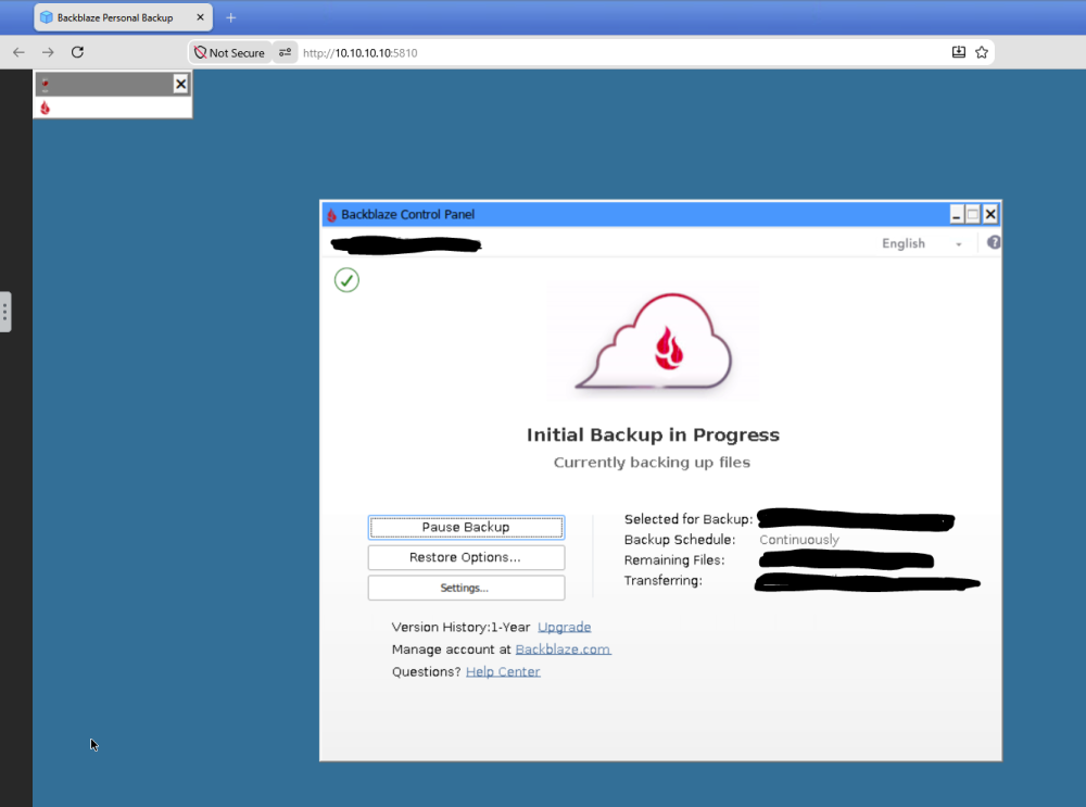

I do use the GUI, and I don't get those tabs: (Same thing for both FireFox and Edge)
I just upgraded Unraid from 6.12.9 -> 7.0.1 -> 7.3.2 Thursday.
Then I have been updating things that were stale, not working. Thus I have only been running Backblaze64 for only 24 hours. )
Previously I was running tessypowder/backblaze-personal-wine which had partially stopped working.
It is possible that mistakes we made at some point. I originally set both to use the same port (old container was stopped) I also copied over some files from the old container, and realized my mistake, uninstalled Backblaze64, and re-installed fresh.
Unfortunately this is a lot of variables to debug at the same time.
Thoughts on next step?
-Wolfman1138
