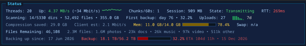

8 hours ago, YourNekoWaifu said:
Updated to the latest beta version and now its doing what the other available client does where it eats all my available RAM and then stops uploading until I manually start it again. A few versions ago it just sat around 8GB consistently
I could be wrong, but I think as you get to larger and larger file sizes being backed up, your memory usage grows. That might be contributing to your issue and why you haven't ran into it before. It might be beneficial to setup and use swap space on an SSD or HDD to make up for the limited RAM availability. It also makes it worse when the scan is running that list of all your 2.3M files gets loaded into memory. If you are using encryption, that also increases memory usage. Lowering your threads would reduce some memory usage. Maybe try automatic, or set it to 8-10?
The swap file would be what you have mapped for "Temporary Data Drive" on the settings tab in the GUI. You could map a folder on an SSD to your container as a new drive letter and try setting it to that.
I might be way off on this, but it wouldn't hurt to try.
Lowering threads did fix it. I just thought backblaze would have some sort of memory management.
Encryption is turned on and i did set a temporary drive but it doesn't seem to want to use the SWAP from it
But its seems like when its doing multiple small files its the problem, now when its chunking its working fine.
I restarted it and it backed up a bunch of smaller files I had, so I think that's where I went wrong
Backblaze does manage the memory but I don't think it spills over to the swap space until your ram is full or near full. I don't believe there is a way to force it to use it. Maybe if you limited your container to only use X GB RAM it could force it over to swap before your system runs out of memory. I know @foz has swap in use in some of his screenshots so he would be in the know on this issue.

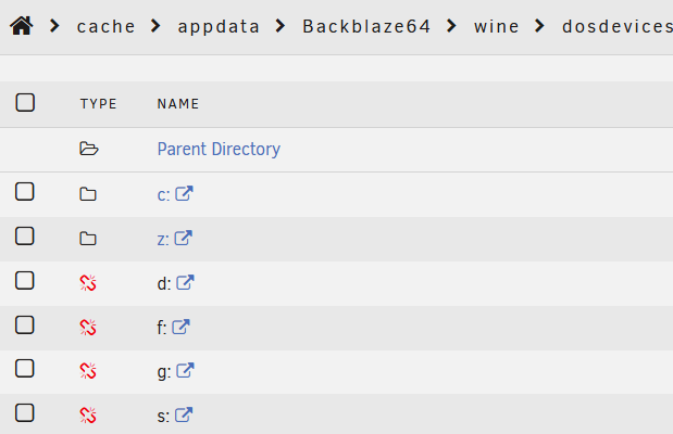

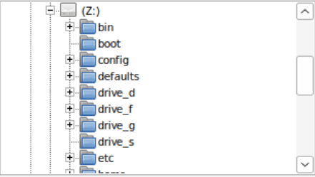

@foz Got a question for you and a tip for others. I removed a drive map from my Docker template because I no longer needed that folder backed up. I ran bb-doctor, and it said I had an unmapped drive that showed as a warning. I couldn't see this drive because I removed it from the template. However, I looked into the AppData folder structure and found where drives are mapped and simply deleted that old one from the list, and the warning cleared. It was found here
That's the tip for everyone. My question is: I never mapped the Z: drive, and I don't remember when I first noticed it. It is not a folder I'm backing up, but when you look in it, you see the container file structure. Is it safe to delete this folder from the \dosdevices\ folder, or is it supposed to be there?
The folder shows root as owner
You're almost at the point the wine web GUI will be obsolete and everything can be done on the Web pages. I truly thought there was nothing else you could think of and every update it's fun to see what's changed. The push update comes in that an update was installed and it's like Christmas opening to see 🤣
Edit: reading your changes answered my question about the Z: mapping, thank you!
I'm curious if others have had that issue of removing or changing mapped drives and they are removed from the container settings but the symlinks still exist in the app data folder, can that be fixed by running bb-doctor --fix and it safely remove those non used links?
