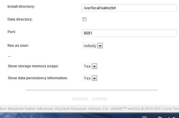

Thank you for continuing your valuable support for these wonderful plugins.  I and many others really appreciate it!
I just downloaded and installed the SAB plugin, and used the data directory "/mnt/cache/plugins/sabnzbd".  I originally rebooted without the plugin set to load on startup, then moved it to the plugins folder, and installed it manually.  Worked perfect.
I rebooted, and it started and is running fine.  Nice work.
It started the setup wizard, since my old settings were on a share on the array.  i tried copying the old plugins/sab folder to the new location on the cache, but it says i need permission to do anything to any of the files on the cache drive, so it seems I'll have to set it all up again from scratch.  Not a huge deal, since everything else is working great!
Thanks again.
You can chmod the directories on the user share and the cache drive. You should then be able to move them.
Afterwards make sure to change the owner using chown.
Sent from my HTC Vivid

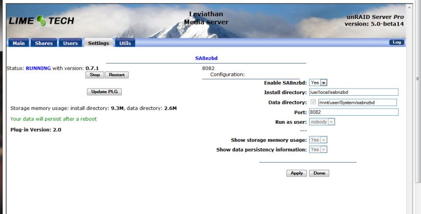

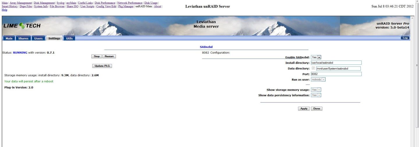

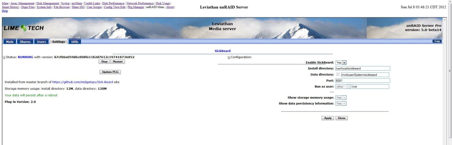

I just took a look at SickBeard this morning, and it was showing me a bunch of errors.  i un-enabled it, then re-enabled it, and it's not giving me any errors any more, but it's not showing any of my TV shows either, it's blank :(
How might I get my data back?
It seems it was fine, then it just wasn't, for whatever reason...

I'm having an issue with interface. I use SimpleFeatures. The issue is clearly visible on screenshot attached. I have the same problem on any browser. It was also present on any other W-W/Influencer plugins. It is OK in full screen, but in windowed mode the buttons are hidden behind that small info bar. Can you please ass slightly bigger bottom margin to the config page? I simply added two more linebreaks after the form and it looks OK now, but this is not a proper way of doing it.
Does anybody else have this problem or is it just me?
EDIT: One more thing - I installed the plugin, then went to settings page, changed paths and clicked [Apply] with [Enable SABnzbd] set to "No" the settings have not been saved to config file. Looks like "sabnzbd_change_settings()" doesn't do it's job in this situation.
EDIT2: It seems to be the problem only after installing the plugin. When I changed settings and enabled it (completed installation) it saves configuration properly. That is why it probably went unnoticed.
Last thing - there is leftover print "$sab_port", which is visible in the second screenshot.

Upthetoon, can you please update to the latest plug-in version, I checked this morning and port appears to be working fine, if it still doesn't after you upgrade we'll look into it further.
Riot504, can you post a screenshot showing how it looks? I removed the dependency from simplefeatures a couple days ago.

p4xel, I'll adjust the margins. Haven't tried windowed mode so never saw that problem.
The issue with settings not changing without enabling is being worked on now. Its fixed for couchpotato in the dev branch, just have some more testing to do before adding it to the rest and pushing to the master branch.
The leftover $sab_port really is just a leftover, :P I forgot to remove it, I was using it to verify changes I made. But that should verify for you that if https is enabled it detects the https port, so no more false "not running" when https is enabled now, :P. Will remove it, thanks for noticing!
EDIT: Margins should be fixed now. Leftover $sab_port is gone. Will run a few more tests past the changes to CP in dev and if it all turns out good I'll make the changes to the rest.
here you go :)
This is in FF13 maximized
Unraid 5b14
Thanks!
Wow, ok, I'll have to remove SF and see if I can find a happy middle ground here. I removed the dependencies on SF's images, but apparently there is more behind the scenes formatting than I initially thought
