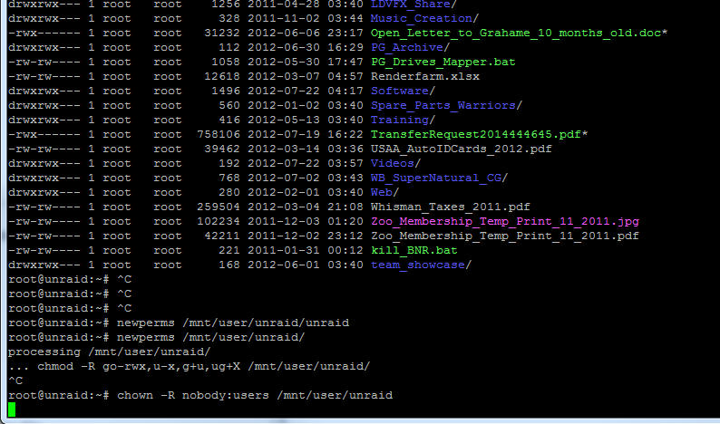

forgive my ignorance on the attached screenshot: but how do I know when the chown process is complete? Will I see a new line below the green cursor of: root@unraid:~#  ?
I invoked the chmod in a putty telnet session about 10 minutes ago....see attached.

As I recall, you will get the Linux prompt back again.
Btw, the '^C' on the screen, is the symbol for a Control-C which is the kill command for the currently running process.  I show that while the newprem script was running.  That would have kill that process and prevent it from finishing.  Allow the chown to run with interupting it!  Then we will see where we are...
You can always press enter, that won't hurt anything.  It should return a new line when it's done.  Running chown is changing the ownership of all files and folders in the directory specified.  It does this one file at a time.  The more files you have, the longer it will take.
Once it is done all files and folders should be owned by nobody.

from a telnet putty session, I see:
processing /mnt/user/unraid/
... chmod -R go-rwx,u-x,g+u,ug+X /mnt/user/unraid/
Does it complete? It may take a while.

It's still going, I guess. I still see the green cursor below the chmod line. I'll just let it cook for a couple hours maybe and then reboot the array as well as reboot my win7 machine.
ahh - ok! Good to know that. I highlighted the text and did the ctrl+c for the forum, not knowing that would kill any processes.
The chmod is going and I aint gonna touch the telnet putty till I see a new line! :)
EDIT: I meant chown not chmod...
